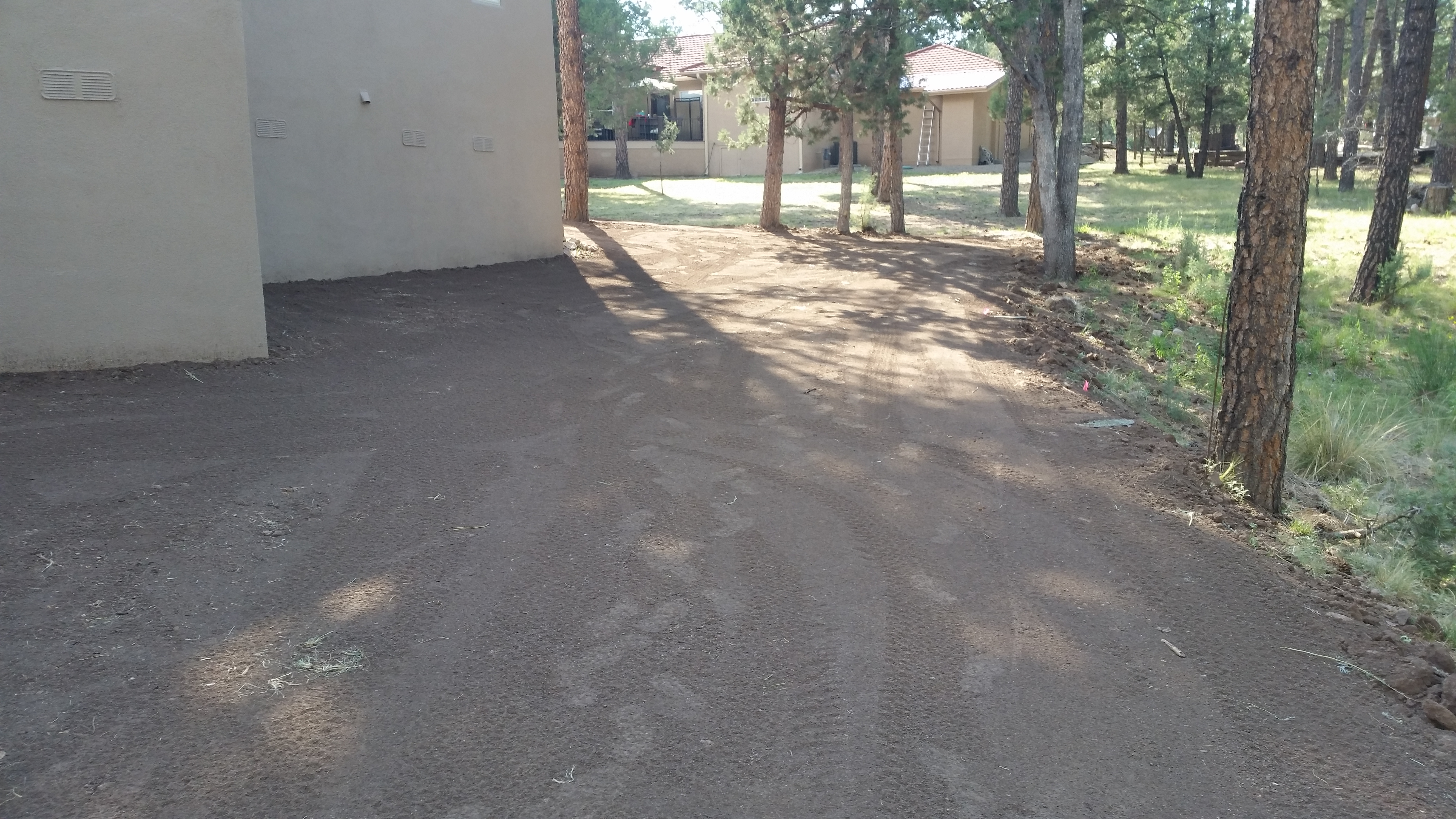

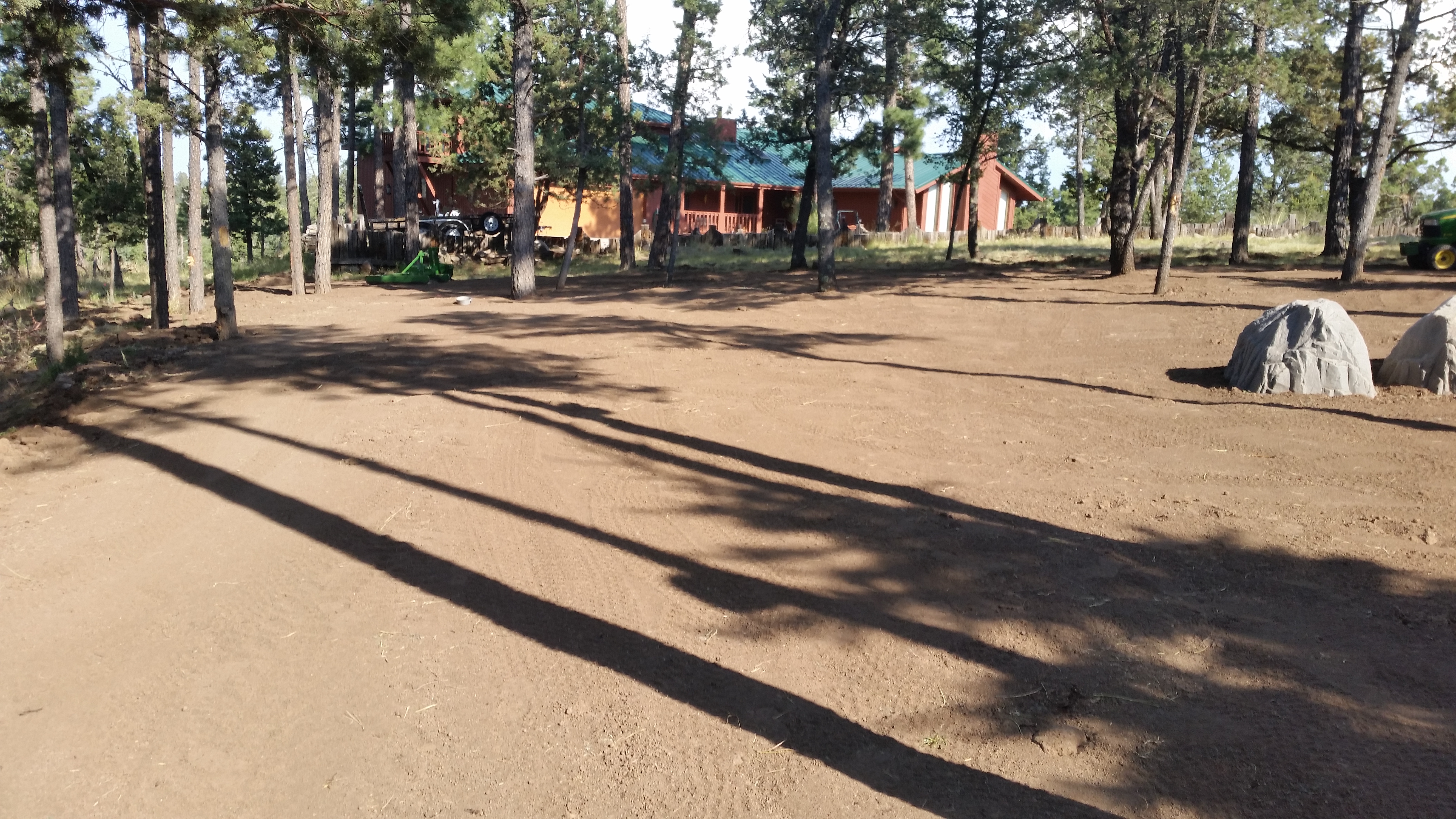

Here are some pictures of a lawn I had to plant in late June (27th) which is the worst time to plant in my local. Plenty of hot sun made for less than ideal conditions but we have to have a nice lawn by middle of September for a customer's party event. This lawn has about 9500 ft of drip irrigation I installed about 4 inches below the surface prior to planting. We have had to hand water with a hose until there are enough grass roots to switch over to the drip system. It has been about 25 days since planting in the picture. In another month it should look great long before the customers event.
