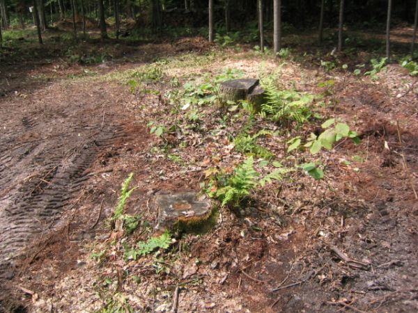

I've got about 12 good size stumps after "thinning" out trees next to my camp. I know hiring an excavator would do the job but it would also be costly and probably would damage the trees I want to keep.
My B7500 with BH can manage the small ones but I'd be forever on the big stumps.
Any ideas?
-Terry

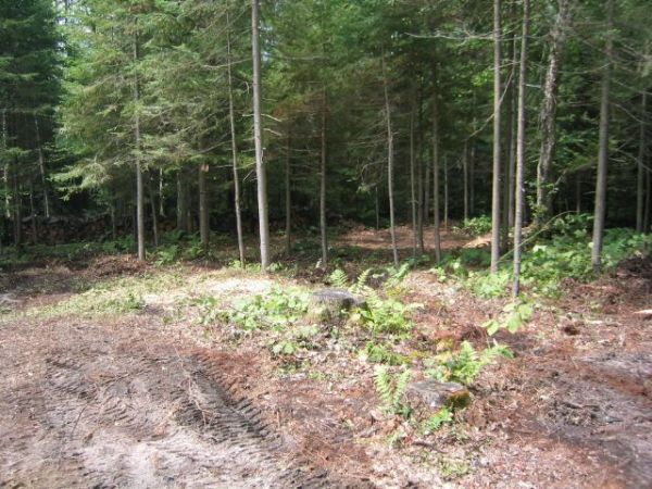

Close up..

You could rent a stump grinder. They can grind a stump well below ground level, so you don't have to worry about them again, and there won't be any hole to fill in either. Just a thought.

Maybe rent an industrial backhoe for weekend & have some fun?
Get a backhoe in there, dig em up, push stumps over to the side (or a burning pit??), put dirt back, then hop on your CUT & boxblade & make it all pretty as a picture!

depends how fast u want them out? like otheres have said u can rent something to remove them , but there are products out there that will kill them and allow u to burn them in place . takes awhile , but if u ain't in a hurry they work.ain't as much fun as a big BH but is a bit less expensive.

I'd burn them if I wasn't going to build anything on their location. If you plan to put in a road or building, then dig and refill with clean dirt. Not branches in the fill. If possible, add lots of water to your fill as it's going in to aid in compaction.

Sometimes you can find someone with a stump grinder that will do it pretty cheap. Doesn't leave a big mess either.

I don't know how the State of NY feels about this, but here in TN we burn them. Get about a pound of saltpeter (Sodium nitrate), per stump, drill a 1" hole down through the center of the stump about a feet deep. Drill two more holes from opposite sides on a diagonal so they intercept the first hole. Fill them with the saltpeter, and either water it in or wait about a week after a rain. Fill the holes with diesel fuel, and light 'em. Don't do this under electric power lines, you'll cause a relay. /forums/images/graemlins/shocked.gif Potassium nitrate will work just about as well. /forums/images/graemlins/cool.gif

Rent a Vermeer Stump Cutter the best one in the industry. Vermeer MFG

Im in the same boat and was initially thinking about renting s small excavater. However, I have a few more than 12 stumps (almost 3x that number) and Im sure I couldnt get them all out in a w/e. Around here a small excavater goes for about $200/day. Thats alot of money to shell out for getting rid of stumps. I saw a couple mentions abotu grinders but I have no experience w/ them. How quickly can them grind off a stump? jimg
