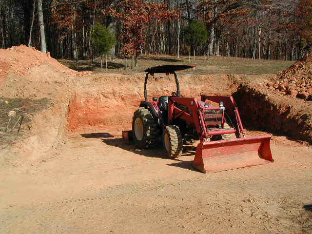

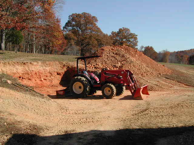

It took me about 8 hours (this included time setting posts and stringing to check level and depth as I didn't have a laser) to get mine cleared out with my little 1710 (with diamond tread rear tires) and a box blade using the scarifiers. I added a little weight to the box blade and it worked great going through hard dry clay that had not been touched for at least 25 years - it looked like forever. I would get the box full every time so I had plenty of digging capability.
It was a 40 x 60' building with one side dug into the dirt about 2' and the other just enough for the 6" slab plus three inches for rock and underlayment. The concrete guy then came in with a miniexcavator with an 8" bucket and dug the footers and vertical support column holes. He dug and laid the rock, underlayment, and reinforcement one day and they poured the next morning. Very quick and simple.
I would never use the loader for digging like that - too much strain on the loader and you don't get as level of base. I ended up with a nice flat base that was level to about an inch of dirt that was undisturbed. It made for a very solid floor that I has not cracked or shifted at all in the two years it has been in place and I have set some very heavy loads on it - upwards of 1000 psf in places.
I was getting quotes like $2500-3000 to do this work and so I bought the box blade and had some fun - much less costly and I learned a lot. It was my first time doing anything like this.
