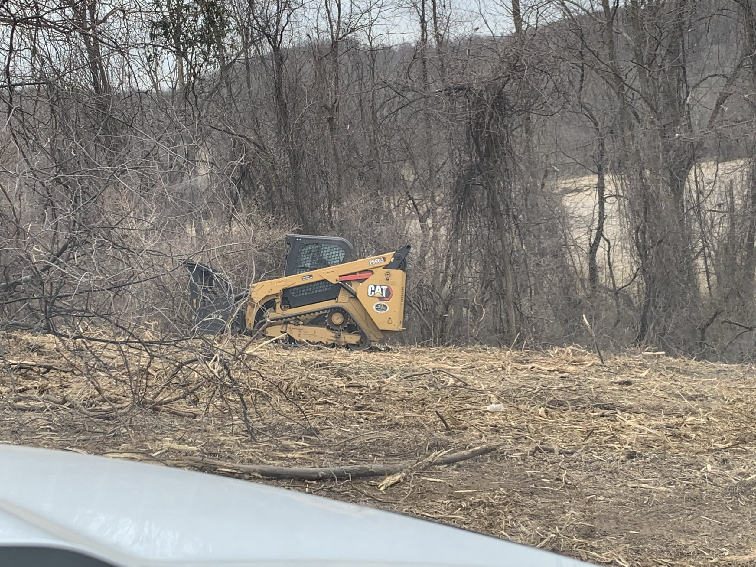

Rent/hire a tracked skid steer and mulcher.
8 acres could be shredded into bits in 1/2-1 day.

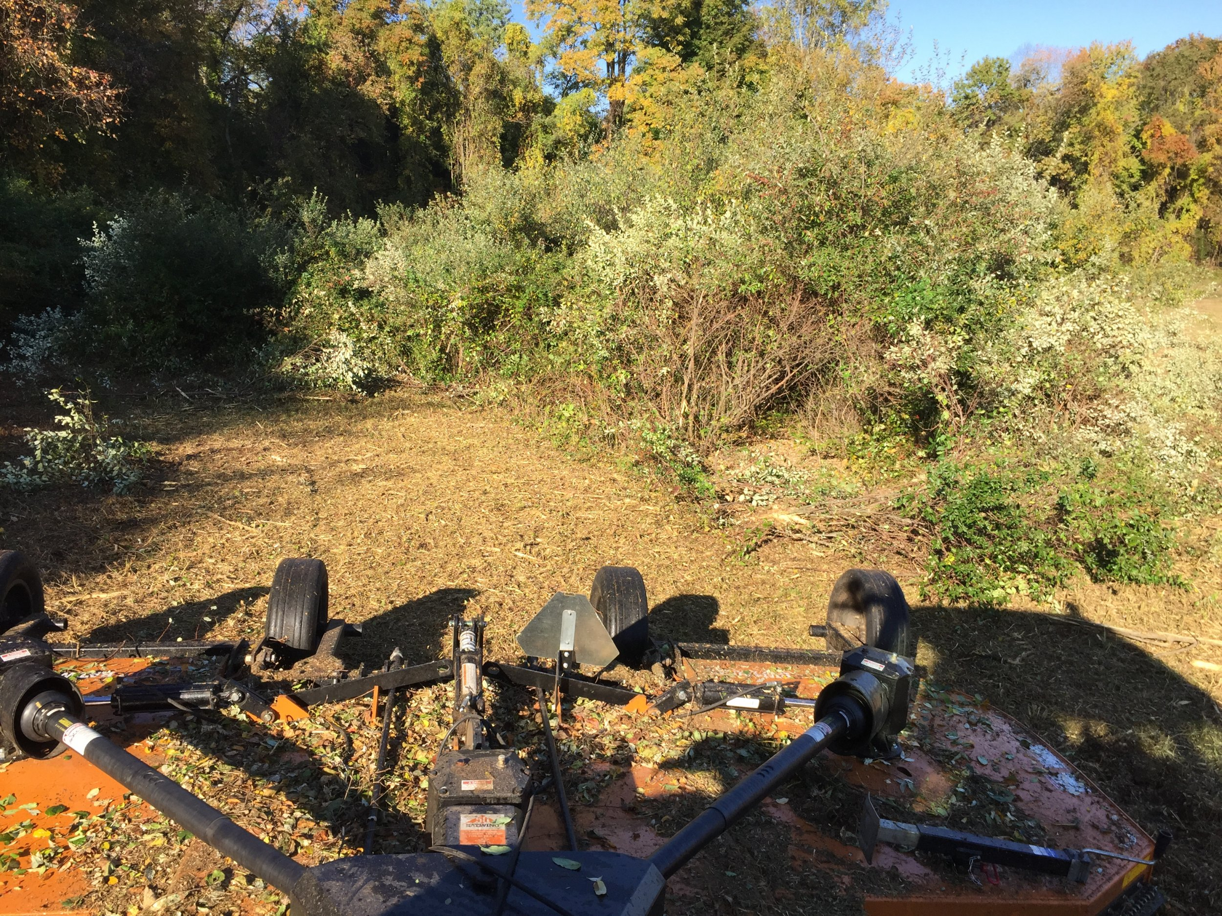

Just bush hog what you can. Pull up the thorn trees and bigger gums. Forget about the one inch limitation. My motto is if the front of tractor will ride it over, the back should be able to chop it up. Put in double low and go. Been doing that since 12 or 13, I'm 52 now. Still have the same tractor and same bush hog. Ain't tore up nothing. Cut a few lanes through it and then just half a width each time, much easier.

I think that is how I would do it but i would back off any tree bigger than your forearm. Just cut the big ones and push in a pile and burn them.
This is exactly what a local friend said to me regarding the way he uses his bushhog. What is confusing to me is... there ARE different sizes and capabilities of bushhogs. And, secondly, mine sure makes one hechuva racked when I mow over a downed sapling of any size! It's concerning, I sure don't want to tear it up, lol.

Why would he need that when the mulcher can push them over and turn them to sawdust? Probably up to 8” diameter. He said it was new growth-like 5 years old. Should be no problem for a mulcher.

Well, the answer is that if my tractor and bushhog will do it, I don't have to pay to rent a mulcher and operator! Plus, I control exactly which trees get whacked. I actually do want to save a few elms, oaks. There is no doubt a mulcher would do this easily, but there is the cost.
I’ve done that for many a customer. You can back over the thorny saplings and try hacking them up, but as you said earlier, the thorns will still be there. A mulcher will pulverize them into little harmless chips.
