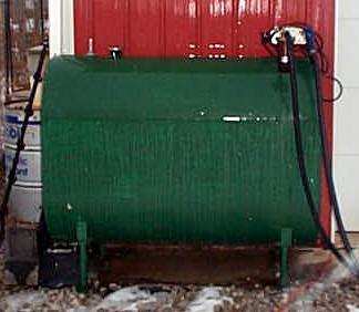

I'd be using Lucas or Power service, not Stabil in diesel. Diesel really dosen't go "stale" anyway, like gasoline. I have 2- 275 gallon bulk tanks that I fill yearly and never had a problem.
Remember, the fuel you buy at the pump has been sitiing around for a while anyway. I had a rather lengthy discorse about diesel about 2 weeks ago in a similar thread.
