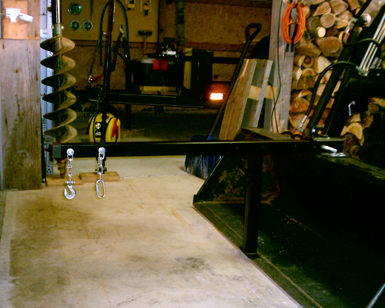

Everything. I can not get by without the 3 I have on my bucket. I also put a Reese style hitch on the bucket which is extremely handy. I even made a boom pole to go in it.
