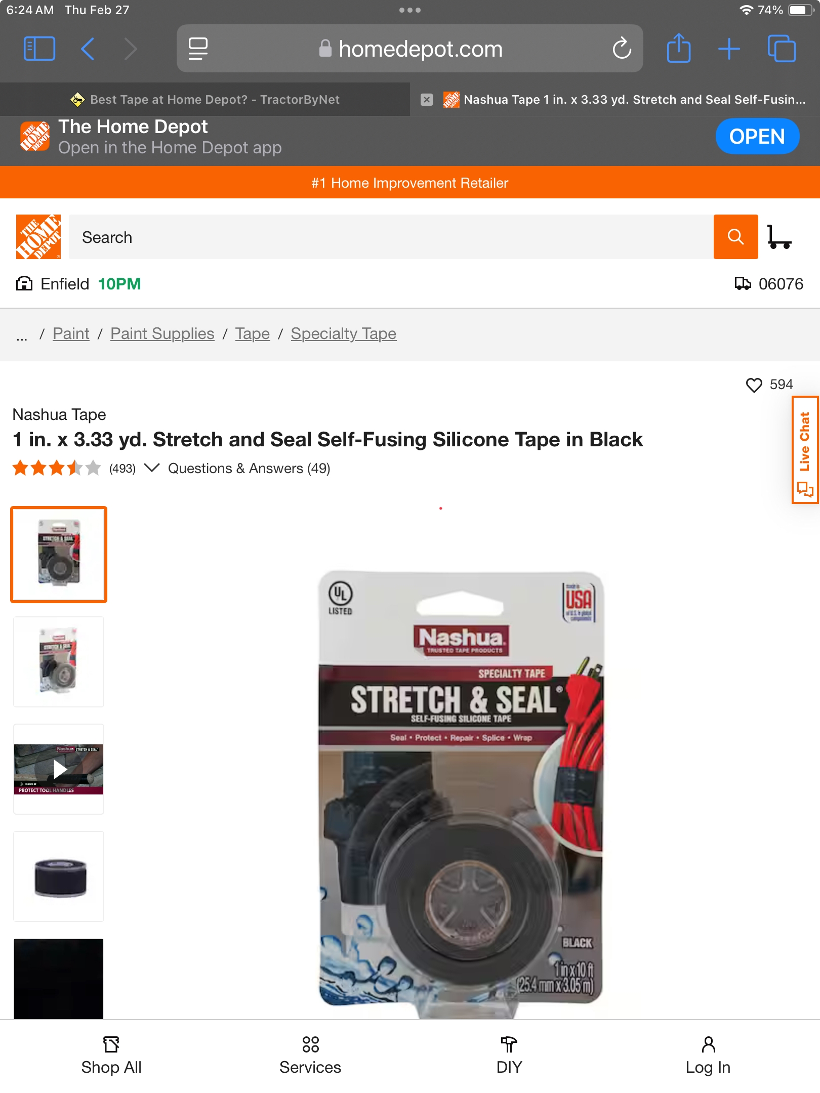

I’ve had good luck with silicon tape. In the plumbing section at HD and other places

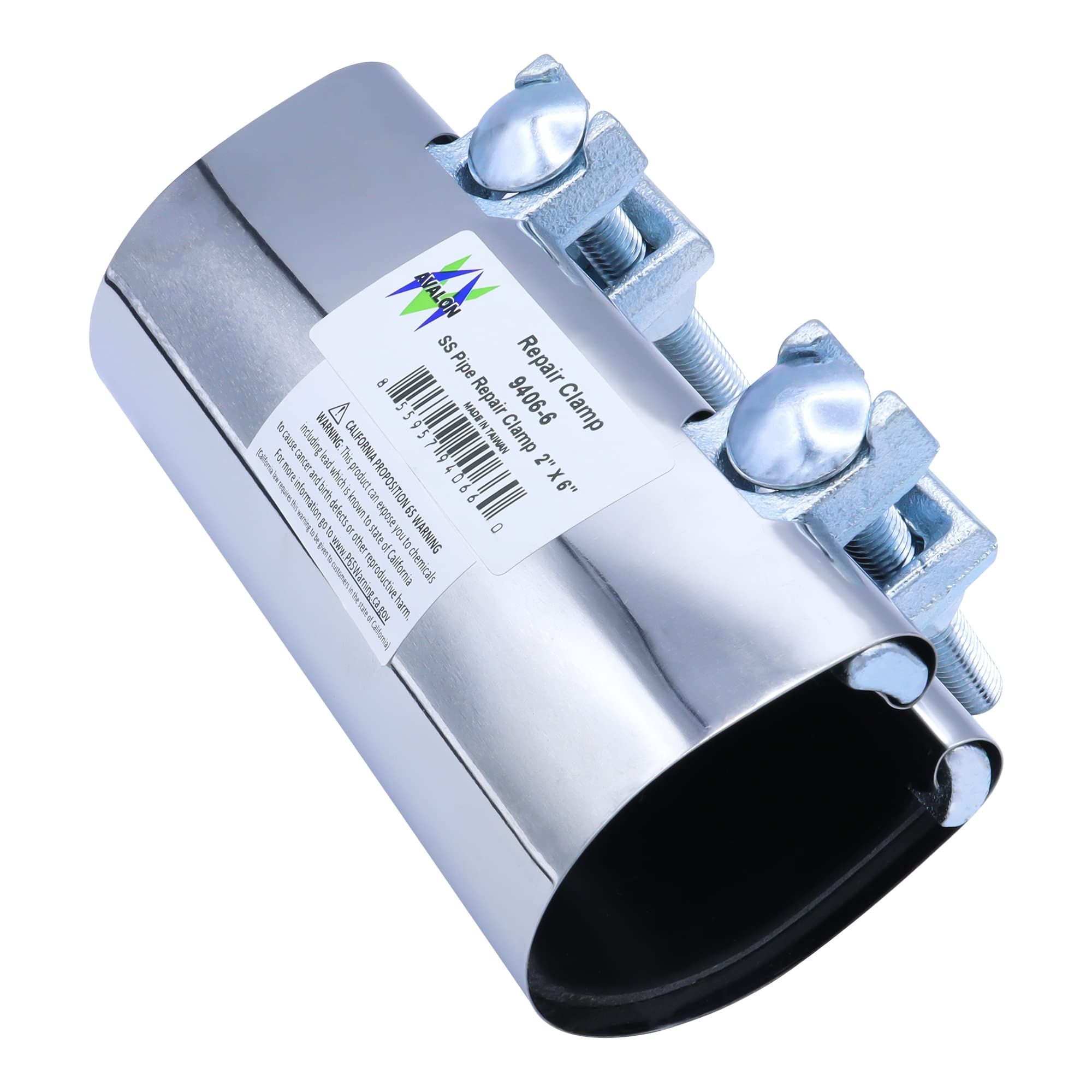

Go get a pipe repair clamp, you may never have to “repair” it again.

A saddle coupling works great in this situation.
