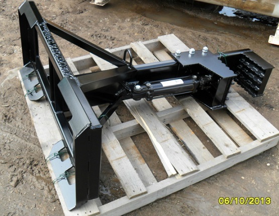

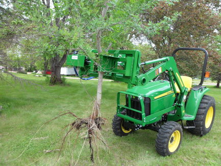

Here is a different style that can fit SSQA and 3 point: Buckthorn Puller - Custom built Skid Steer attachments to fit almost any need you may have.
The Long Arm is the one I have:
