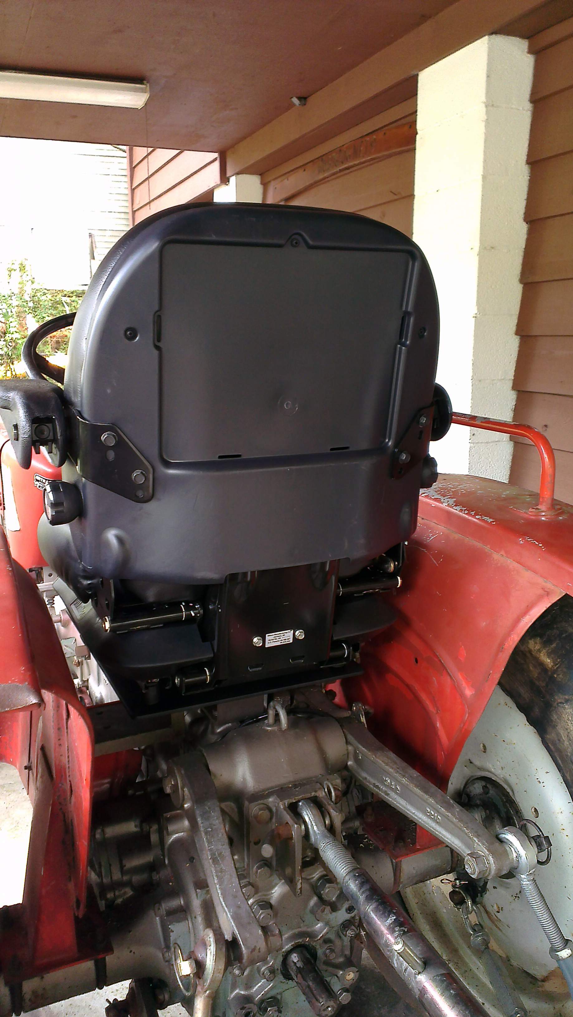

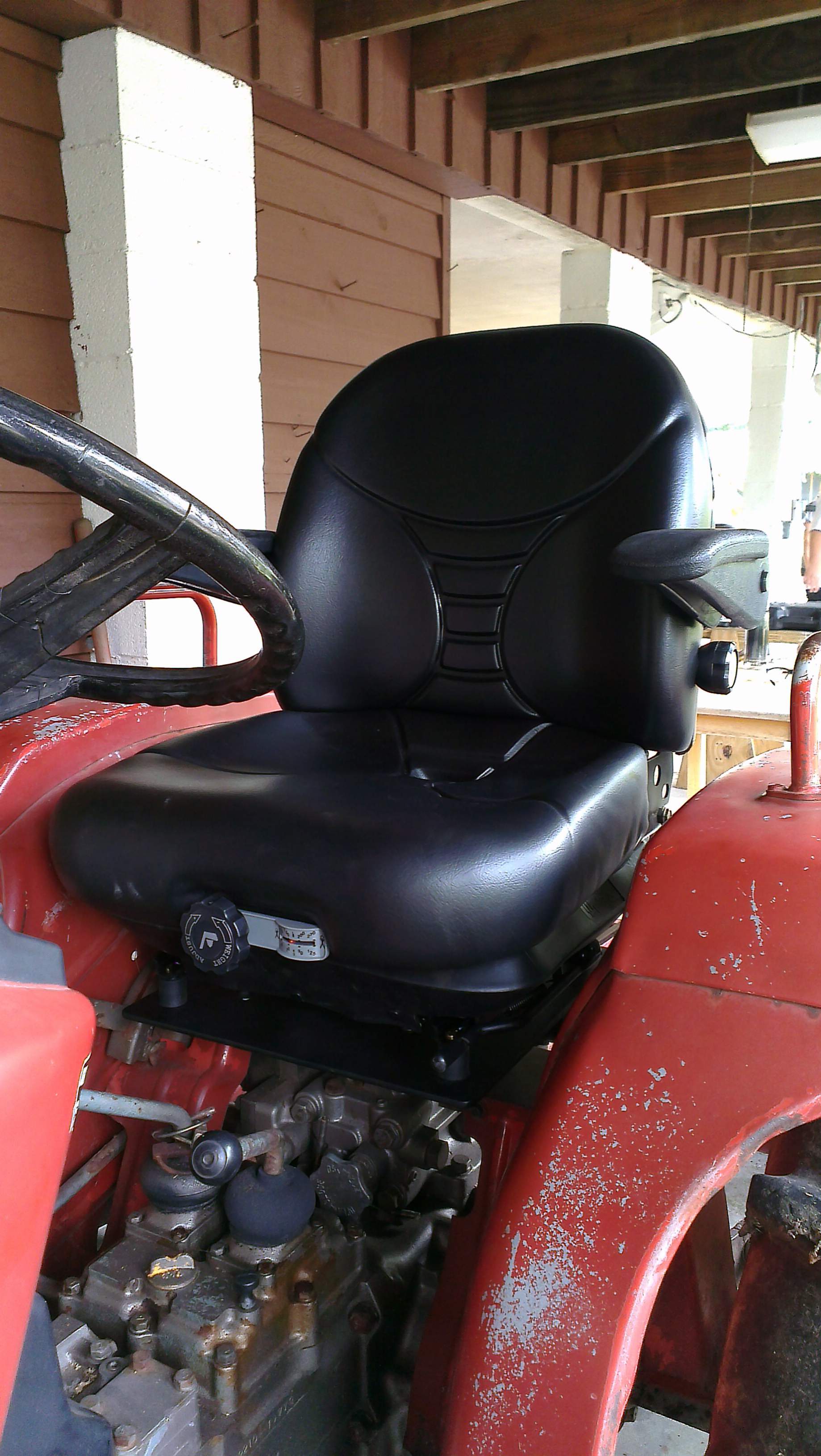

Went ahead and decided on the Michigan Suspension seat in the link above.
I started with a piece of scrap ply to create a template so that I could try a couple of different ways of mounting it. After I figured out the best way of mounting I got a piece of 1/4" steel plate. Ground down the edges/corners, drilled, and painted it. Also installed a set of vibration isolators.
So far the seat has been a major improvement over the POS snapper lawnmower seat that use to be on there.
See pics below:

Now that looks comfy! Sure beats what I've been sitting on.
