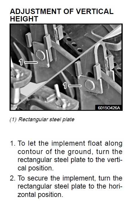

Any mower will hit the ground (some more than others) unless you are mowing high. I don't believe the King Kutter flex system above would make much difference on any tractor I've ever operated. With engine running,no empliment on tractor and 3 point lift mid way between up and down,either lift arm can be picked up more than 6 inches by hand. I fail to see how 1.5 inches on flex system would be an improvement. Every cutter I've used has a lingth of chain on bar running from 3rd link to rear of deck that has same effect as flex system. Spraying to kill weeds will kill not 2 but 3 :dove::dove::dove: with one stone. #1 Field look's better sans weeds #2 Intervels between mowing are extended #3 You will be able to better see humps and holes in time to make correction.
   / Best rotary cutters for uneven terrain #16
With most modern tractors, the 3pt lift arms can be raised, but, they are not independent from each other. Also, the best part of the Flex system is not what is happening with the top link, it is the Flex between the 3pt lift arms and the deck. I had 1800 trees removed and not all stumps are below grade. Some stick up a few inches....not high enough to hit with the blade, but the deck corners hit them. The Flex is much better than a rigid mounted deck when you hit a stump.
PS...also, when you hit a stump, it doesn't just move upwards, it moves back/up on the radius of those dog bone links.
