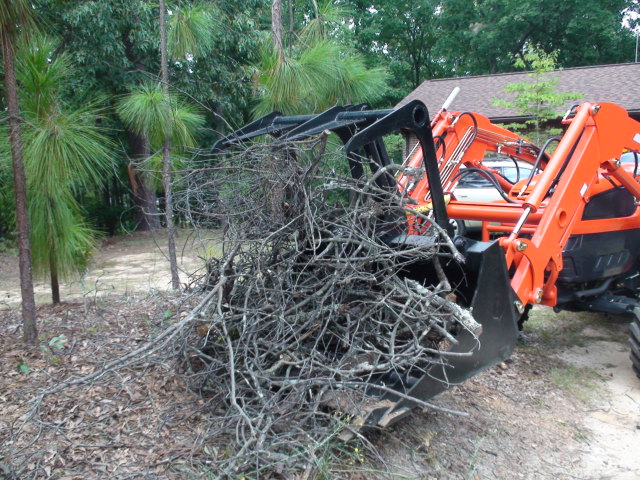

Hey folks,
Wife and I are building a house on 12 acres in the Texas Hill Country north of San Antonio. Looking for a sanity check on tractor size and a bit of help with a grapple selection. I plan on keeping this house until they carry me out. The tractor stays until the estate sale. :)

The biggest implement question I have is what type of grapple to get. While there are a lot of threads on grapples, most that I found focus more on logs, roots, and underbrush than rocks. While I will certainly want the grapple to do that type of work, I also want it to be easy to use and efficient in picking up and moving surface rocks. There are lots of visible rocks I want to move between 500 and 1500 lbs, then literally thousands that are 3" to 24" scattered around. I want to be able to pick up and precisely place the larger rocks. I want to be able to rake then gather up the smaller rocks. As far as sizing the grapple, a 1500 lb rock might have dimensions something like 5' x 2' x 1', so a 48" grapple is plenty wide as long as it is strong enough and can open up enough. Any guidance from someone who has done this type of work with a CUT and grapple would be greatly appreciated!
Thanks,

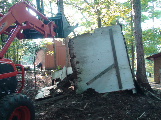

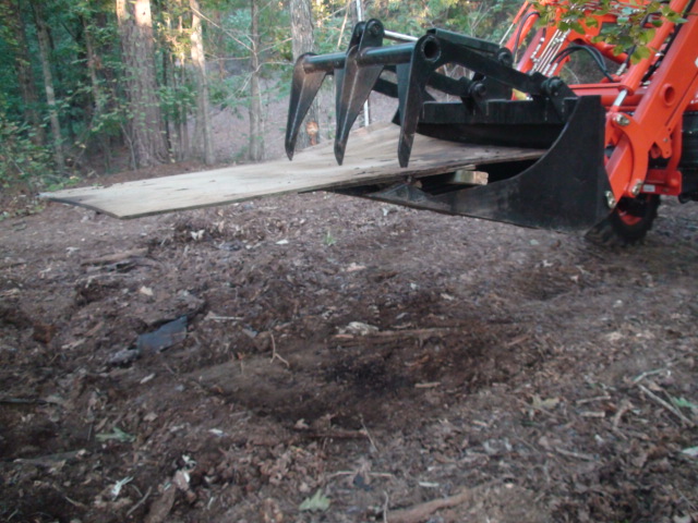

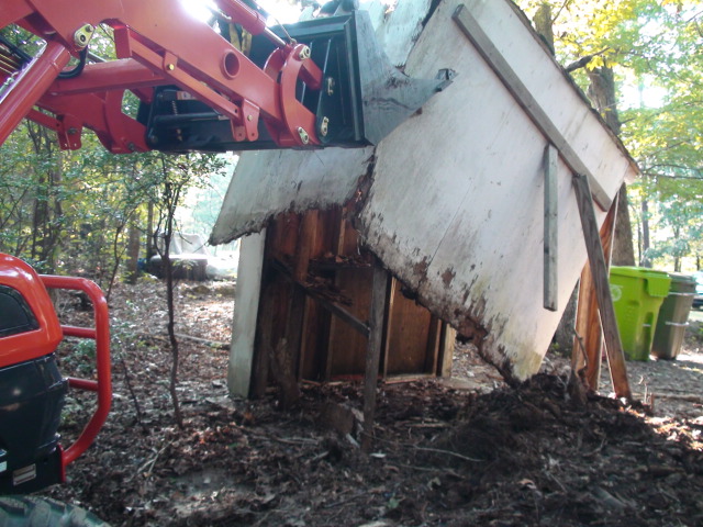

Hi HillCountry. I have similar rocks on my 4 acres of densely wooded, rocky land that I will start clearing next month. I thought about the rock issue long and hard and settled on a 48" unit. My plan is to pick up the larger rocks individually and move elsewhere. Then go back with the grapple open and just slide the bucket teeth slightly under ground and get the smaller ones. Once this is done, I will use the rollover box blade's shanks to dig up the subsurface rocks and then go back for another pass with the rock bucket
I have been using the rock grapple around my current home doing exactly as you described, except for no rocks here. I have used the grapple to lift up and destroy an old shed also, along with using it as a carryall for limb pickups, etc. I find it the handiest tool in my arsenal.
I selected 48" vs. larger to keep the weight down as 48" will grab anything a larger unit will and can lift more due to its lighter weight. The only thing a 72" would increase would be the volume you can stash in there. But for me that is not an issue. I just pile/load limbs and brush in the grapple, so far up to about 8' wide and carry it away. I have no need nor desire for a wider unit, especially with the reduced maneuverability around all of my trees.
Actually, I have no idea why folks purchase the root grapples as I think they appear to be less useful than a rock grapple that can also dig, which I have done to get at roots underground.
Here is the one I selected and am impressed with its price and construction. It came with 1/2" ISO 16028 skid steer couplings, which I dearly love as they do not leak when disconnected as the typical ag coupling do.

Thanks sdef. Great feedback and info. I like your plan for the rocks. I think I can follow a similar approach in many areas, but we also have a lot of large oaks where I'll have to be careful around roots so the boxblade use will be limited. I've considered the smaller grapple size and think that is good advice since it offers more precision without really limiting the ability to accomplish most tasks. Based on your recommendation I added Wildkat to my list of grapples to check out. I saw a few other posts that they might be slightly under-engineered in the top brace, but maybe they have addressed that issue.
Willie B, I laughed when I read your post. You must live in an area with a lot of open space. My dad has a hundred acres and actually has a D8 dozer that he's used extensively to smooth things out and rebuild ponds. That monster is WAY too big for our little 12 acre residential subdivision lot with trees... trees that I actually want to keep without killing the roots and scraping the trunks. I respectfully disagree with your statement that there is no such thing as too big a tractor. For me, I think the sweet spot is the smallest HST tractor I can get with 30+ HP at the PTO, the ability to move a 1500 lb rock, and wheeled tires that won't destroy vegetation or concrete driveway.
