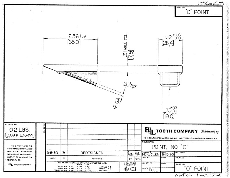

Also Arps/Amerequip sent me the drawing below, said they last used the part 15+ years ago, and said their distributor might still have some:
Cummings & Bricker
100 Lehigh Ave.
Batavia, NY
1-800-252-1552
