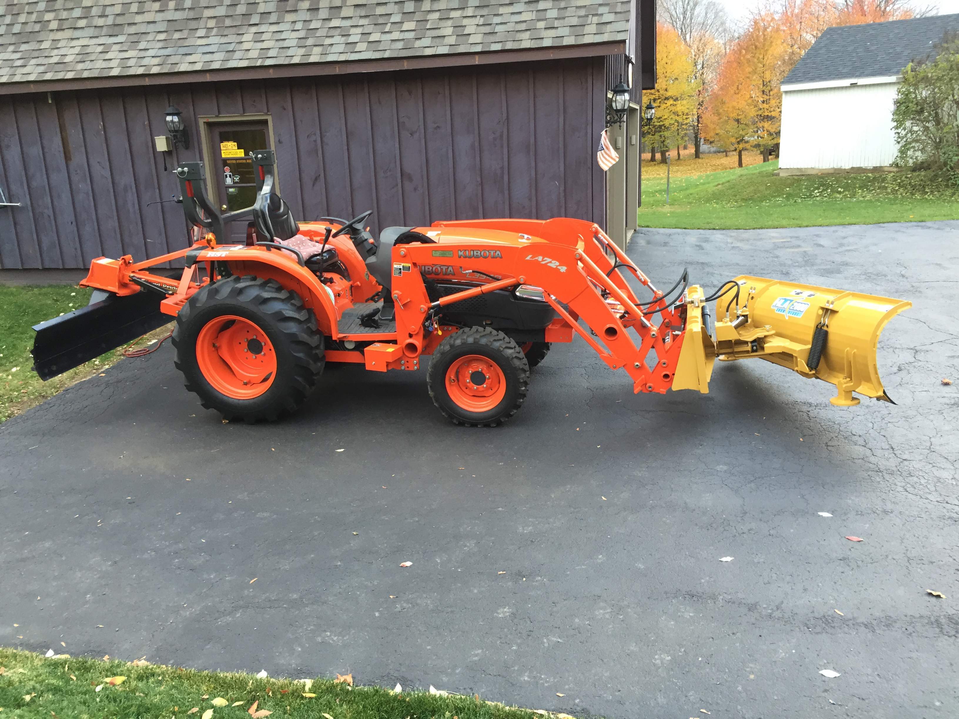

In planning for the purchase of a loader for a Kubots L3540 I would be interested in the opinon of others as to the best available. The Kubota LA724 or the Rhino equivalent are possible. Are there others?

If you are planning to trade down the road;the Kubota loader is the way to go.I had a 723 on a L3130 and it was a good match.
   / Best loader for Kubota L3540 #5
Rhino/Westendorf/etc. make GREAT products. But I think in the "best" category an OEM loader is the way to go though, plus the resale value is probably better.
   / Best loader for Kubota L3540 #6
I have the 724 loader on my 3540, with the ssqa, good heavy duty loader.
