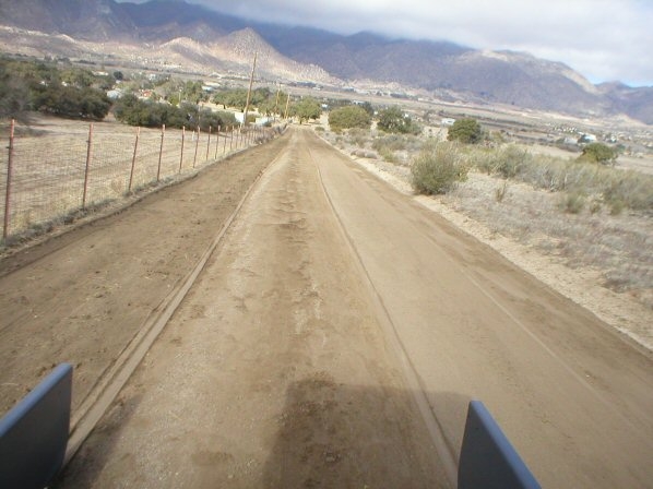

Just my opinion and that of the Goodyear research facility in Texas, the Road Boss is the best simplest unit made. (y)(y)

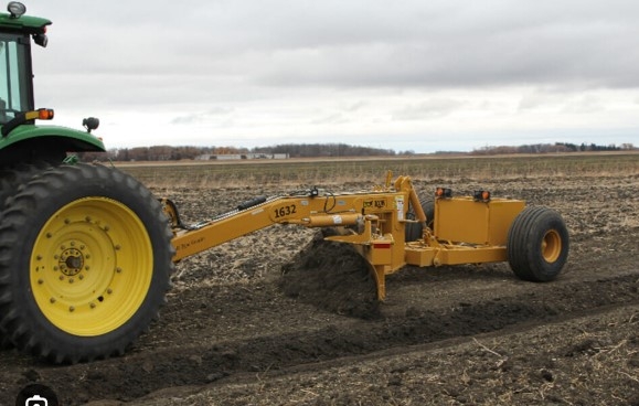

You need to clarify...are you talking about an actual land plane that is towed behind a big tractor, has a grader-type blade and is used to level uneven fields?
Or a driveway scraper like posted above in photos by MtnViewRanch?

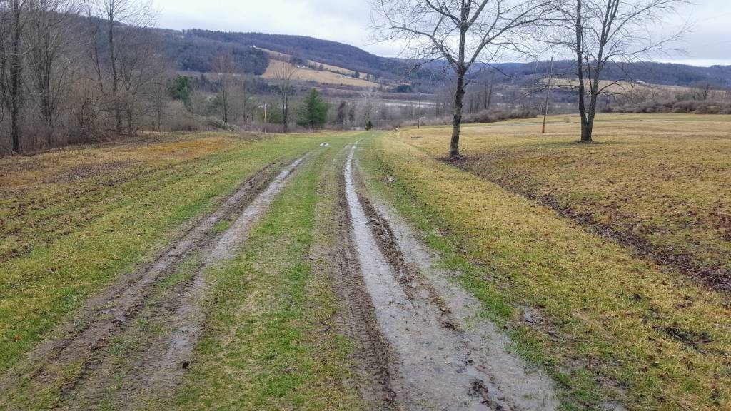

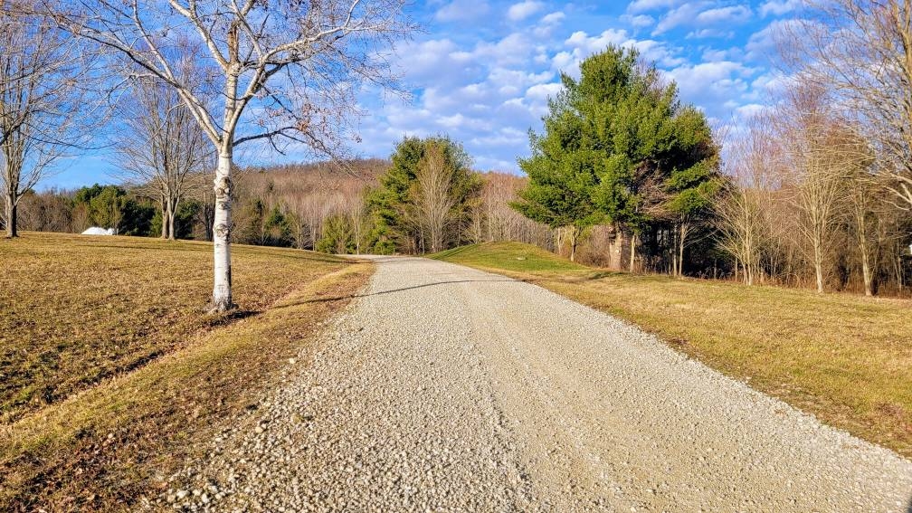

The EA Landplane does a good job. Reportedly, they are not processing payment until the unit ships under their reopening.
Before and after...(removed the top layer of bio, added and spread gravel with the landplane...)
