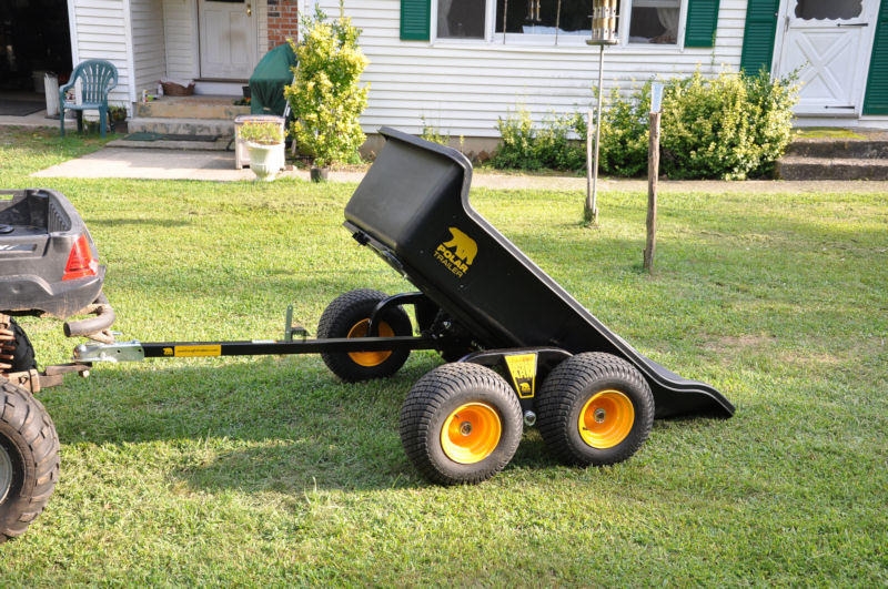

Backhoe and a wagon for rock removal. Polar brand poly wagons from Home Depot and Lowe's web site will take a pounding from rocks OK. PHOTO

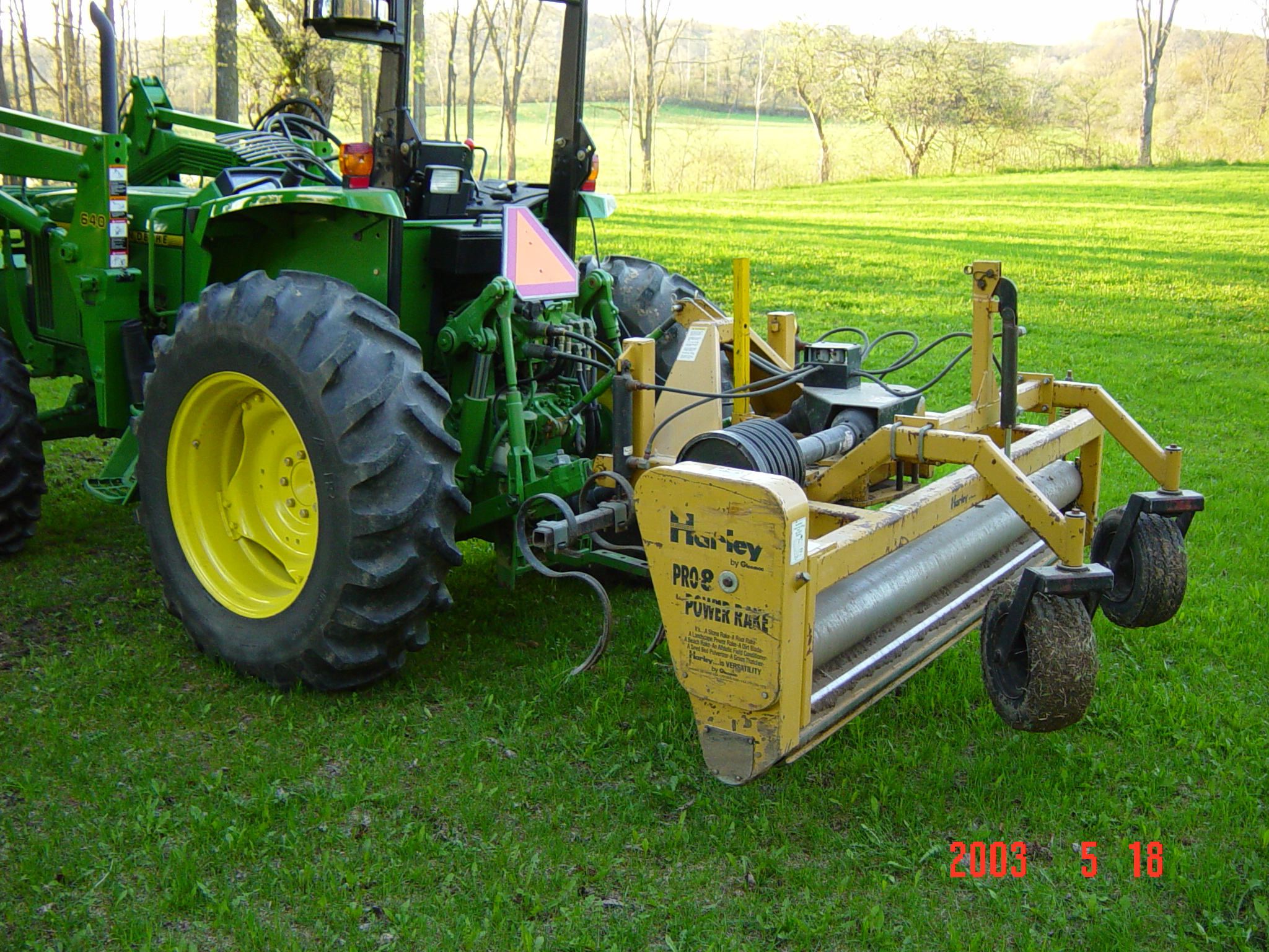

There is one implement that will do all you ask, and do an incredible job at it quickly and efficiently. You are looking for a “power rake” in a 5’ width.
Various companies make them, Woods, Landpride, Harley (many people call them Harley Rakes).
Mine is a Woods, and there isn’t a better implement for the job.
Problem is they are $8k up for a new one. You can buy a used one for around $2500. However many dealerships rent them, try to find one to rent if you can. It’s truly amazing how well they work.

Thanks for the advice everyone. I was afraid that a power rake would be the best solution. I'll look at the various harrows.
Not much available in the way of rentals around here, but it might be worth a drive if we can find one.

My vote is for the Harley rake, but a smaller one. Woods makes similar unit. 3PH and SS versions.
One pass is like a hundred with an unpowered attachment.
