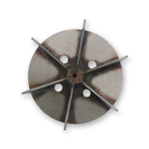

What is the best impeller design for a Billygoat type vacuum that will suck up leaves, cans, bottles, sticks, etc.?
   / Best Impeller Design #2
Air foil type impellers are better for quietly moving large volumes of air and moderate pressurizing of a duct or box. For sucking up garbage a straight heavy blade fan with wider apart vertical blades is better. one with 6 to 8 blades of 3/16" thick or better is needed to deal with sticks. The center of the blades and impelled should have much shorter blades with the outside of the blade being farther away (height) from the blade backing plate. Both should have a bit of a snail exit that separates the first part of the suction form the exit of the fan.

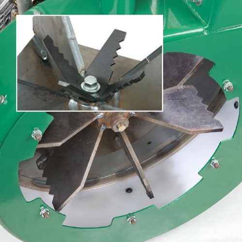

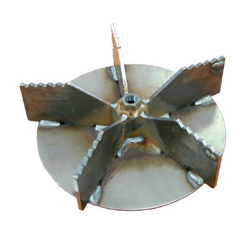

As Spiker covered in his post an impellor that moves debris is different from an impellor that moves air. Angles and shape of the leading edge determine how the blade shreds, along with housing clearance. You can get more shred or an impellor that tends to just pass material through. A lot of material handling fans use a reverse angle impellor to sling material off and reduce wear on the blades. Not sure if it works as well as advertised or not. Another thing that has been tried is flails on the end of the blade or teeth attached to the trailing edge. Most of those designs tend to plug up the impellor.
If you are going to handle the stuff you mentioned in your post I'd go with straight radial pattern for the blades. You will be better off focusing on using heavy wear resistant plate, proper welding, and getting it balanced. Three or four blades should be plenty. You'll want to put a wear liner in the housing too.
Best advice, if you want to build it yourself, is to copy what commercial companies are offering. Read their specs and see how they do it. In the end buying a ready made unit is often cheaper and far easier. Sometimes you can get the fans cheap off of machines where the motor died and then adapt to fit your setup.
