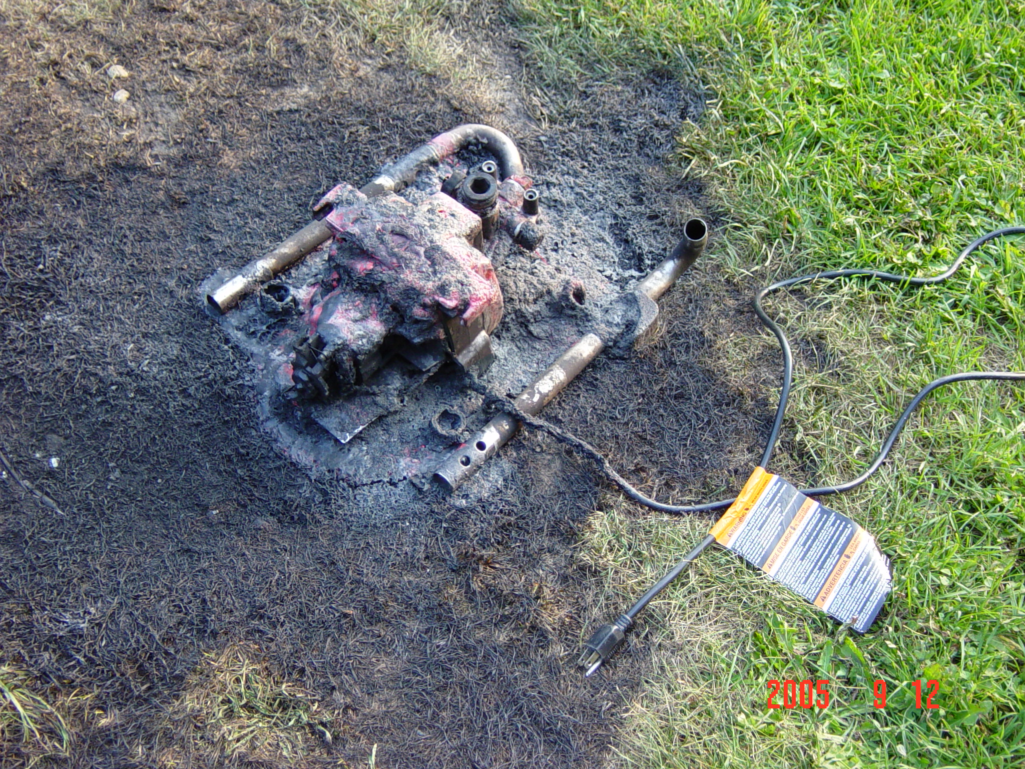

I used to do more paining of equipment, but even then, I never wanted to deal with the issue of trying to clean a hose. I even did try an airless Wagner system once, and had a special fitting machined so that I could use cut-off 2 litre pop bottles instead of the tray. So much, do I dislike cleanup.
I don't remember what happened, but it clearly irritated me enough to result in this. DSC00713.JPG
