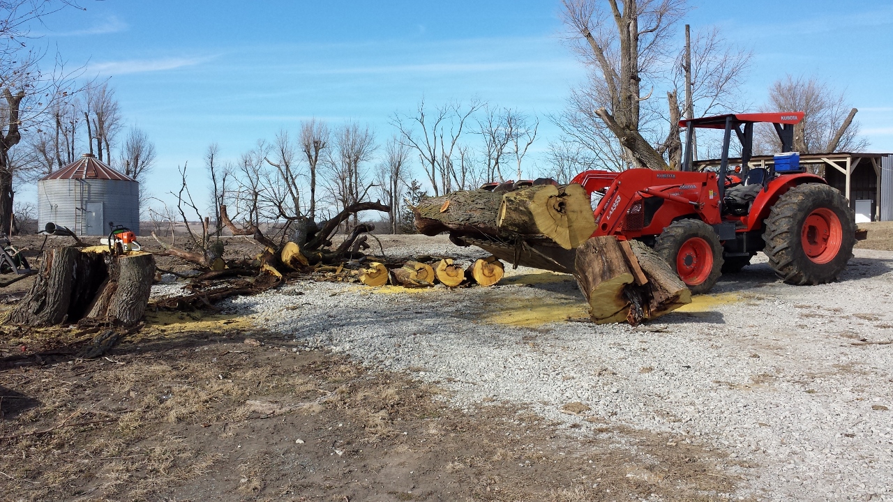

Hi all,
I'm seriously considering adding a grapple, mainly for firewood processing. (Have a B3000 with the LA403/BH77, that I want to convert to an SSQA on the FEL). I will have to add front remotes and (I believe) have the loader valve changed/upgraded).
Meaning, the first thing the grapple's gotta do is hold up the (downed, delivered) tree to be cut. Or, possibly, slab-wood from a sawmill. (And I do have a mechanical thumb on the backhoe, but I'm not too keen on leaving the backhoe on all the time, for stability reasons, weight, etc...).
The second thing the grapple needs to do is PICK UP SPLIT WOOD, to be dumped into a one-half of an Intermediate Bulk Container (a 4' x 4' x 2'H steel-caged, nylon "box," that is built to be picked up with pallet forks. (Basically, 1/2 of a 300 gallon water tank typically used on construction sites).
Any pics of grapples full of wood-stove-length "splits" in its maw would be greatly appreciated, along with opinions, preferences, suggestions, etc....
I will probably use the ATI SSQA and, given that that the LA403 cannot lift as much as some of it's larger "cousins," grapple weight + SSQA weight is a concern, so any info on how much wood can be lifted, at one "bite," (with the LA403 + ATI SSQA) would be greatly appreciated!

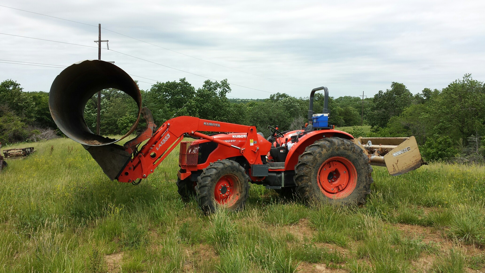

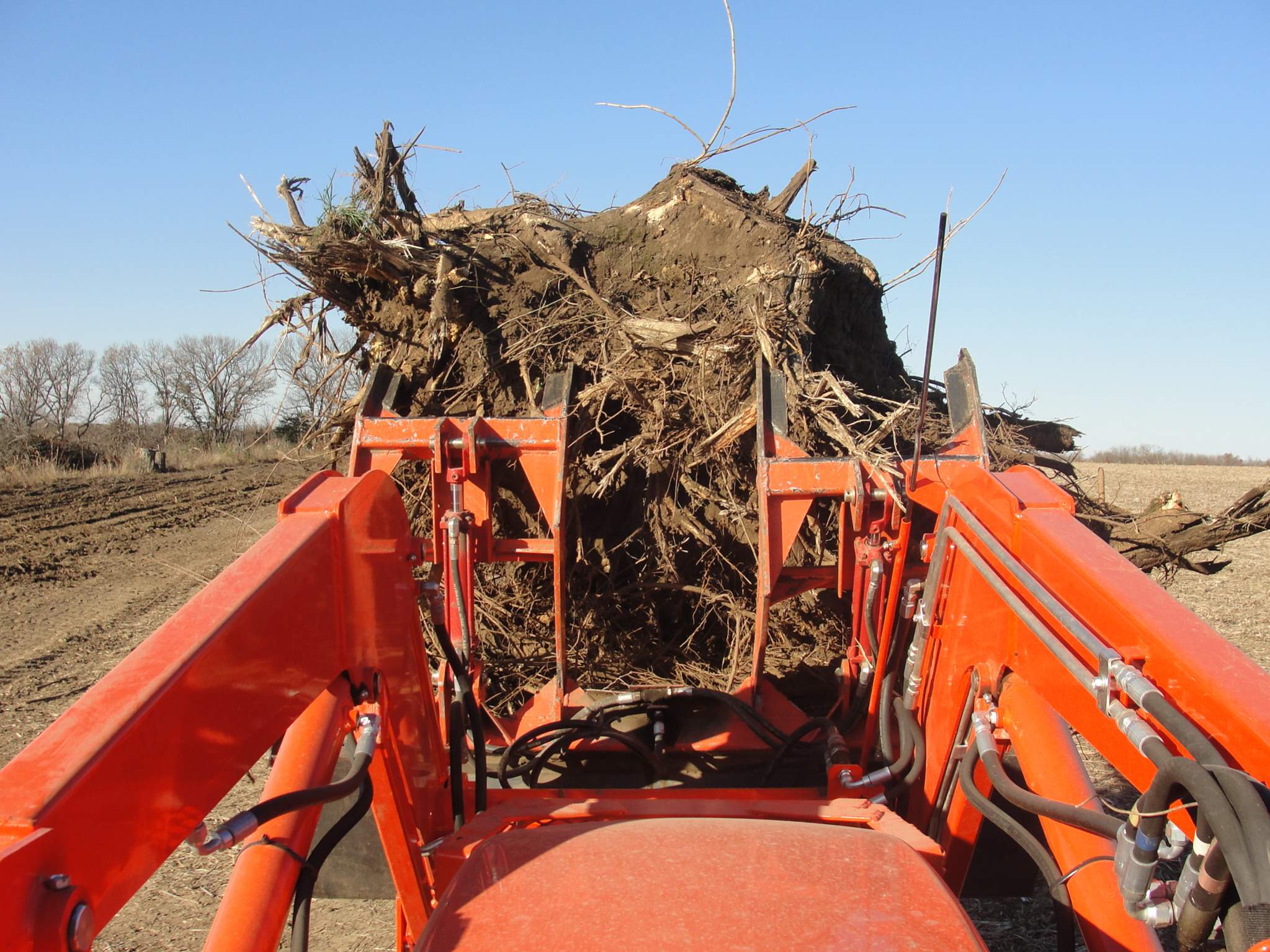

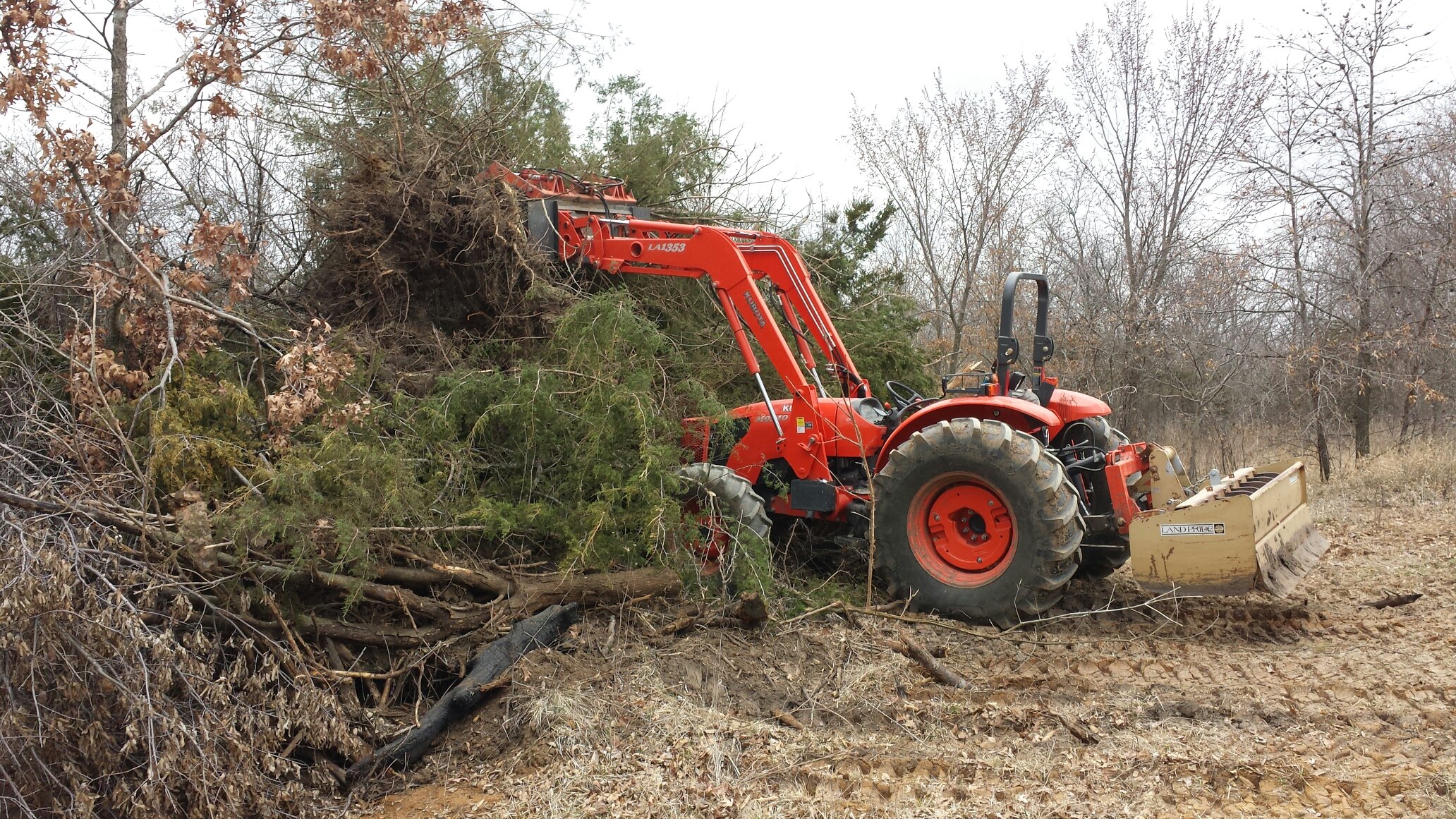

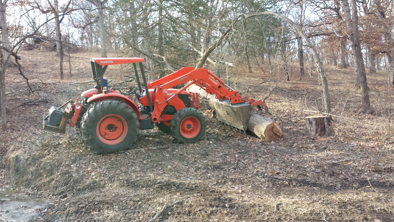

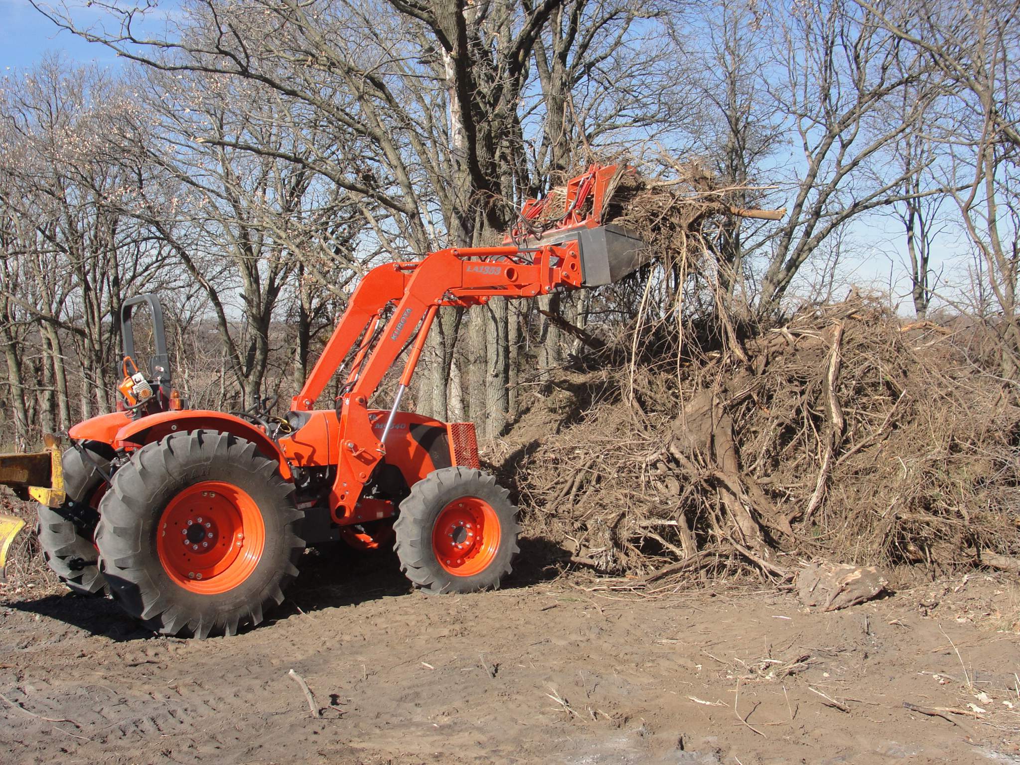

I bought a used Bobcat bucket and built a Grapple for it.
I prefer a double claw Grapple so it better grabs odd shaped loads. Loose cut firewood would definitely fit that description. Also rocks, odd shaped logs, stumps, loose brush, etc.

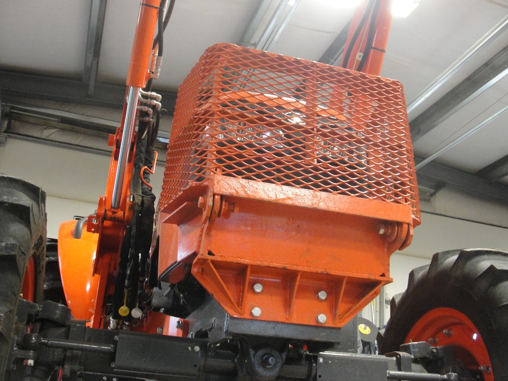

Before you even bother to convert to SSQA, build a good brush guard for the front of your tractor. And don't even begin to entertain the thought that you don't need one. With a Grapple you DEFINITELY need one. Trust me on that one.

I process most of my fire wood on the concrete slab from a burned out building. On smooth concrete I can move split fire wood pretty good. On dirt it is way less effective. A grapple is extremely useful for firewood, but moving split fire wood isn't its strong point. I don't think I have any pictures moving split fire wood. I like the thumb on my backhoe too. My grapple is 72" wide and the backhoe thump with my narrow bucket is only 12". I like to pickup the 72" pieces you can't cut in the grapple with the backhoe. I would buy the narrowest grapple you can fit on your tractor.

I thnk picking up split firewood is a tall order. It's like trying to pick up two rocks with a grapple. It rarely works in my experience. Firewood is just so irregular.
   / Best Grapple for Grabbing Split Firewood? Show us your pics! #8
I have been pretty successful picking up two rocks with a grapple. You have to pick up one rock first, and lay it about 18" from the second rock. Reposition the tractor, and grab both rocks. If I want to be really lazy I grab a third rock in the backhoe thumb. I try to avoid having to transport firewood after it is split. If I have to do so I usually park the tractor beside the splitter and throw the pieces in the grapple. Firewood splitting works best with a helper to move the split pieces, and roll up logs to be split.
