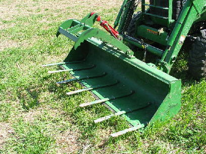

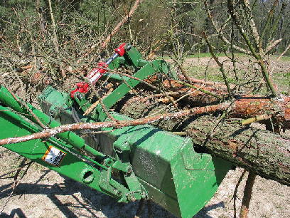

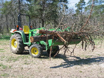

I bought a grapple attachment from a guy on ebay that is working great. It's only 18 inches wide, but I'm doing a ton of work with it and have few complaints. I did have to beef up the front a little, but other than that, it worked great. Of course, I'm moving trees more than brush. I'll attach a few pictures so you can get an idea. Watch ebay and you can probably find him. If you can't, I may be able to find some contact info.
The grapple was around $400 or so, and then you have to run hydraulic lines, which isn't cheap. I think I spent close to $200 for all the lines and fittings I need to run to my rear SCV.

Last one to show you my ballast box, which has about 1200 lbs. in it.

so that grapple just attaches to the top of your FEL (mine is a 430) and then grips it against the FEL?
is there a deere option like this?

/ best grapple for a 4410? #11
Yes, it just bolts on. Or you could weld it. I have a heavy duty bucket, so the top is reinforced. If you didn't have this, you would need to reinforce it. One thing is that there were no holes drilled in the mounting plate, and it took a good sized drill press to drill the 4 holes. He uses 1" steel.
I've never seen a JD option for this. There are other companies that will make a bolt on grapple, but for a lot more money.
If you are interested in this one on ebay, I would have him put another cross member closer to the end of the grapple. Just e-mail him and talk to him about it. You don't have to buy through ebay. And if you want, I could take some close-ups of the reinforcing I did to give you an idea.

boiler, can you compare the bodozer/anbomanufacturing with the ebay one you showed pictures of? i like $400 vs $2850 in price, and only having one attachement vs two.
spoke with the ebay grapple guy, very helpful and will basically custom make it for my bucket
advantage vs disadvantage?
/ best grapple for a 4410? #15
I really can't compare considering I don't own anything else. I can tell you that I like that this just bolts on my bucket, and that it can be done by one person. So you can take it on and off when you like. I'm not sure how the grapple would work without the bucket tines that I also have. Might be something that you'd want to think about adding as well. But, it may work well without them. I can't say. I've never tried.
I just wanted to let you know this option out there. I shopped all the expensive attachments, but decided to try this. And I'm happy with it. Actually couldn't imagine doing this work without it.
