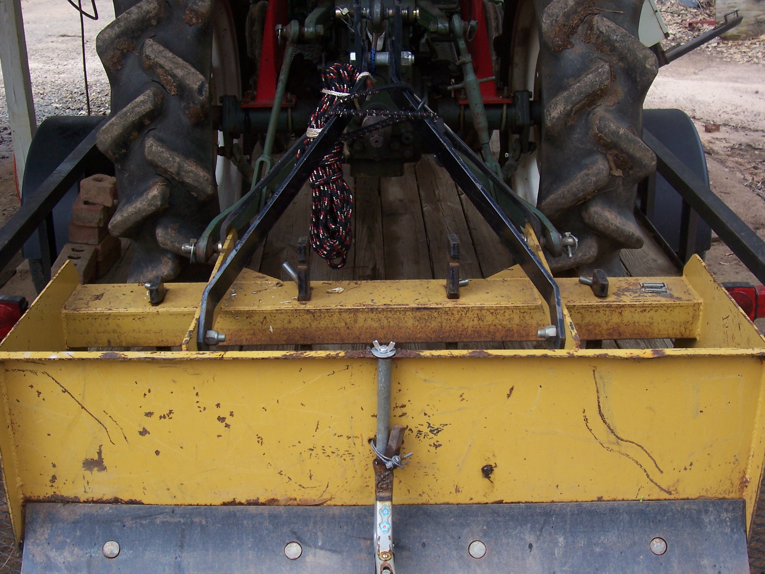

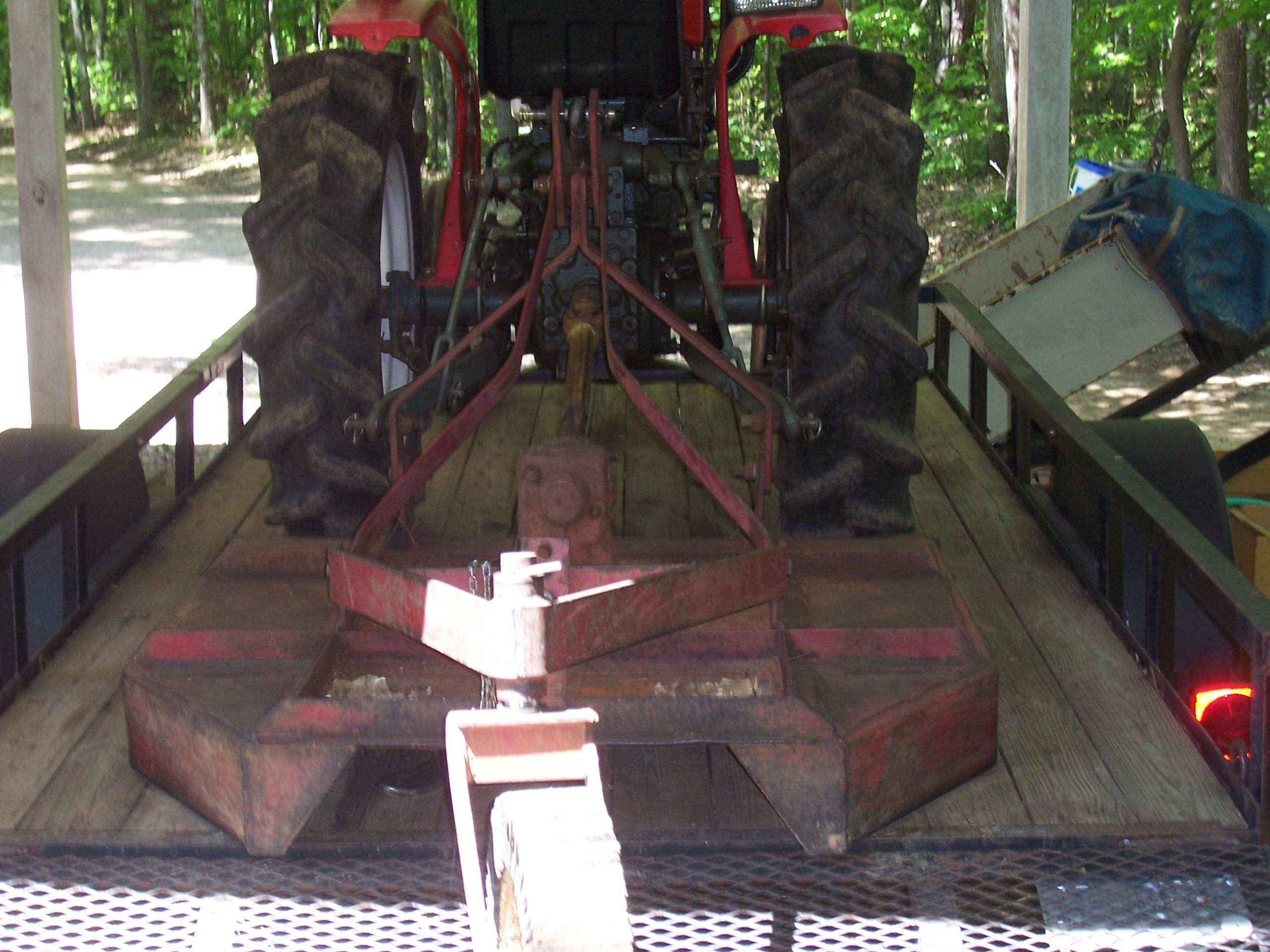

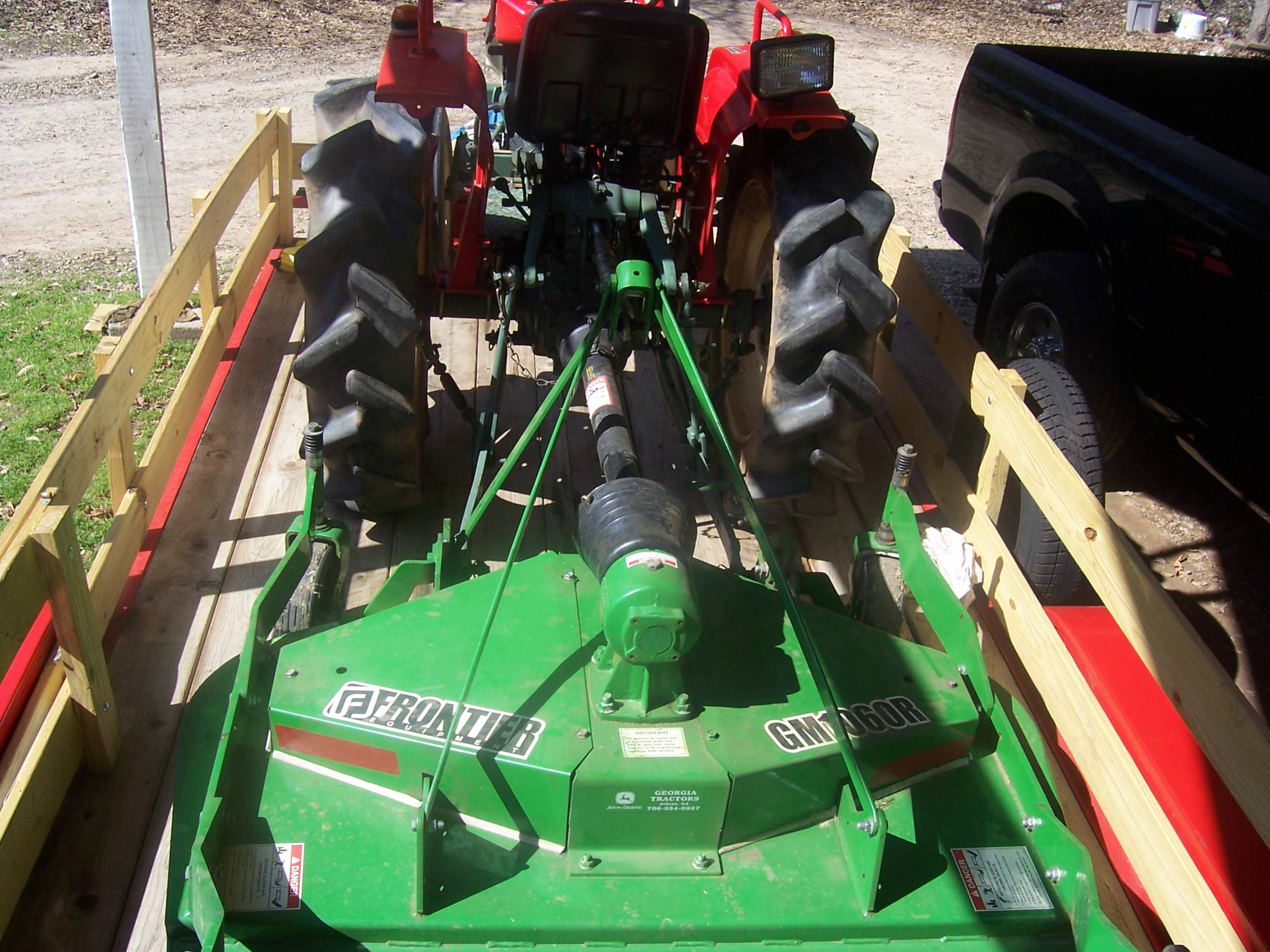

4Ft. bush hog. 4'B. Blade 5'FM. for me. My Fm. gets used Wkly. Rear discharge. so my 2000 handles it with ease. I run 2nd. gear PTO. with it, it's that easy. Be careful like clemsonfor said about the overhang. 4' is perfect for me but the JD.I used and it's BB does overhang and I mean almost Ft. each side and it's real easy to catch things. Trust me!! Even Knowing it and still happens. I used a Yanmar tiller for yrs.. I bought from Fredricks and it was sweet!! Worked easily. And pic's also of my attachments. Notice the width to the rear wheels.
SWEET setup Careyo63. :cool:

I would agree. 4ft is so much better to control and operate. I have a bigger Yanmar than most here, and I still choose the 4ft box blade and bush hog. I have a King Cutter 6ft disc harrow, it works really nice because it's just discs that rotate. Got a 5ft straight flat blade too. This way, when grading, the rear wheel tracks are covered. :)
