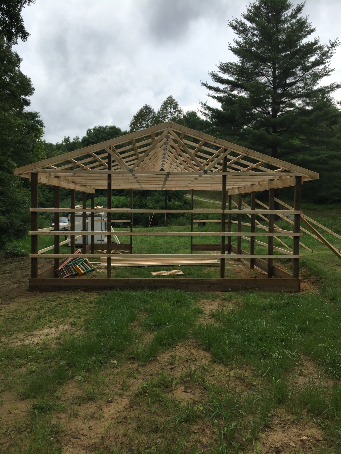

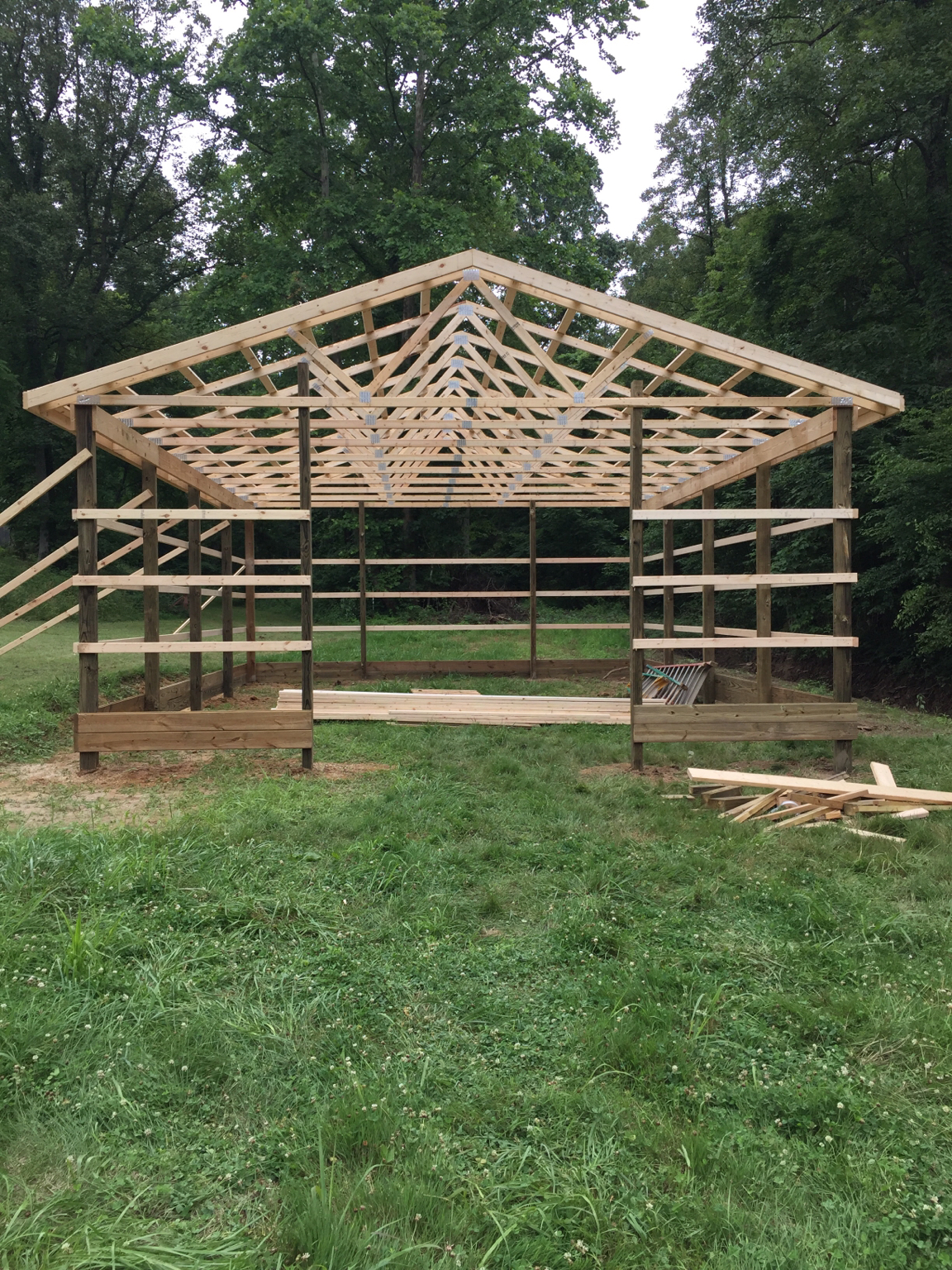

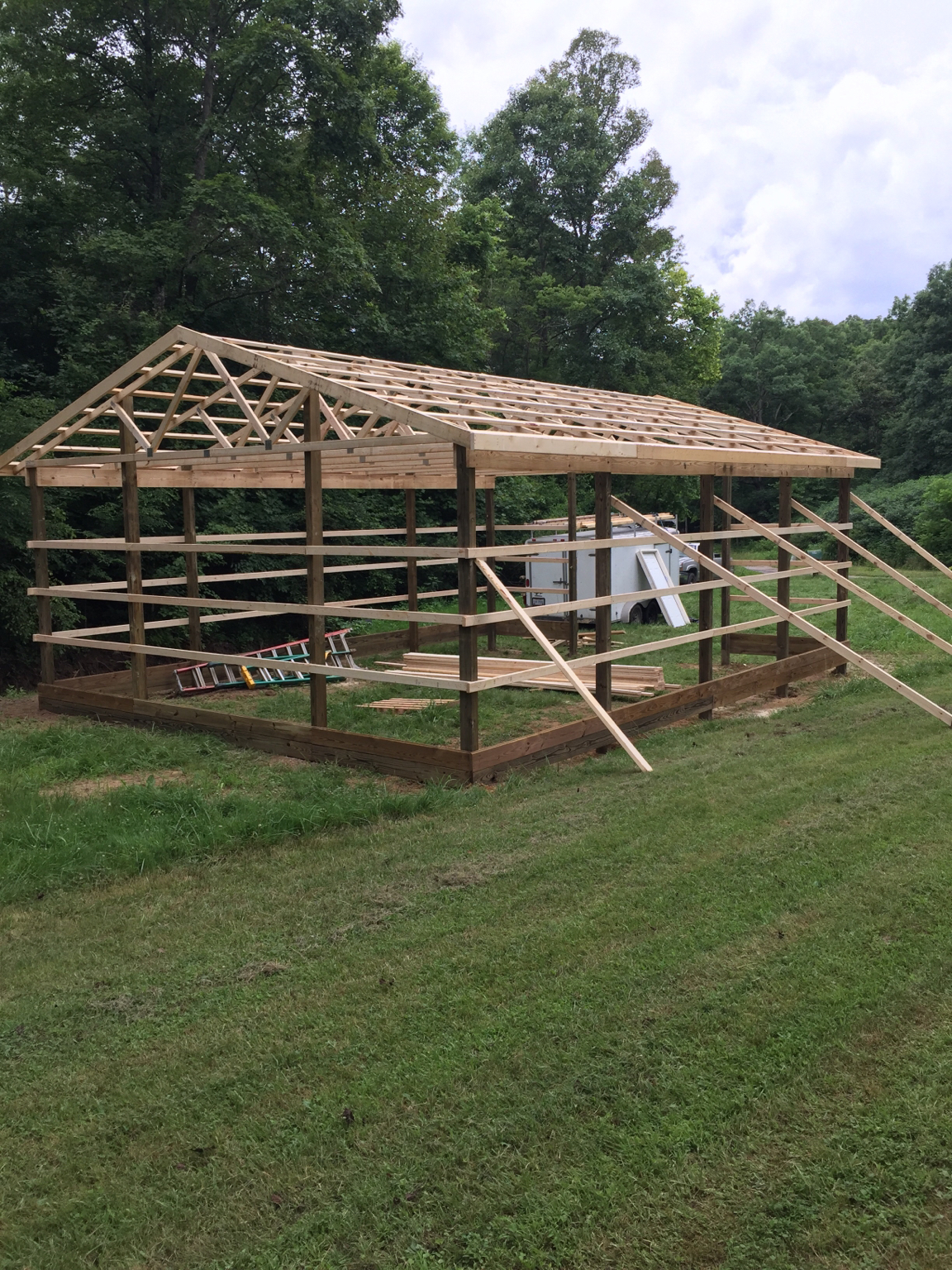

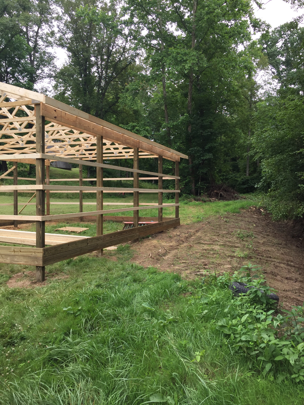

So... putting up a 24x32 pole barn and it ended up being on more of a slope than anticipated. I’m curious as to what sort of economical recommendations there would be to prep this for a concrete slab. My plans were initially to only pour a 4-5” pad using fiber infused concrete. I’m just not sure the best, while least expensive way, to get this ready. As you see from the pics it runs between 0-16” from front to back of the building.

I would take out the grass, level it with gravel and make a gravel ramp back to ground level out the door.

Yup, take out sawd and topsoil, backfill and shim with something like item 4, tamping it in layers as you grade.

All sod and organic will need removed. Many concrete guys do not want to place embankment.
Gravel crusher run(304 in Ohio) will be a good base for concrete.
You can use variable depth for concrete slab.
It is easier to build barn on all ready leveled pad, then it is to level pad after building is built

Top soil must come out
   / Best concrete floor prep for pole barn on downward slope #10
Yupp, topsoil is garbage structurally. DO NOT CHEAP OUT ON THIS STEP. The concrete looks good, but the subgrade does all the support work. Poor subgrade=failed concrete.
