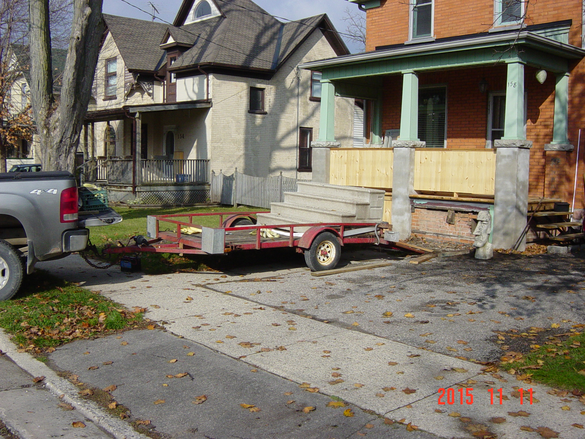

That's still BIG. I ran a 1000 or so pound superwinch, doubled up to drag these (free) steps onto an old trailer. A deep cycle battery JUST did it. Steps are hollow. You can see battery on pavement.
