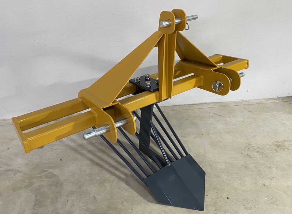

Or maybe a potato digger like this one, although, these won't go that deep and may not be strong enough.
image;s=644x461
Who makes that? Thanks
