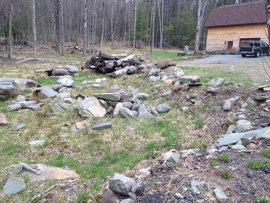

Hey all,
Im new to this site and looking for a bit of advice. I just built a new home and have a ton of yard work to do now, mainly turning my construction site into a yard. I have used my Kubota B3200 to move the bulk of everything to where i want it landscape wise, mostly backdragging with the FEL. I live in the catskills and my soil is all clay and gravel so this meant a lot of getting off the tractor and picking out the 2ft plus boulders, back dragging again to pull out the smaller stuff and then keep working my way down to golf ball size stuff which i would wind up raking out by hand before throwing seed down. It has been a lot of work on the few sections i have done and i know there has got to be an easier way, plus i have a long way to go. Im on about 8 acres and considered just sprinkling top soil over everything but that sounds real expensive....
In researching attachments it sounds like a harley rake is the way to go but that is way out of my price range. Im thinking box blade or maybe a landscape rake with wheels, maybe scarification teeth? Im worried if a landscape rake is suitable for my rock yard? How fast will i break these tines? How do you pros turn a forest into a yard after all the stumps have ben pulled and things have been roughly graded to where they need to be?
Other than the yard i have about a 1000' driveway i have to do also, spreading stone at least. I already filled it with softball size material ontop of road stabilization fabric and had dozers, excavaters and concrete trucks pack it in, but its still a teeth rattler and a pain to plow in the winter- LOL. I know i can spread this stone with the FEL but would a rake or box have any advantage?
Any insight would be appreciated!

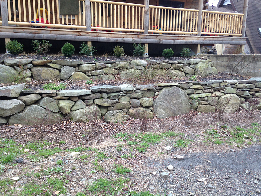

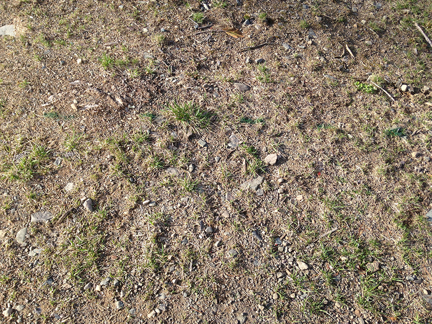

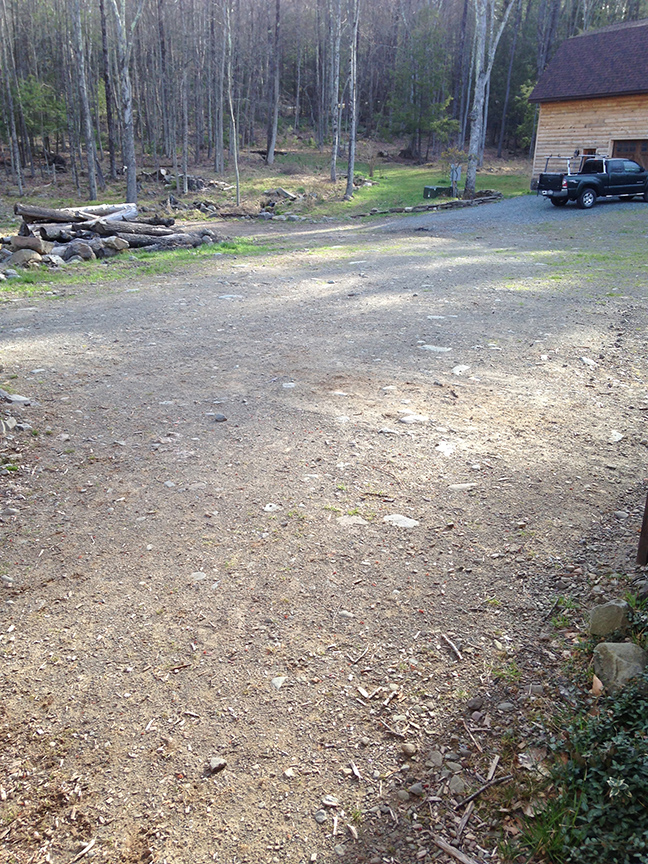

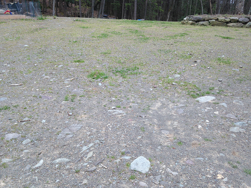

Thanks all for the responses and great ideas. One thing i want to clarify is that although i live on 8 acres most of it is still mountainous, dense forest and rock, the yard areas I'm trying to work on is about an acre or 2 with lots to navigate around- garden beds, trees, streams ect. So although that rock picker looks awesome, i think it would be tough to use where i am because its not a wide open space. See the pics of my space below....
After reading the above suggestions I am leaning towards renting a Harley Rake if i can find one to fit a B3200. Using a tiller with a box blade and rake seems an option as well. I guess i was thinking that since i needed to purchase an attachment to lay gravel down for the driveway anyway, i was hoping maybe there would be something multifunctional that i could use to help clean the yard too. I would hate to buy a ground planer for example just to do the yard because then what do i do with it? At least something like a rake for example i know would be used to clean up the gravel driveway each year....
Leonz- thanks for the tip about gypsum and lyme, good to know. And yes the tractor does vibrate a bit, especially all the loose pins. Within an hour after i got this machine i stuffed fluffy pine cones into each pin area to keep 'em from rattling. nothing fancy but did the trick.

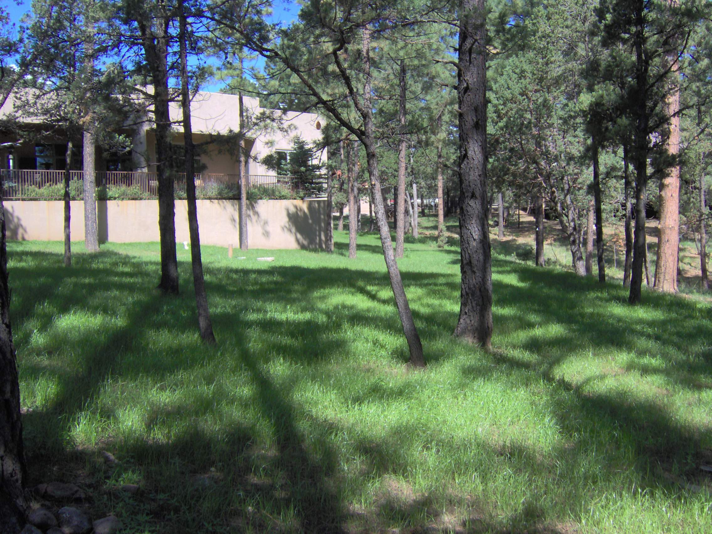

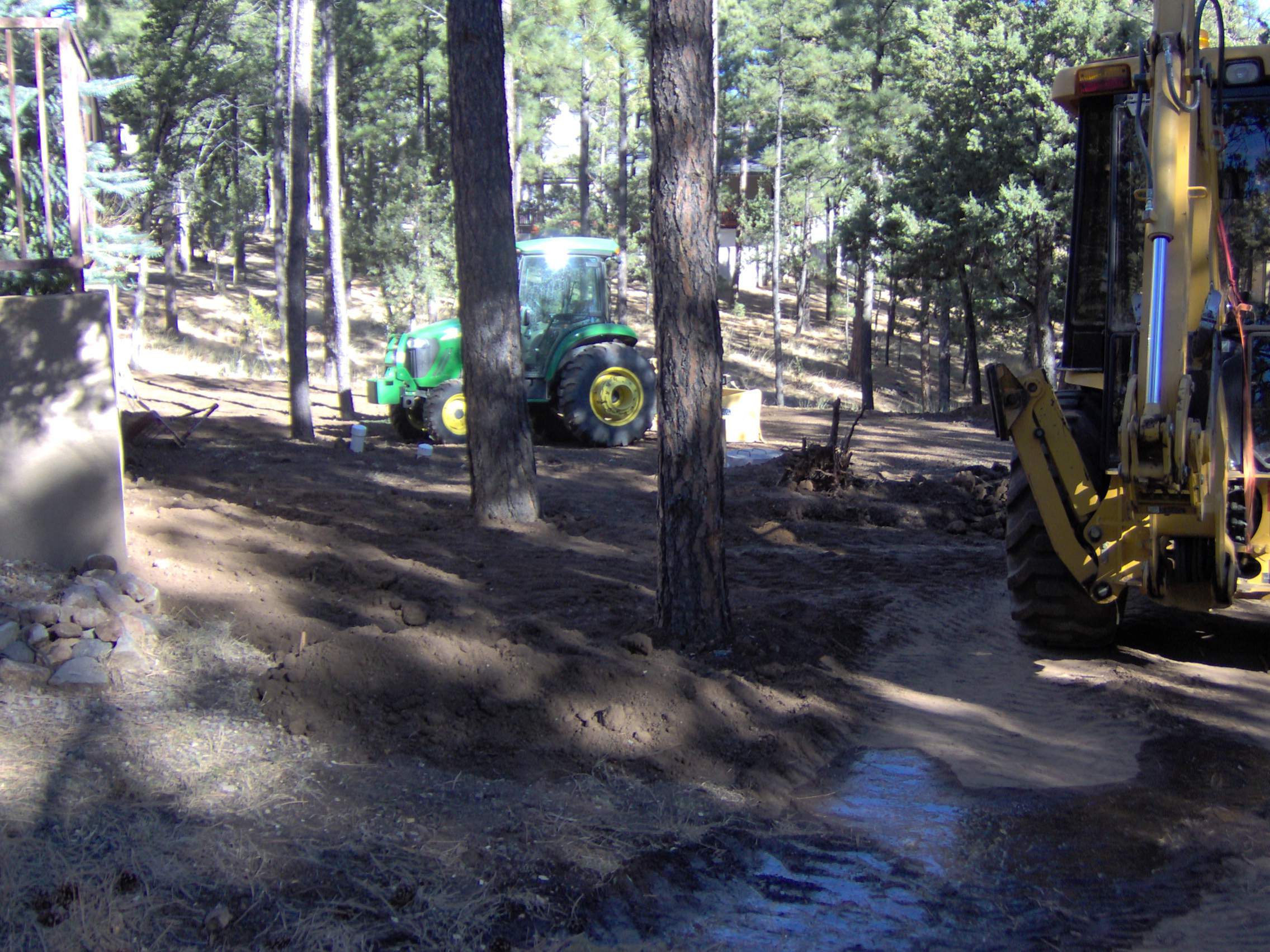

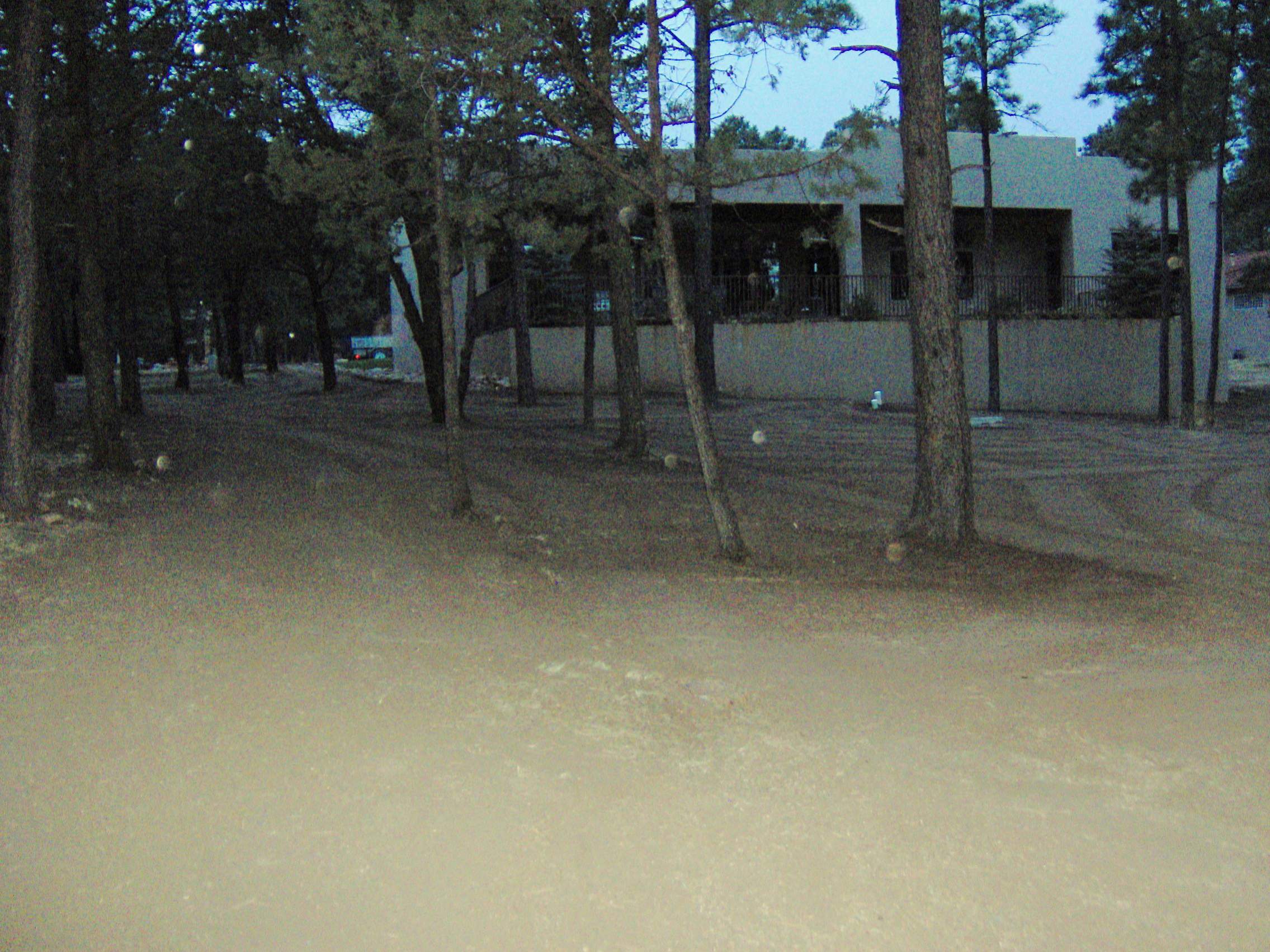

Warren,
I work and live in the mountains of New Mexico and have similar circumstances to deal with at times. I recommend you get the largest rocks out of the future grass areas then haul in clean top soil. Here's a few pics of a lawn I put in a few yeasrs ago, when I started a weed eater was about all you could use. While topsoil is costly I recommend you just add areas as you can afford it.
