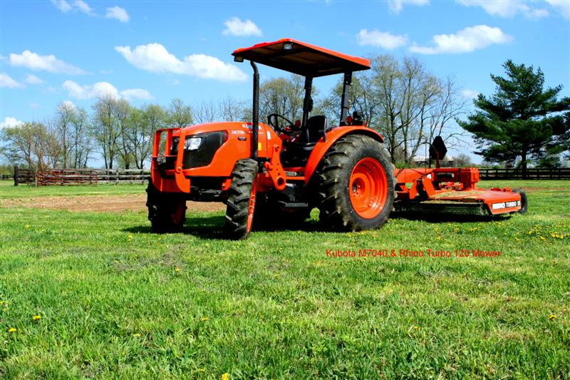

You must have one helluva tractor to be able to run a 10 foot lift type!!:eek: I have a 10 foot pull-type mower. You're right, it does bind somewhat in tight turns. I would LOVE to get a 7' lift-type mower for the option of more maneuverability and for tight obstacles and rough terrain. Since I usually have the mindset that bigger is better I first looked at Woods BB8400. That is one serious piece of steel. It's really too much even for my tractor. The Woods BB840 is just right. I have also looked at BushHog 297 and Rhino TW84. Right now I prefer the Woods and Bushhog. By the way, when I say "looked at", I'm referring to just drooling and dreaming. No way can I afford one of these right now. But I can still dream!:D

Have a 4720 just 50 pto hp and would keep my 4 in 1 bucket on for counter weight. Probably never would lift the rear wheels off the ground. I want it for stability on hills. My 5 ft tree cutter weighs 1650-1700 lbs and I often pick it up and tilt it forward w/ T&T. Most 8-10ft med duty mowers are in the 1700- 1900 lb range.
You have a great looking Kubota- great Ad shot!
