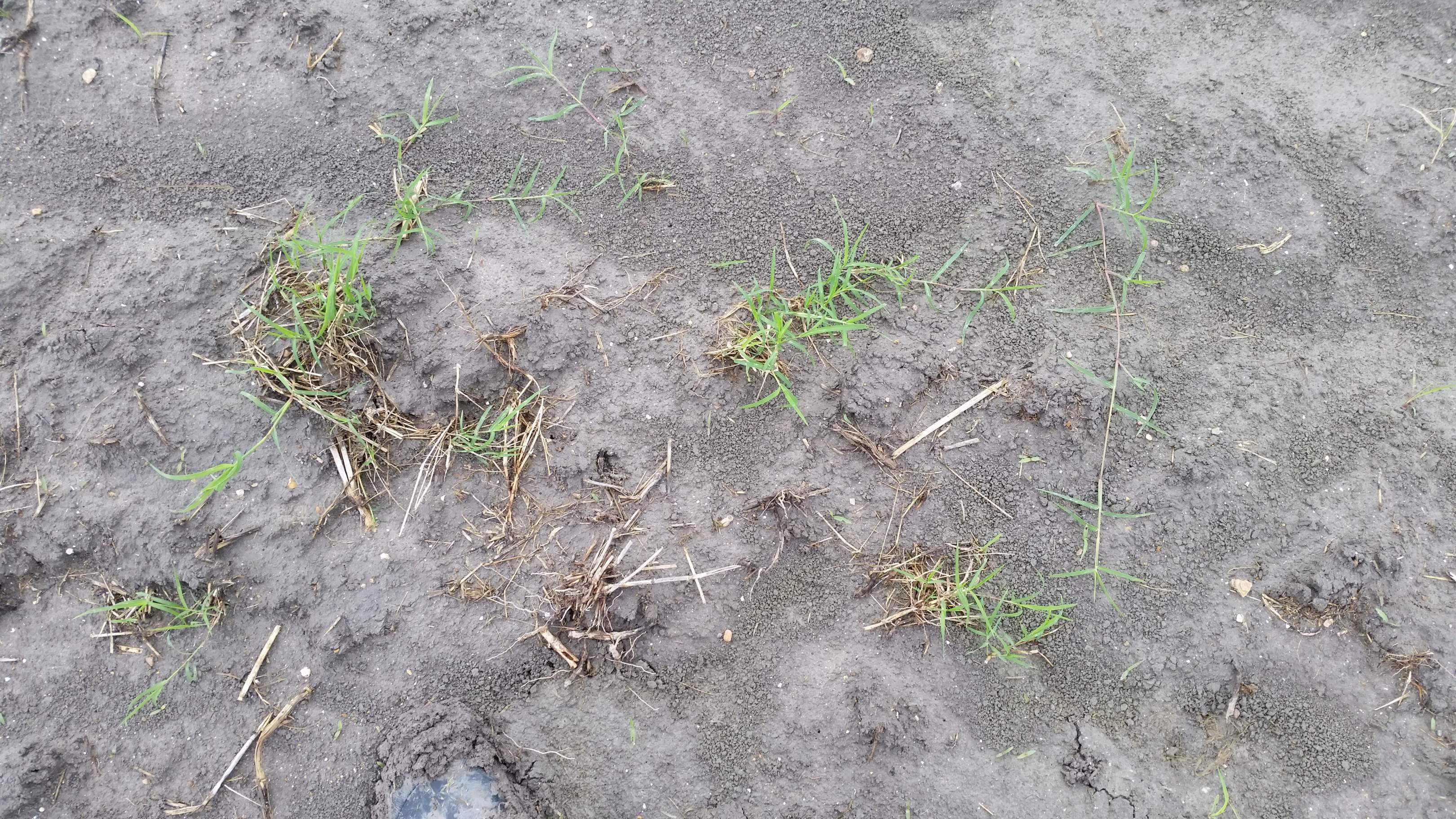

I finished converting 10 acres of abandoned crop land to hay pasture Monday. Half sprigged in Jiggs and the other Cowboy bermuda. Split was for an experiment for a bigger field. Figured I'd share the numbers.
6 hours of chisel plowing in December
6 hours of discing in February
$700 - 2000 pounds of 10-48-0 per soil report in February
$100 - 5 gallons of generic round up late March
$33 per acre for seed (5 acres)
$140 per acre for sprigs (planted with disc and cultipacker) (5 acres)
I won't know any yield results for several months. Hopefully it keeps raining.

Jiggs is starting to come up. At first I was worried about no rain and now my boots sink a foot in the field. Hopefully it doesn't become too much of a swamp.
