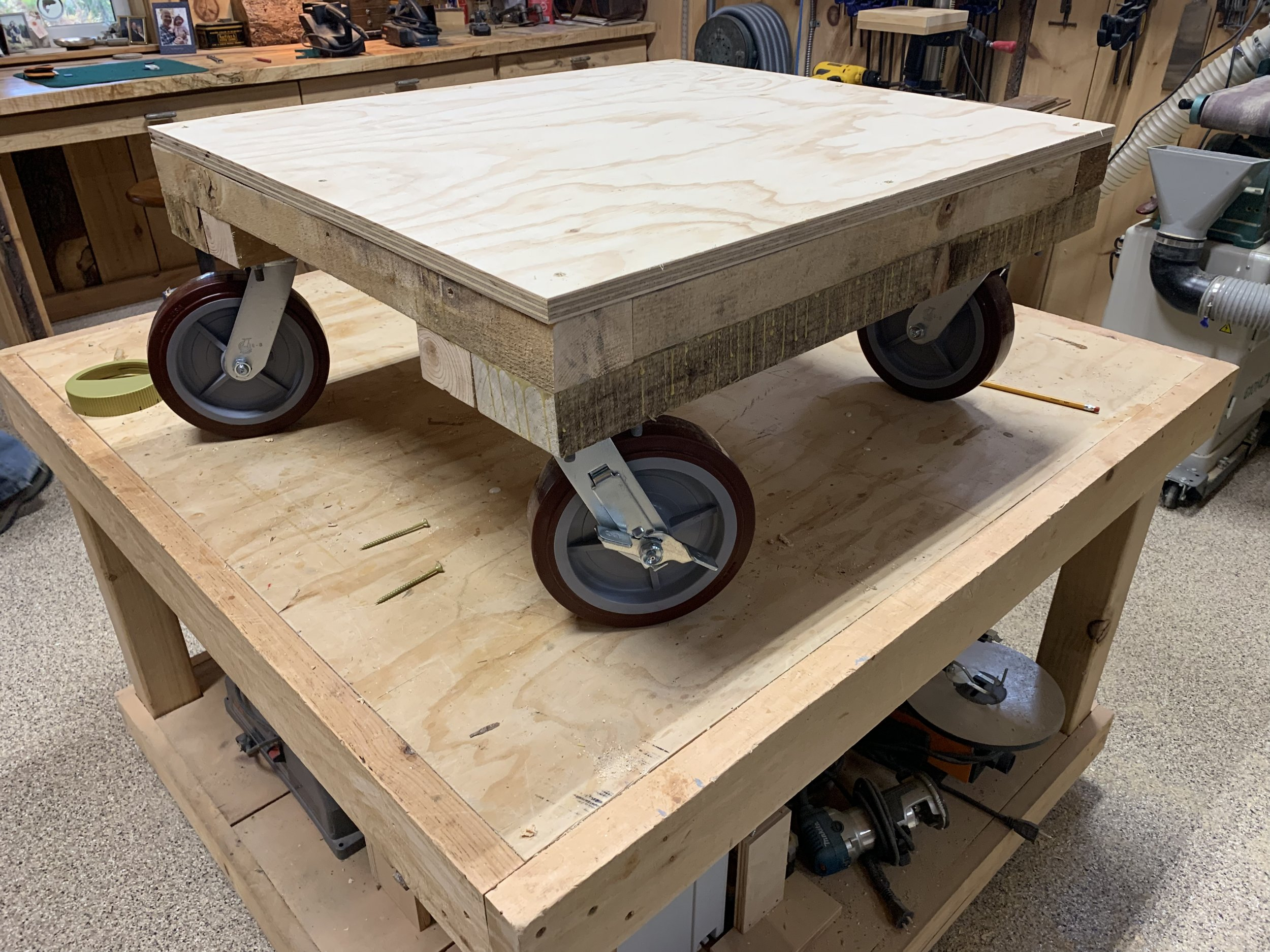

I just made up a plywood platform and put wheels on it for my blower, sure makes things easy .

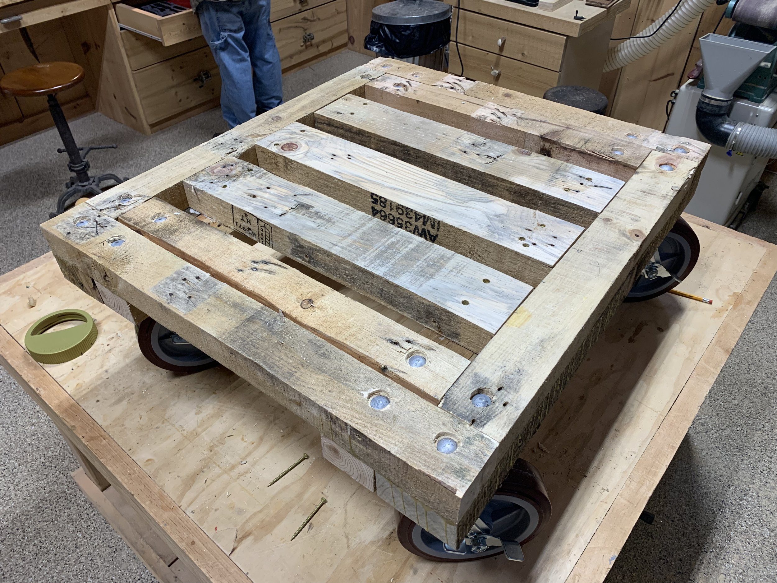

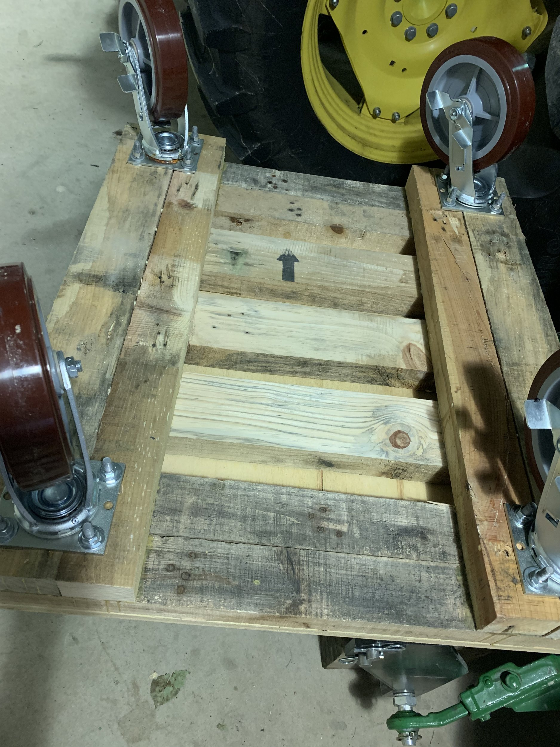

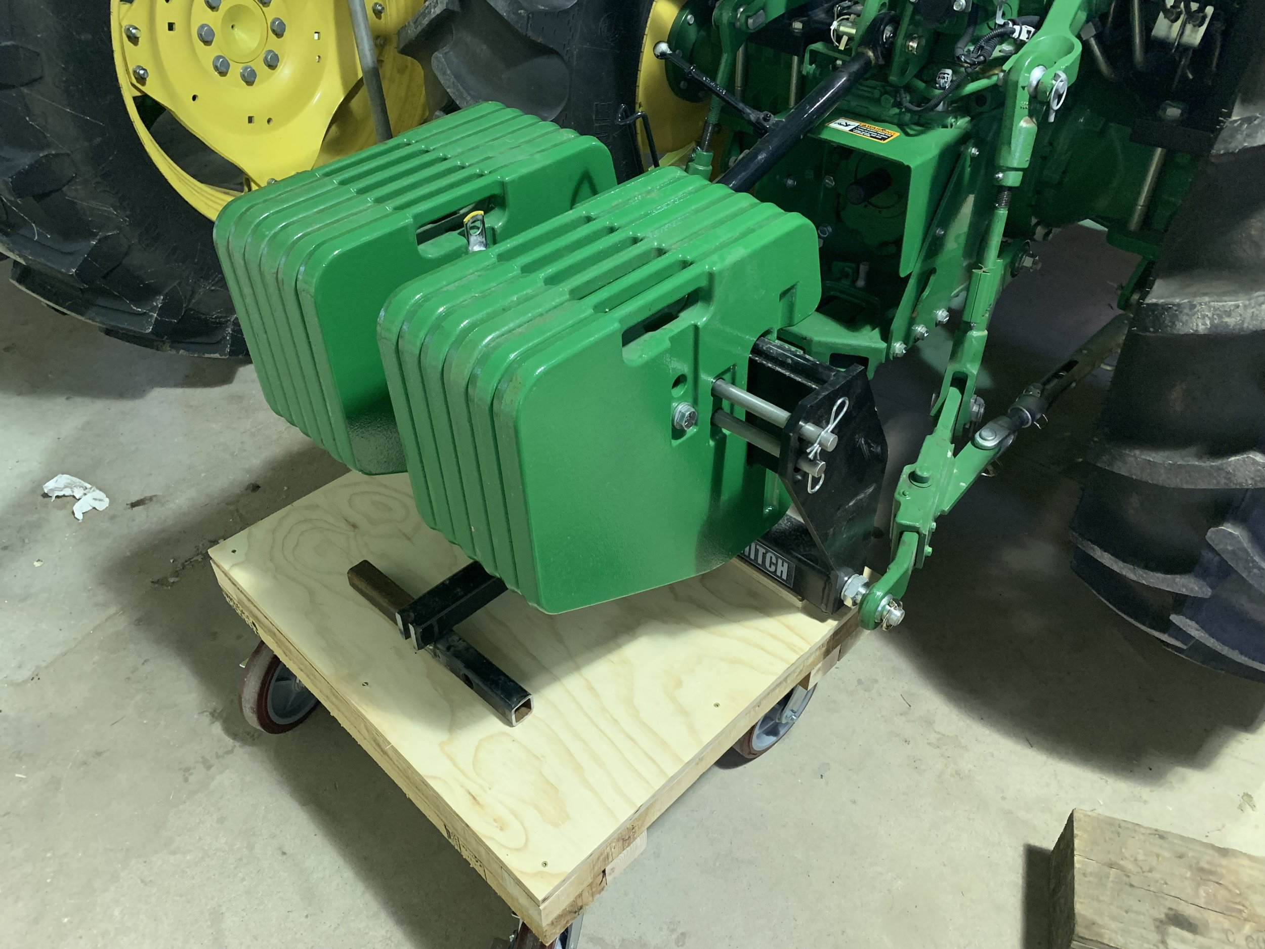

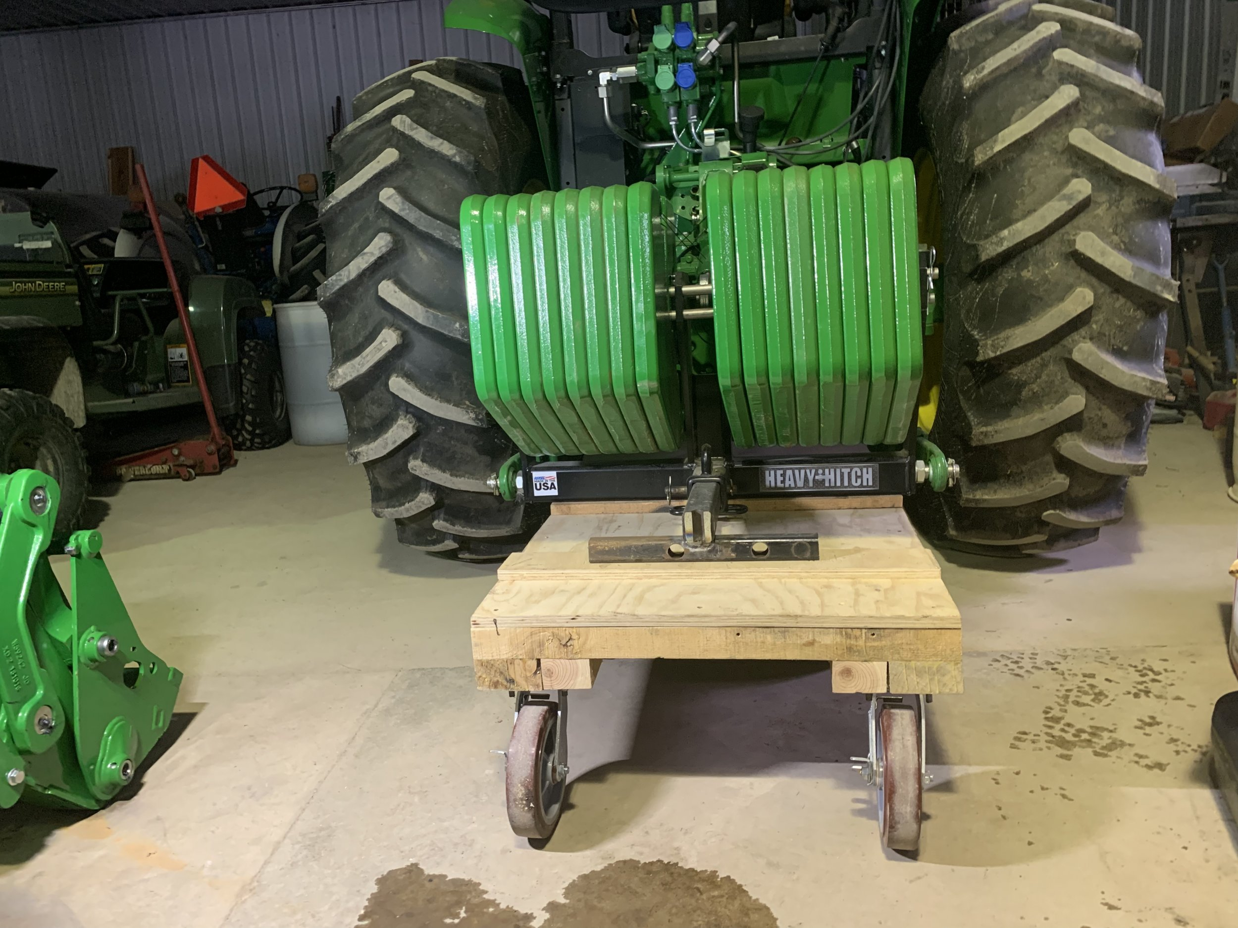

I built a real heavy duty swivel wheel dolly for my 3pt Heavy Hitch that’s loaded with 16 suitcase weights. Makes the outfit real easy to store out of the way or very quickly switch from one tractor to another. I was just going to buy a 4 wheeled dolly but couldn’t find one heavy or tall enough to suit my needs. I salvaged the wood from a hd shipping pallet that my JD loader and bucket came on. If you need castors I would highly recommend you check out Castor HQ available on Amazon. USA made castors of any size and style and less money than the imported one they sell at farm stores.
