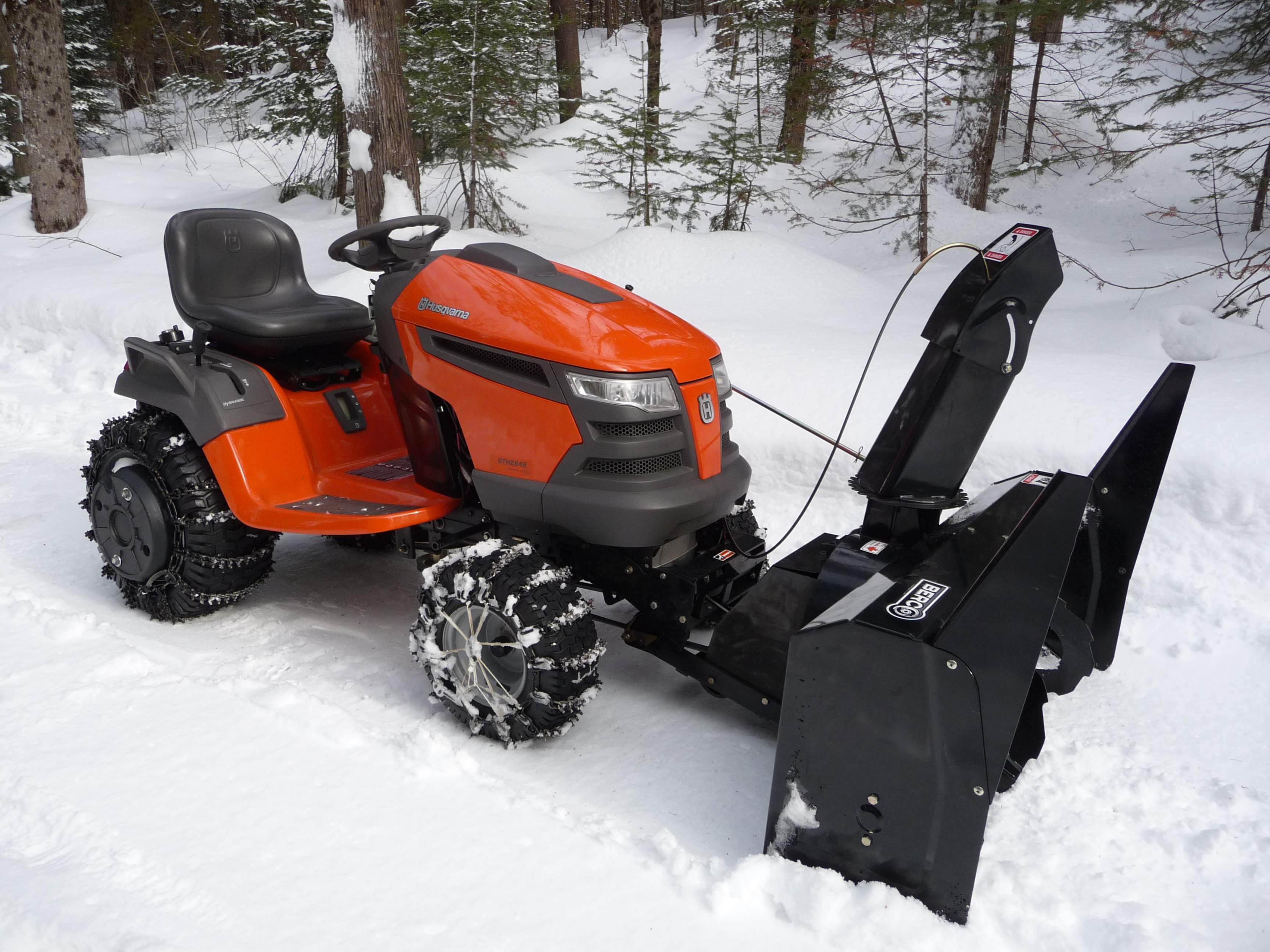

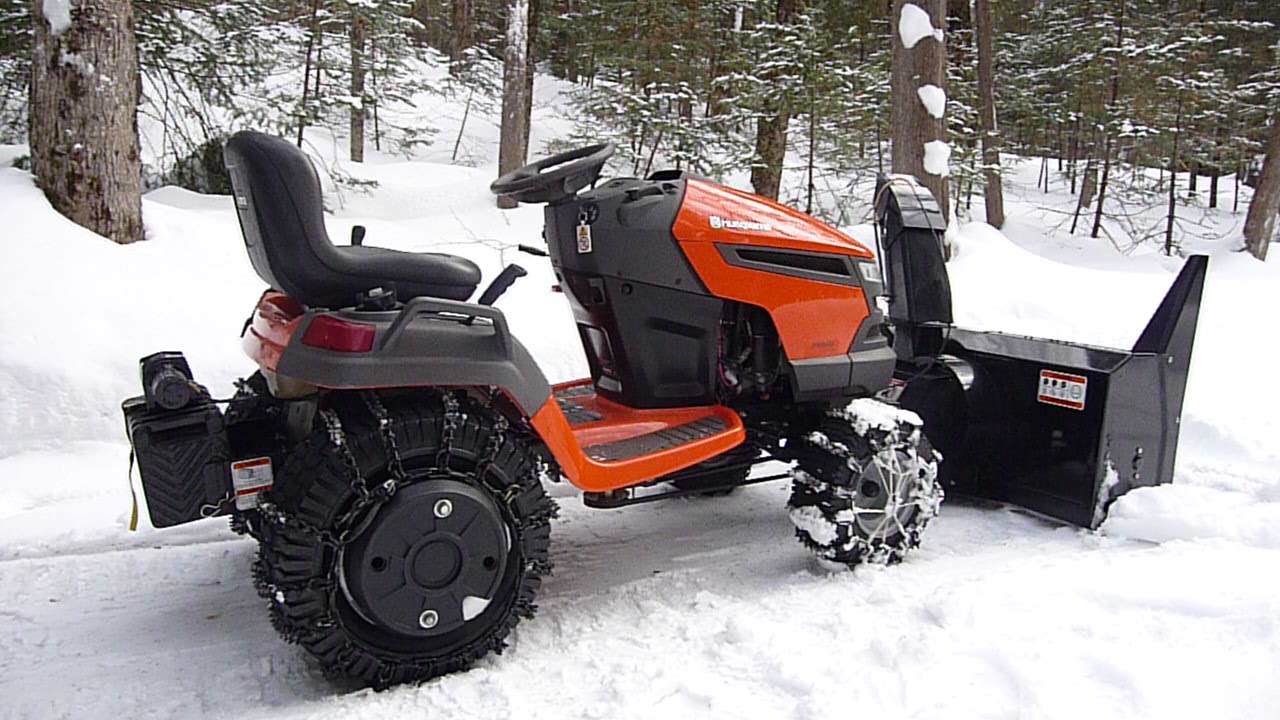

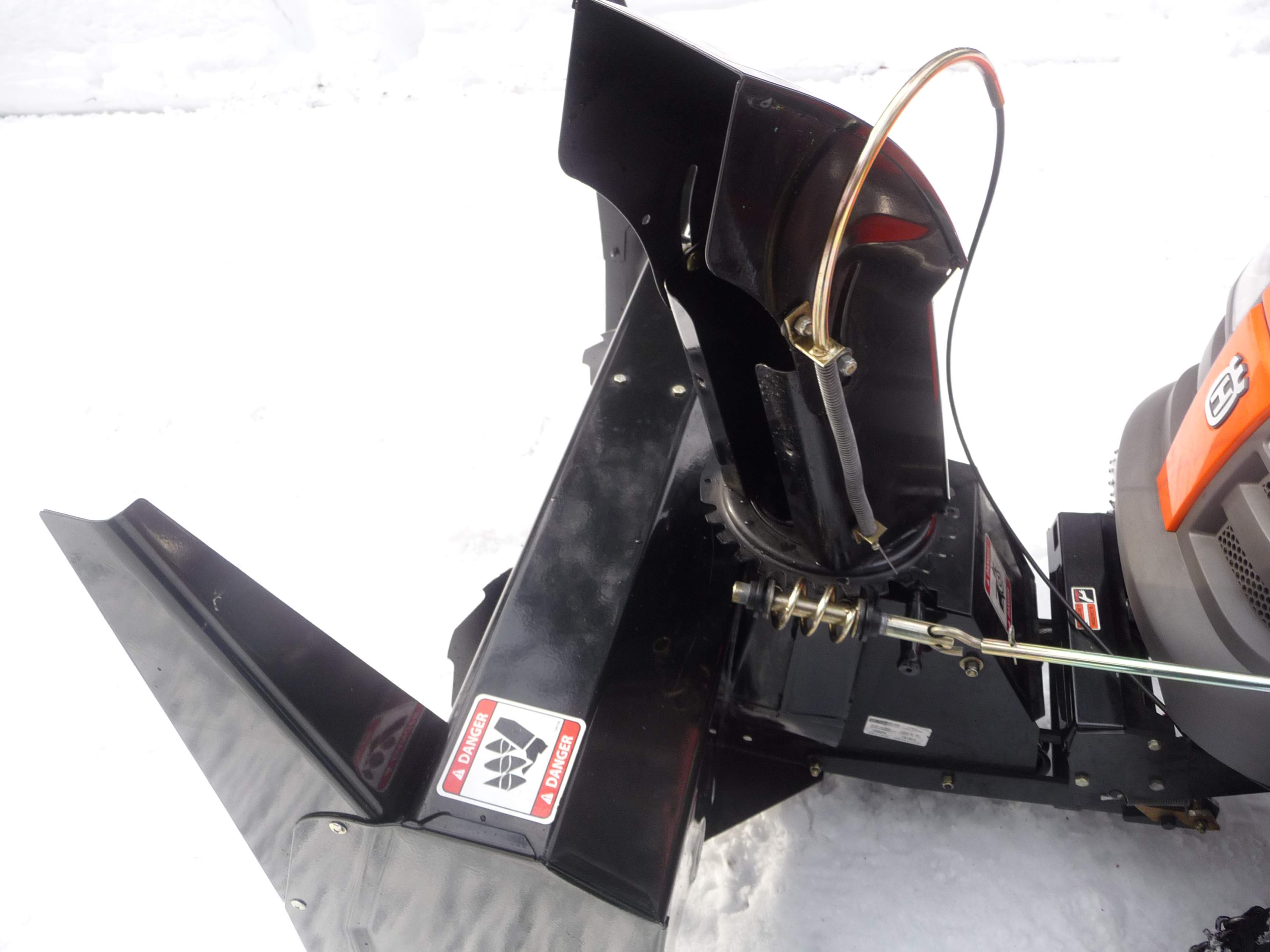

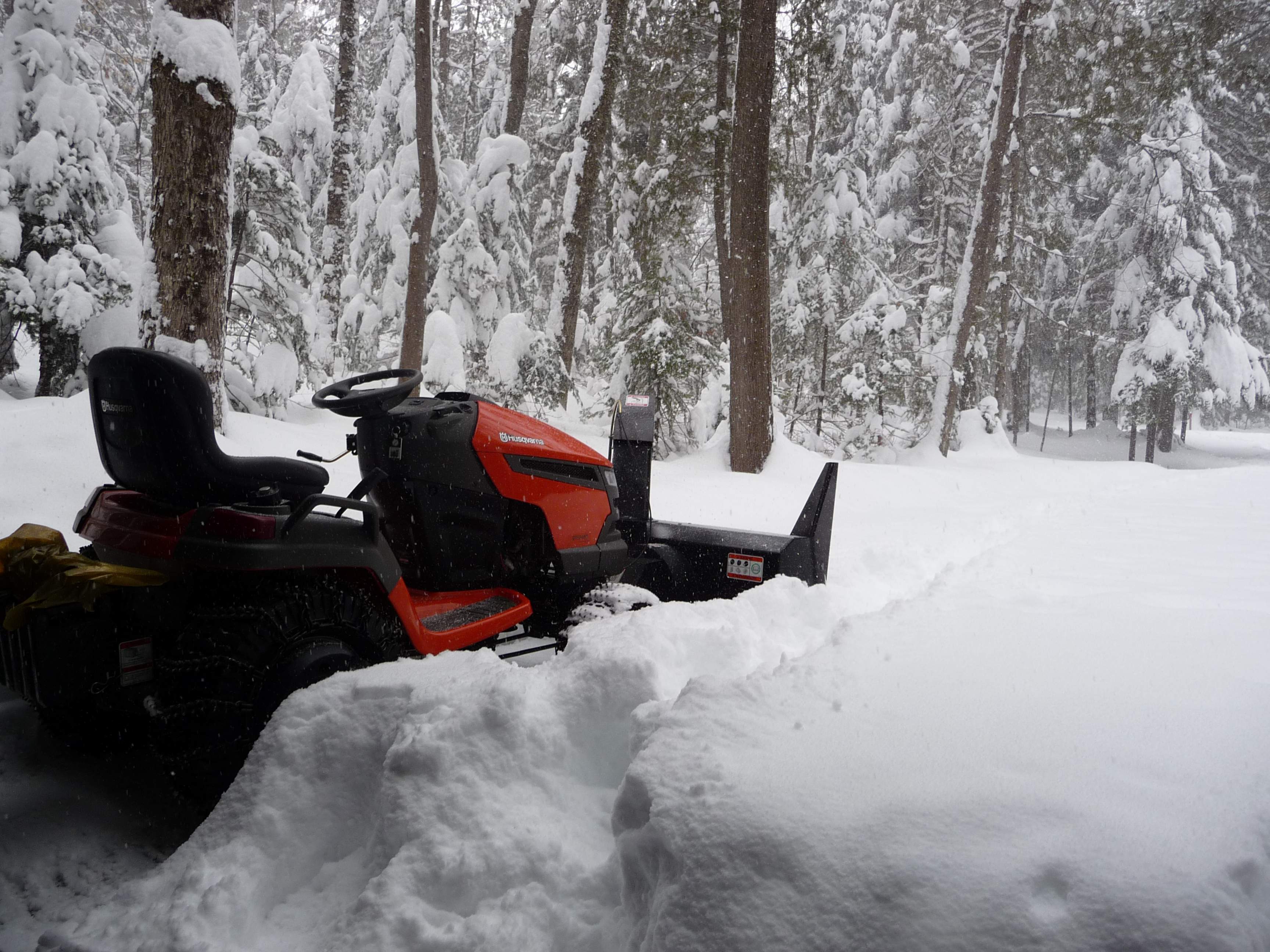

I had both, manuel and the electric lift. The little electric lift is really a nice option. Since last year, they worked out the only problem with it: the mechanism was getting apart (drum/hoist). The screws are now installed with Loktite. Make sure to spray a good antirust to maintain "as new" the cable.
PS: you need to keep close to you a sufficient number of cutter pins and one extra strap of both size.
