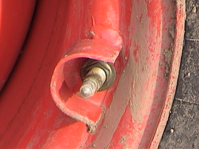

<font color="blue"> You might want to have a welder to weld some valve stem guards around your stems. </font>
Here is a picture of mine.
RedDog
   / bent valve stem #10
My rims, for R-4s on the CK30hst, already have those steel guards on them. Maybe it depends on who makes the rims for Kioti.
