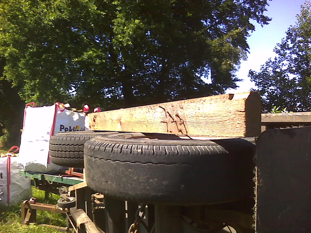

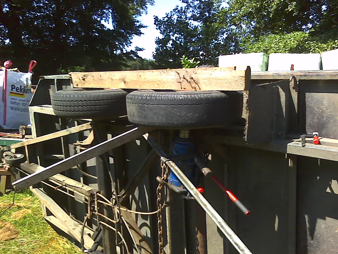

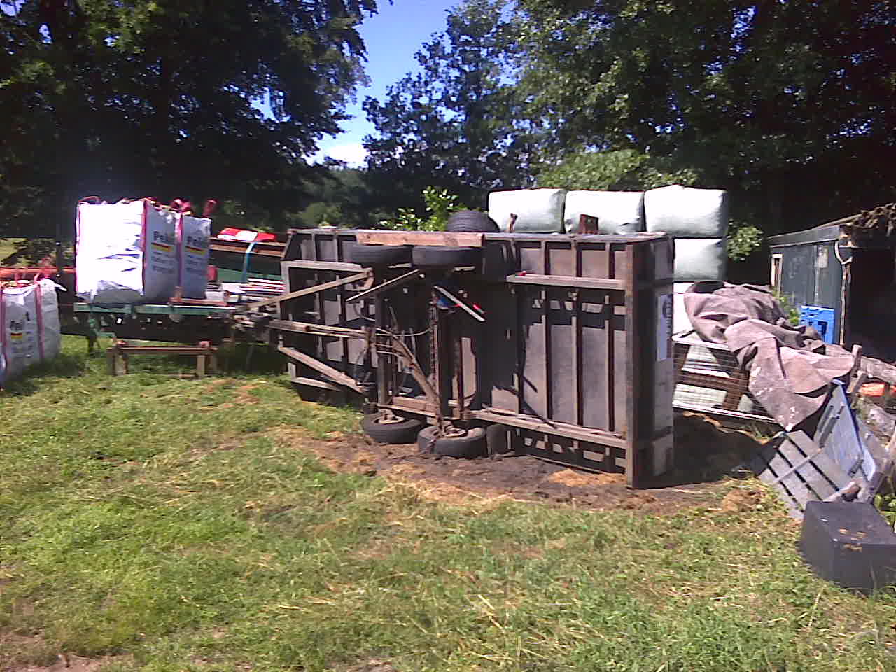

And here some photos of how i did it last summer: A bottle jack hung in a loop of chain, with welding clamps preventing the chain to skip off.
Both times worked out perfect, no tire wear, but only the last time i went without collateral damage.
The "oops"
the cure
and the scenario
This trailer went up and down to Germany on the very same tire you see bald on the outside here.
I used to work at a trailer shop, and from experience i can tell you 80% of the cases are caused by turning too short around a curb. the other 20% is caused by severe overloading, though its usually the tires that blow first.
