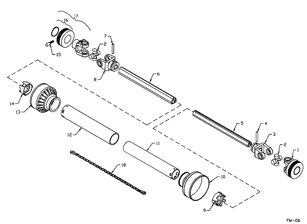

I managed to slightly bend the PTO shaft on the manure spreader. The shaft is rather long (3+ ft) - anyone have an idea how expensive it will be to replace the shaft? A couple of farmers recommended straightening it out, but I don't know if that's possible..
pf
   / bent PTO shaft on manure spreader #2
You might be able to simply replace the shaft portion (see diagram) of your pto shaft. I know locally that I can buy shaft material by the foot for only a few dollars per foot.

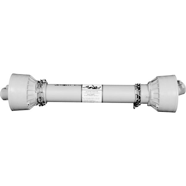

TSC has a fertilizer spreader shaft (PTO) for about $85. Actually they have several. just need to have your size when you go in.
