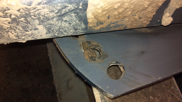

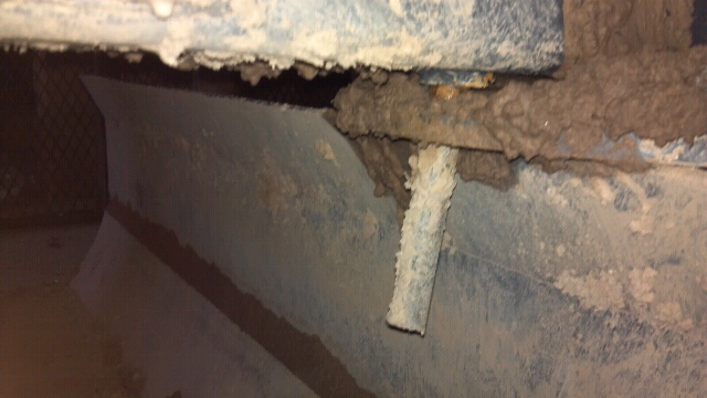

I have a 72" Tarter blade on my Kubota L4330. Currently the large pivot pin, about 1 1/2" dia, is bent and I've gone through 3 ,3/4" adjustment pins. Also the adjustment holes have been elongated due to the bending of the adjustment pins. I've ordered a new assembly to replace the damaged parts ($200). I keep catching rocks or a hidden stump in one case that is causing this damage. With the new parts on their way I need to come up with a way to prevent this. Any ideas? Thanks.

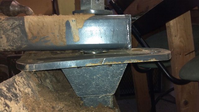

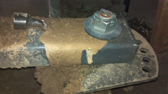

Yep that's the blade. The pivot pin is the big one with the nut. The adjustment pin is the one used to change the angle.
Was pulling when it happened. Right now I can't swing the blade around because the adjustment plate hits the main support arm as it rotates. You can how the plate is at an angle to the main support this is because that big bolt is bent. The big bolt and adjustment plate is all one welded unit. That is what I'm replacing.

Wow, that doesn't look good! If you are replacing everything that is bent with new, then this is what I would do to make everything stronger. Everything in blue is your blade now, what I would do to make everything stronger is in yellow and would need to be welded on. Hope this helps. :thumbsup:

Really the 2 options are a heavier duty blade built better, or drive slower.
Don't know of any spring/release setups for a back blade.
Something has to give. Either your wheels spin, or something bends. The blade needs to be built heavy enough to handle the shock loads of the speed you are moving.
If it busts up, you are moving too fast for that blade.
