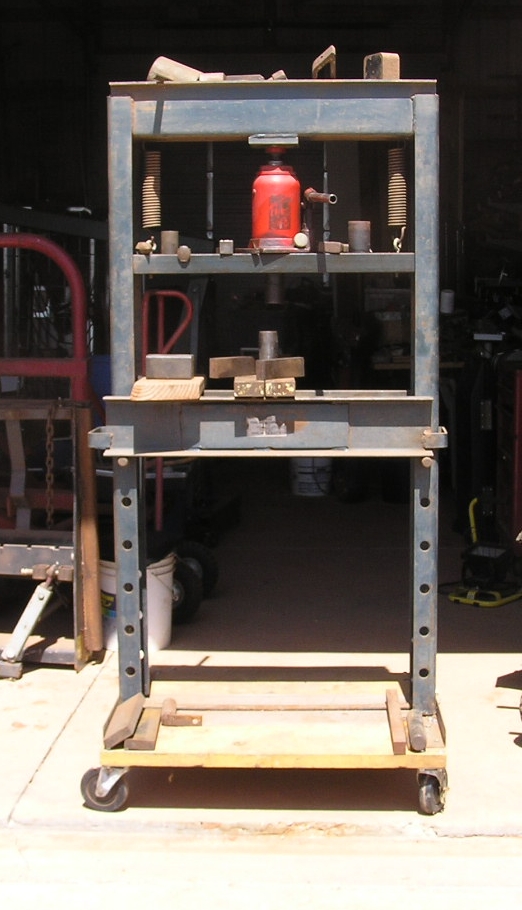

I have straightened a lot of bent metal with a bottle jack, short I-beam and chain.
It got bent cold, you can straighten it without heat.
If you have a gooseneck trailer, hook it to the truck and use the jack foot like a hydraulic press works.
Also this would be a good reason to get a hydraulic press.

I agree with the press. Harbor Freight has them on sale for $154. I've not used a press much in my life, but in the last 6 months I've switched careers and now use a press often to remove bearings, install bearings, straighten bent arms, etc... really handy tool for the shop.
