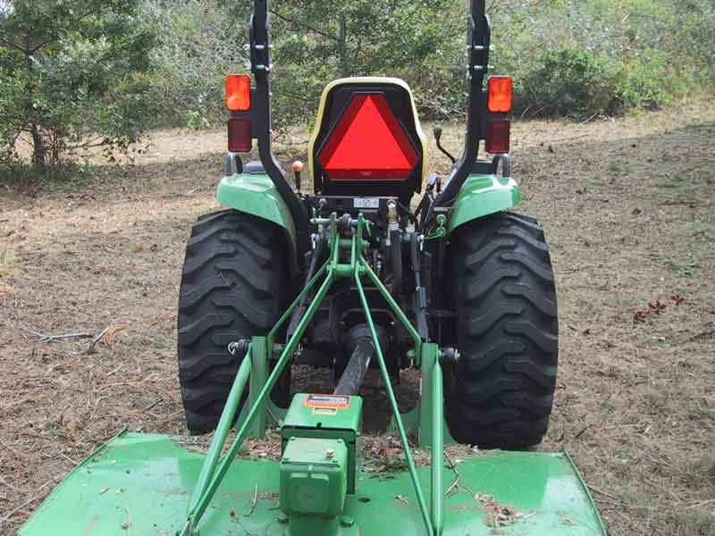

Thanks, guys. I've checked both points made, and will post some pictures for further clarification. On this post is a picture from the rear. You can see the MX5 is skewed to the left a bit.
I recently had a bad experience with backing a boat trailer over a log at while turning, and man, did the long leverage of the trailer put a force on the hitch couple and bent to badly. Granted that's lightweight metal, but I guess it's given me a respect for the forces at play. Then again, I don't have enough experience with the strength of a 3ph and how it reacts under strain. I'm sure it's stronger, but not sure how much stronger.

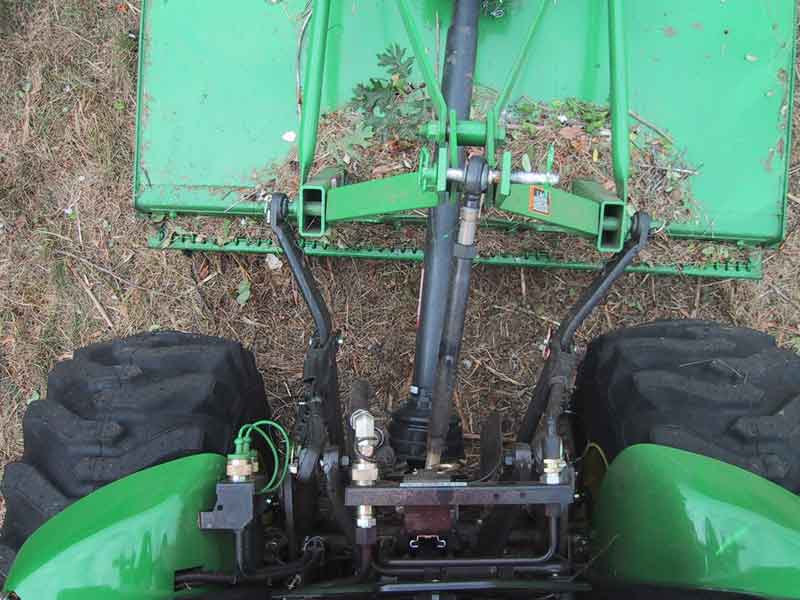

Here's a picture looking down while standing on the seat.

I don't see any "check-chains" or horizonal stabilizers on your hitch. Most tractors that I've seen have some sort of stabilizer to center your implement and restrict sway from left to right (and help keep things off your rear wheels). The "angle" of the cutter is apparent in this picture and it seems to me that (on my tractor) I would adjust the stabilizers to center the load. Without that, I don't know if you can get any aftermarket from JD?

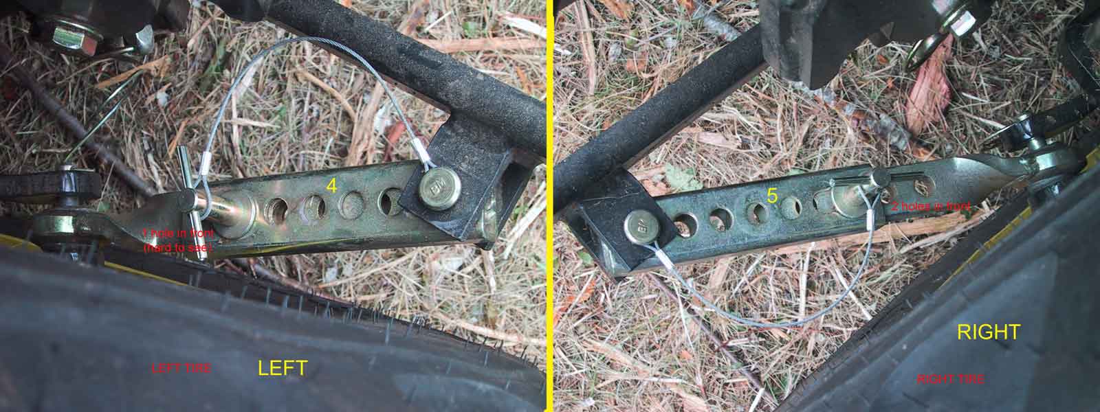

This picture is a photoshop composite of two photos I took while standing above the rear tires and looking down at the adjusting arms. When the dealer delivered the unit he attached it, but the right side is ONE HOLE MORE EXTENDED than the left! (You can see 4 holes on the Left, while 5 are on the right) That would of course swing the attachment to the left. I sure hope that explains it! Hopefully this is a lesson that doesn't cost too much (unlike some of my other learning experiences).

Glenn, I think they just weren't visible in the photo. Check out the next photo, as I think that this is what you are referring to, and as you suggested, they clearly need adjusting by one hole.
   / Bent my bush hog or 3PH ? #9
That's it. I couldn't see them in the previous picture. I've found that things generally work better if I adjust the linkage as snug as I can to hold the implement centered behind the tractor and reduce sway. You may have to pull the pins from both sides and start over. You'll probably need to have the bush-hog supported by the hitch just off the ground about level so that you aren't fighting its weight. Go to the tail-wheel and swing to to the center and then select an adjustment on one side and then the other. Hope this works.
