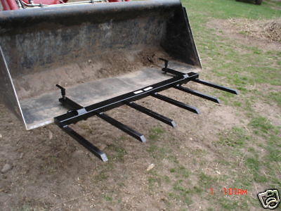

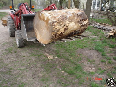

I got this unit as the cost was good but it is made from soft steel and the tines bend. I do some tricks to try to straighten them out but the are never the same. I have a lot of brush to move with over 400 trees down and I want to be able to pick up logs as well. Does any one have any recommendations of a good set that will hold up? I have a Kabota 3400 and I could use a 4' or 5' rake. Thanks for any help. this is the one I got now it shows it picking up a big log but they must have rolled it on to the forks as if you hit the dirt they may bend.
   / Bent front end loader brush rake. #2
That brush rake is not designed to move 1000lb objects. It is meant to move piles of brush that probably weigh a max of 200lbs at a time. You need a proper grapple.
   / Bent front end loader brush rake. #3
Nice looking but I wouldn't waste my time trying to keep them straight. Either get forks or a grapple seeing you got a ton of trees to deal with.
I made a set of brush teeth sort of like yours only it was pretty heavy. After I put down force on the bucket it bent about 20 degrees. After a couple missteps with the bucket, it bent bad enough to go in the scrap pile.

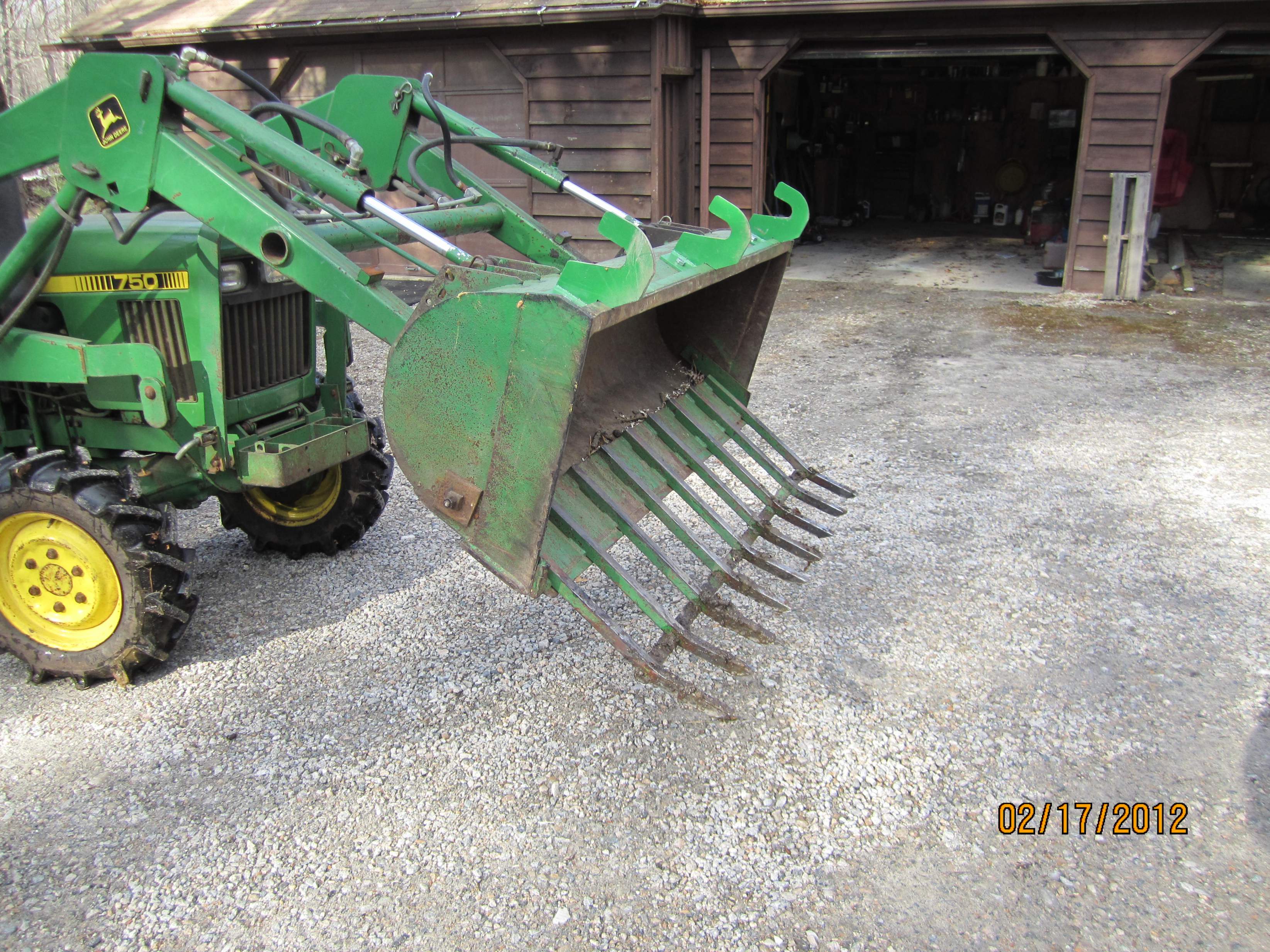

Before getting my grapple, I tried bolt on forks like that. Just like you have found out, they are very light duty and prone to damage. The problem is that after you fix them, they will just bend and twist again. Every time you fix them, they bend more easily after each repair.
Same thing happened with pallet forks. While stronger, they allow movement, which leads to problems.
Consider getting a grapple, they really are worth whatever the cost and effort it takes to make it happen!!!
   / Bent front end loader brush rake. #6
Well I don't know what yours are made of but after you attempt to straighten them out once more, you would then need to weld a half round across the bottom front to tie in all the rest of the tines. Did this to a set I made that was cut from 1" square stock and before I did so, bent them as you did. Now they can pick up a 1500 lb stem with no problem.
It might also help to tweak the tips upward on a bending machine at your local weld shop for additional strength.
