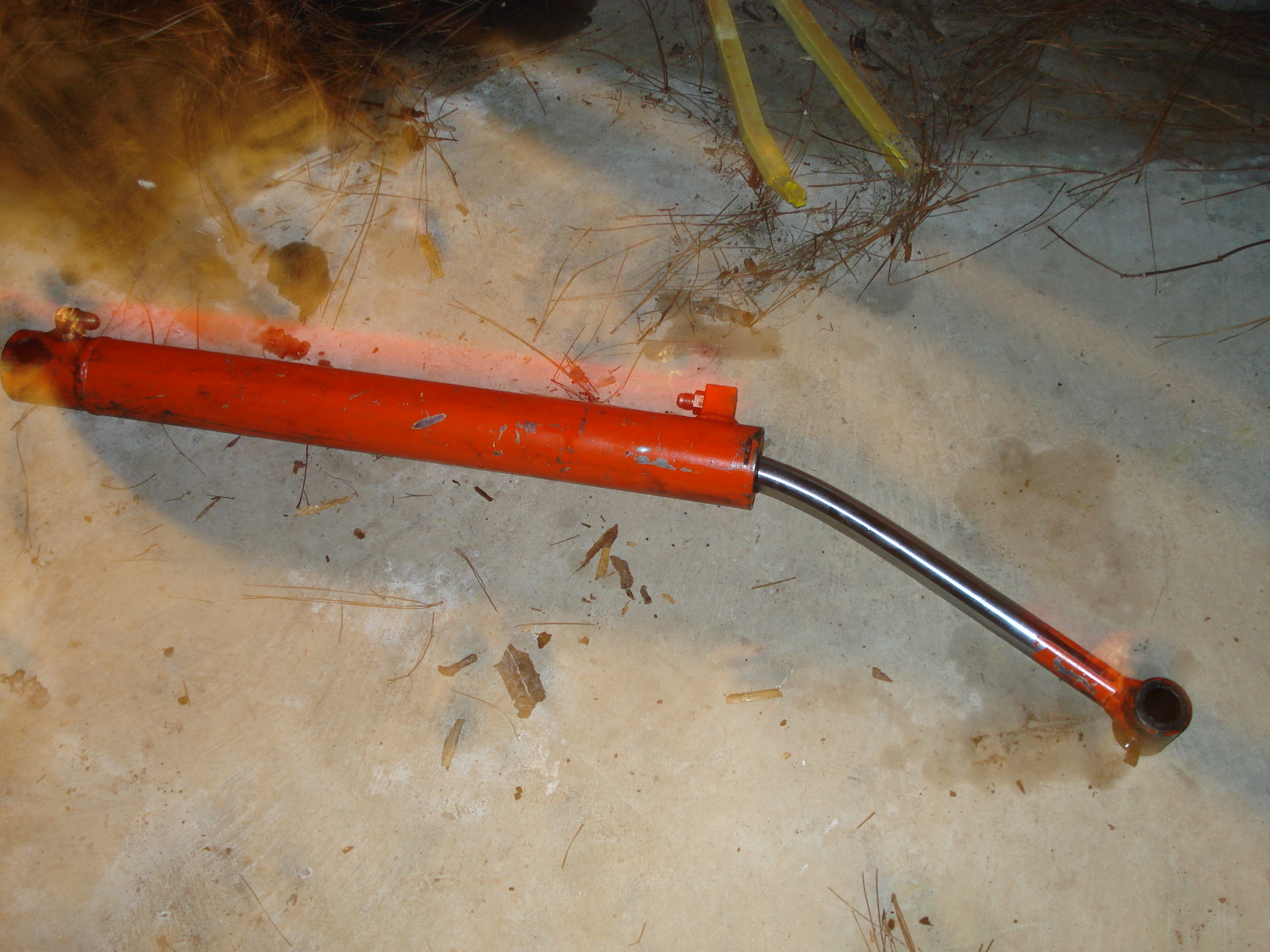

My Kubota L3400 has an older 4690 backhoe that has done quite well until today when I bent the boom cylinder rod. I was digging some riprap around my spillway mouth and had the bucket four feet below the ground surface when I realized the boom could not come back up and the cylinder was visibly bent. The new cylinder is on order but I would like to figure out what I did to cause this failure. Searching this site I have found where dipper and crowd cylinders have bent when digging close in to the tractor but nothing concerning the boom cylinder. Does anyone have any information to share?

Attached is a picture of my bent boom cylinder. I took it to Savannah Ga. yesterday to a repair shop and found out pretty quick the repair was as much or more than a new one. Cost is $300 plus shipping from Messicks. Wonder if there is a cheaper generic somewhere? I have dug a ton of stumps with no problems. This time I was digging 4 feet below ground level and obviously did something wrong?

Can't be sure from the picture, but I'll bet somebody could straighten it. The key is to use rubber or leather at all contact points to protect the rod when pushing on it. You may not get it perfectly straight but it's surprising how much "wiggle" will pass through the end seal without leaking, as long as the rod is not scratched.
A machine shop may tend to price the job based on perfection and low liability. But if you take it in the back door of a place that repairs farm equipment and ask them to attempt to "improve it" you might be pleasantly surprised at how good they get it and how little it costs.
The dipper rod on my old Wayne-Roy got bent once. After shade-tree "straightening" it was pretty good but still had a visible whoop in it. Worked fine for years, didn't leak a drop, never bent it again.

Cylinders are more likely to bend when they are fully extended. You can check your pressure relief to make sure it is working.

Ah yes, Bent Cylinder Itus;
No the cylinder is not salvageable as the stuffing box and barrel will have been egg shaped by the damage done!!!!!!!!!!!!!!!
The reason it happened is that the cylinder was fully extended and could not retract as the oil port was blocked and when crowding the bucket with the boiom the hydraulic cylinder did not have adquate support/strength in the piston area which is at the base of the cylinder rod.
In many applications the the piston is under heavy side loading stress and a "Stop Tube" is inserted between the piston and the stuffing box of the hydraulic cylinder.
The engineering rule of thumb is one inch of stop tube length for every foot of fully extended cylinder rod length.
Meaning if the cylinder at its fully extened length is three feet long fully extended it needs a stop tube three inches long inserted between the piston and packing gland to reduce its actual working length to 33 inches of travel to eliminate the problem. Why the builders of these machines do not do this is an unknown to me. It is most likely a case of I have an application and ordering the cylinders sized to match the application-bad idea from an operating standpoint.
You can buy or order cylinders everywhere, but its an opportunity cost thing. It is a case of what are you willing to give up to get something else and how quickly do you want it.
To simply solve your problem requires a reduction of system pressure to the backhoe or the installation of two needle valves to control the speed and pressure of the cylinder in travel.
Its up to you; ordering a cylinder from Mr. Messick will get it and it will be done etc. If you do that i would buy two needle valves and the fittings to go with them along with resetting the main valve on the valve body to a lower pressure.
Odering cylinder requires removal of the paint from the barrel and looking for the ID tag and removing the paint from it very carefully to obtain the cylinder part number.
If you have gone that far- ask the order desk to have a stop tube installed in the cylinder (one inch for each foot of useable cylinder rod length-including the partial measurement of less than any one foot distance- so if you have a fourty inch stroke you need a four inch stop tube.
Reducing the system relief valve pressure is the easiest method of the three after replacing the cylinder.
