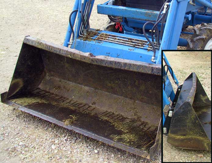

Hi, I just bought a Ford/NH 1715, and the FEL it came with has a bent bucket. It looks like somebody tried hooking a chain to the top lip. I've included a picture. My question is, what would be the best way to repair this? Any suggestions? Thanks!

If it were me, I wouldn't bother since it doen't appear to affect the use or capacity of the bucket. If you are set of fixing it, the only way I know would involve hammers and heat? Depending upon what you use, you might want to consider removing the bucket from the FEL, so any shock loads wouldn't get transferred to the FEL arms. You might also be able to rig something up with a hydraulic bottle jack?

Place a heavy "I" or "H" beam in the floor of the bucket, or perhaps a solid 6x6. Something to spread the load on the bucket floor. Place a bottle jack on the beam and jack the bend out of the top. Use solid cribbing as needed to raise the jacking surface. Keep everything in line to prevent the jack from 'spitting' out. No need to remove the bucket from the loader frame or use heat.

The jack and I-Beam is the best way as stated above.

I'd use the method RickB stated if it really bothers you. After you get it straight, you might want to get a little reinforcement welded along the top and then weld on some hooks instead of using that lip to hook to like the last owner did.

You can do it with a bottle jack like has been mentioned, but If you have a floor jack it will work better and is safer. Jack it farther than straight, to allow for spring back. Be careful, a bottle jack can slip out and hit you. That is why, I said to use a floor jack.

My suggestion to try:
Turn bucket all way down and set bent center part on a jack or stand, lift front of tractor with down pressure of loader, then take piece of 1-1/2 or 2" pipe (schedule 80 if necessary) the width of the bucket, place behind the bucket lip, pull them together with clamps and weld as necessary to top of bucket lip and where pipe contacts bucket.

If was mine, I'd get a piece of heavy angle or channel iron that would fit in the channel on your bucket. Then draw the bucket and steel together with c-clamps or c-grips until it was straight, then either bolt or weld the steel in place.
