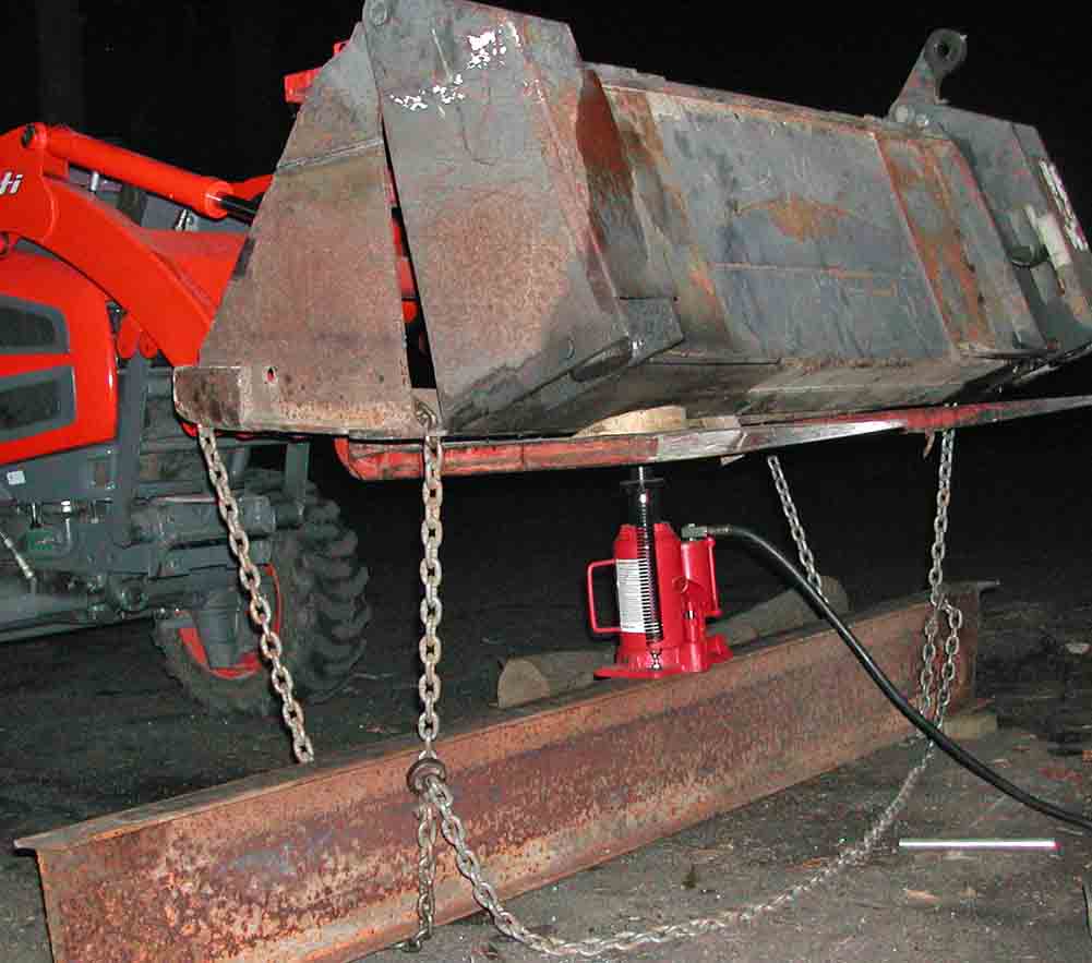

   / Bent Bucket Lip #8
Sometimes you can get a small bkt bend out with heat and a sledge hammer, but
I usually have to resort to a I-beam, chains, and my 20T hyd jack.
I have maxed out the jack on some bends, and have to cut the steel to weaken
it, or replace parts of the carcass. After cutting/bending, I weld the cut to
strengthen it back up.
I have seen what bkt forks can do to the lower part of a bkt, and it is not pretty.
