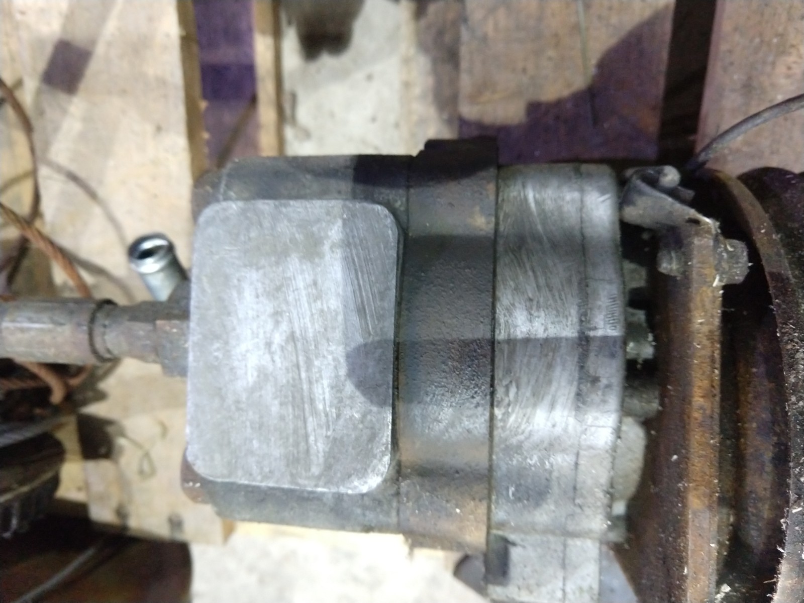

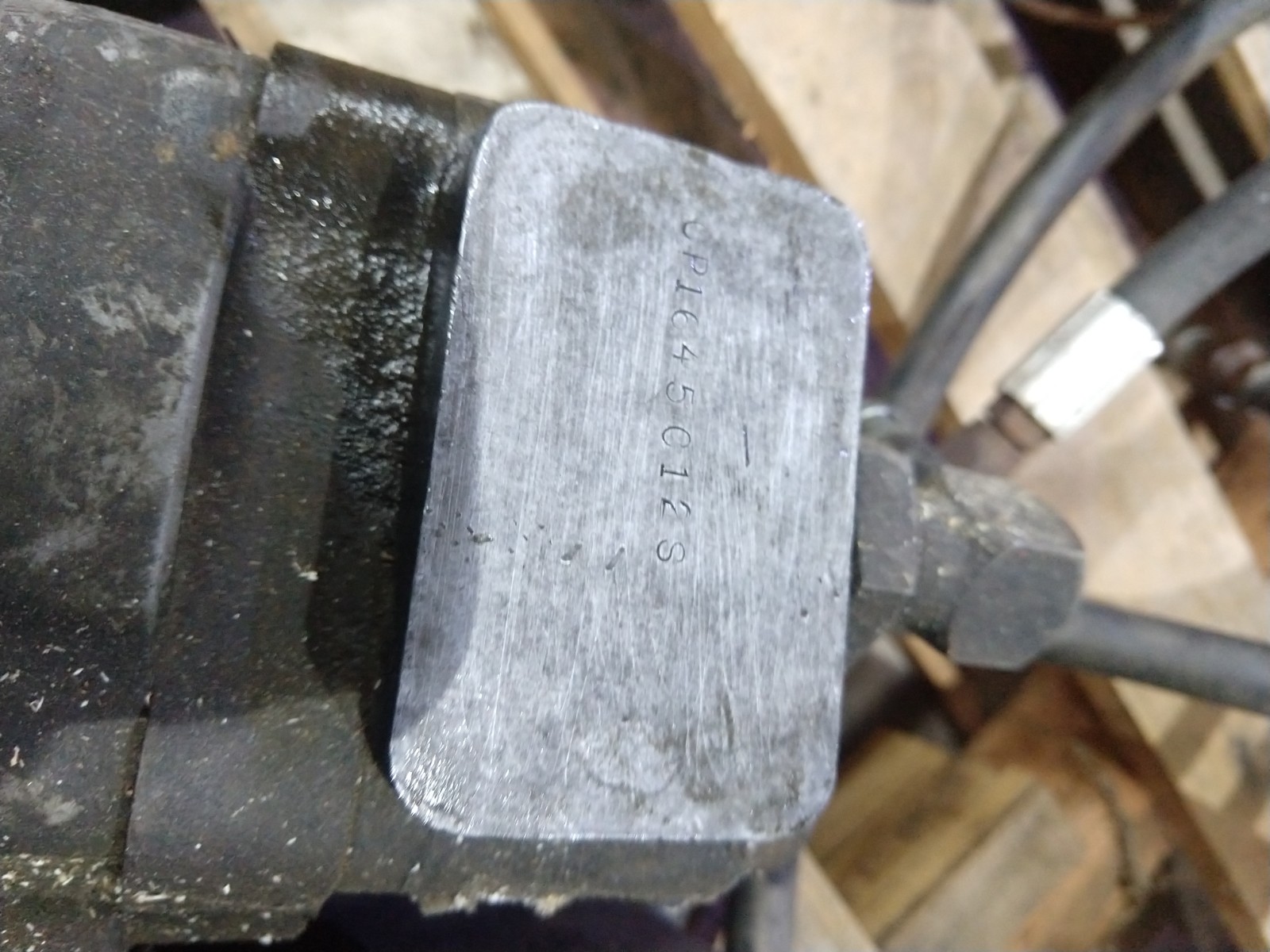

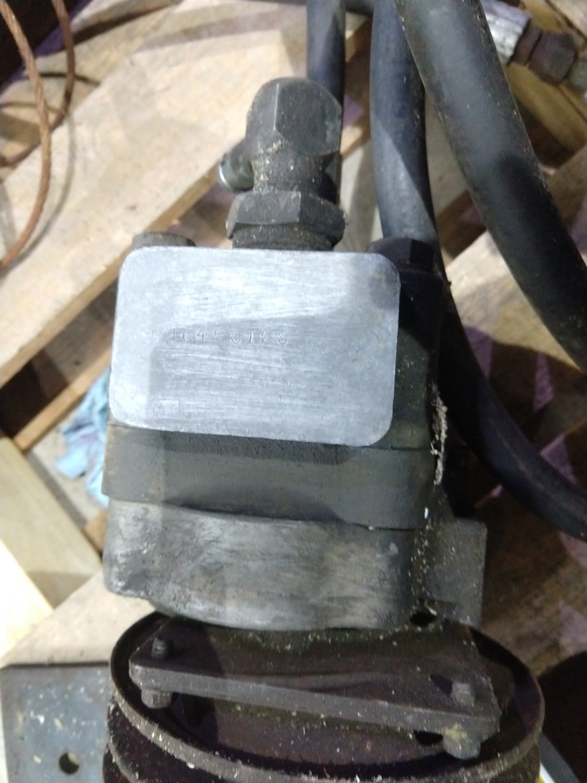

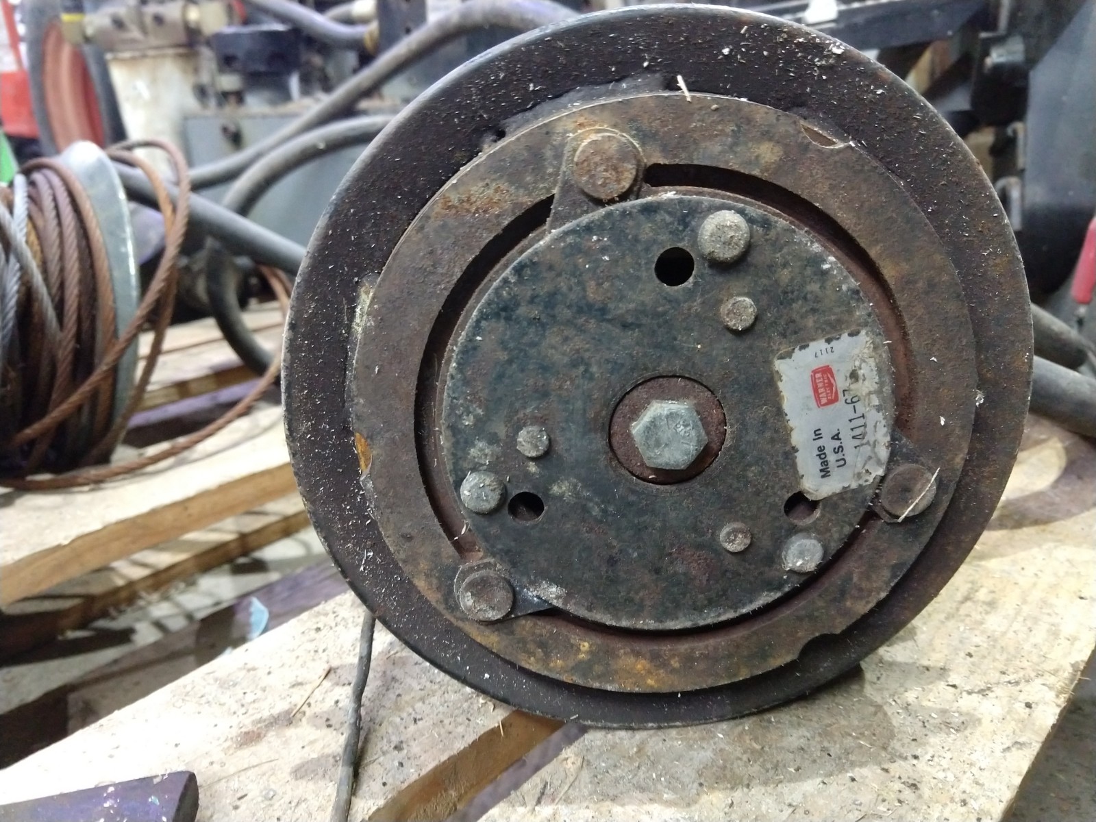

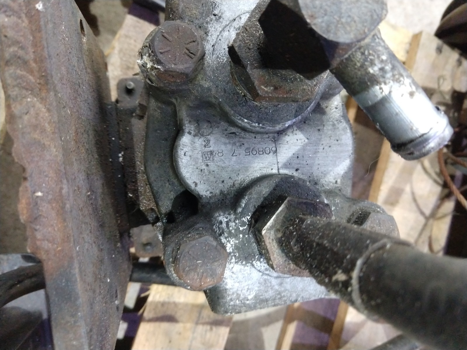

Have a hydraulic pump that I picked up this summer (came with a Truxcavator backhoe: https://www.tractorbynet.com/forums/build-yourself/427123-backhoe-3-point-trailer.html ), hoping to find out a little more about it.
Pictures:
IMG_20201228_212935829.jpg IMG_20201228_213043340.jpg IMG_20201228_213250544.jpg
IMG_20201228_213255918.jpg IMG_20201228_213303563.jpg IMG_20201228_213313919.jpg
The owners manual says not to run it over 1500RPM continuously, or 1700RPM intermittently.
Trying to figure out if that is due to RPM limits of the pump, or because they reduced the ports on the pump down to so much.
Anyone have any suggestions on where to look? Should be 1970s or 1980s vintage from the dates in the manual (was intended for a Ford pickup when they still ran V belts).
Thanks
Aaron Z

Cheap & dirty PTO pump for short run time applications like tow truck or winch truck. Dem pumps made 1 ton tow trucks lot cheaper comin from manufacturer. Not instant delivery when clutched in, different from snow plow pump. Mihght have electric clutch so not design for goin down road pumping.
First job you got is make sure it pumps and make pressure against restriction.
Don't pull ports till you sure pump don't have internal relief. Disassemble inside big plastic bag to maybe catch flying parts.
Pump like dat needs good size oil tank wid filter between tank & suction. Depending on work decent oil cooler before tank inlet good idea too.

.878 cid......max 3600 rpm
   / Belt driven Hydraulic Pump, manufacturer and specs needed.
Excellent, thanks for that information.
That will make the tolerances for pulley sizes easier.
Am I correct in thinking that if I want to run it at higher RPMs I will need larger hoses than the 1/2" ID suction and 3/8" pressure lines?
Thanks
Aaron Z
   / Belt driven Hydraulic Pump, manufacturer and specs needed. #8
Yes, you are correct

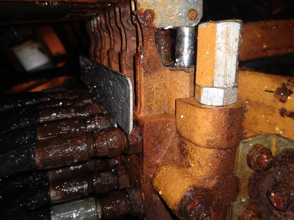

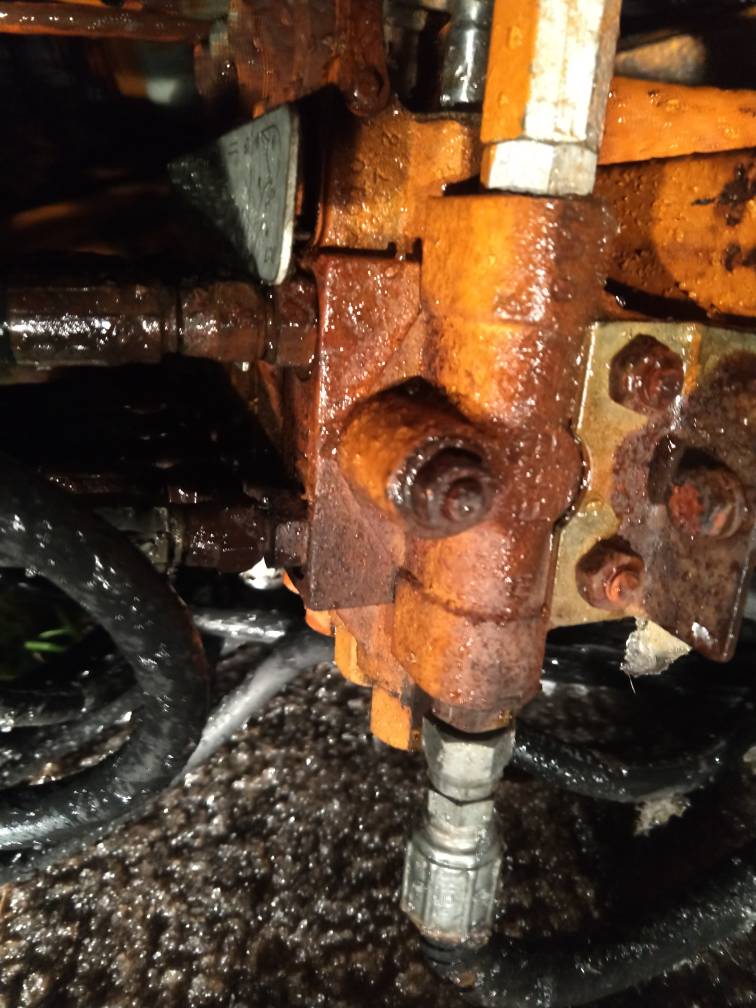

Looking at the control valve, should it be good for just the 6GPM listed in the manual, or could it go to 7 or 8GPM?
It has a 3/8 line feeding it and a 1/2 line going out to the filter:
