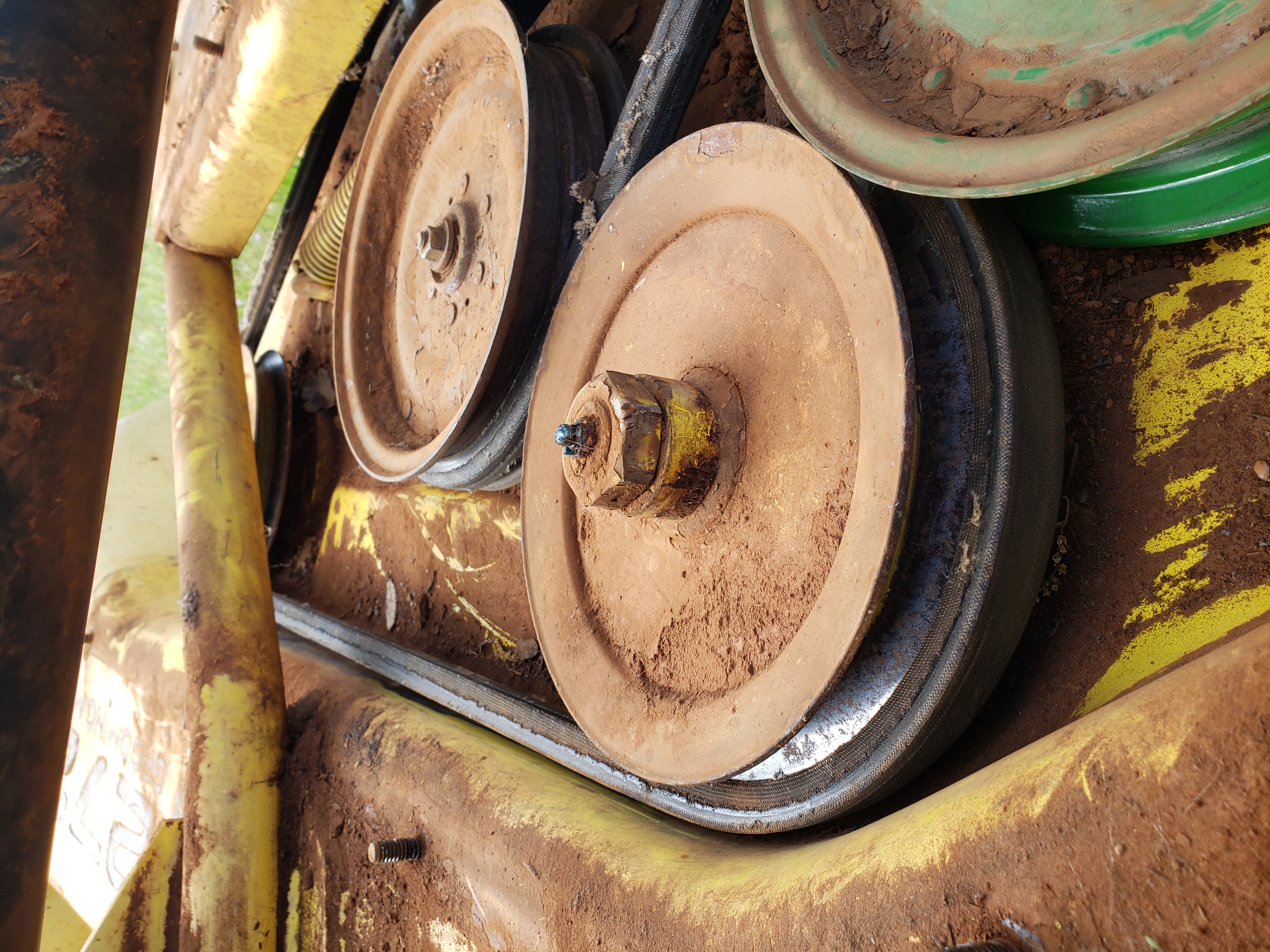

I use the 272 mower behind my JD 770 23hp tractor to cut down the weeds. But this year while cutting down the weeds I heard a noise and the mower was making more noise than it normally does I took off the belt cover see if I broke a belt but the belt is still in one piece but riding on the edge of the pulley instead of inside the grove of the pulley. What could be causing this? when I disconnect the mower from the PTO and spin the shaft by hand the belt falls back into the grove of the pulley but when hook back up to the tractor the belt immediately works its way back out to the edge of the pulley and of coarse does not turn the blade very well.

Two things I would consider.
1. New belt
2. Check the idler pulleys to insure bearings are good. Sometimes this will cause a belt to not ride properly on the drive pulleys.

I would lay where I could see the belt and pullies from the side and see if I could see a pully that is tilted. Would remove the belt totally and turn each pulley including the blades by hand to see if it turns freely and if there is any wiggle in it where it could tilt with load. Look for loose bolt holding the tension pulley arm to the deck.
   / Belt coming off Joh Deere 272 grooming mower #5
Bad bearings in idler pulley. It may not look bad, or feel bad when turned by hand, but at speed it is different..
Not enough tension on idler pulley.
Not a great belt, but not a wore out belt..
All this giving the idler pulley a chance to bounce just enough to release tension on the belt just enough to be a problem. On my mmm deck all it took was half a screen door spring to make the little extra tension to keep all working well... It worked well until the bearing finely went out on the idler pulley.. Replaced idler, all was well with out extra tension again..
   / Belt coming off Joh Deere 272 grooming mower #6
The surface of the pulley where the belt rides looks rough in the picture. Regardless of anything else, I'd want to clean it up if that's the case so it doesn't tear the belt up.
