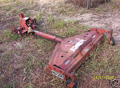

Continental-belton KTR60 should fit. I picked one up for my YM2000B but still need to get chains for it.
Bruce
   / Belly mower on a YM1700 options #3
Bruce, I've never seen something like that. I am guessing it attaches to the belly of the tractor but runs off the rear PTO? If so, that is an interesting idea for those who want belly mowers with no mid PTO.
   / Belly mower on a YM1700 options #4
Yup,
Runs off rear PTO, 3 pt. attachment, has chains to suspend from under tractor. This is not a photo of mine, this one is 48". Mine does not have the front wheels, and you can just back up onto it to mount instead of wrestleing it under the tractor. Yanmar sold these under their name as well, but they were Continental-Belton, made in Texas, parts still available. Len Shaffer is a good source of parts and info.

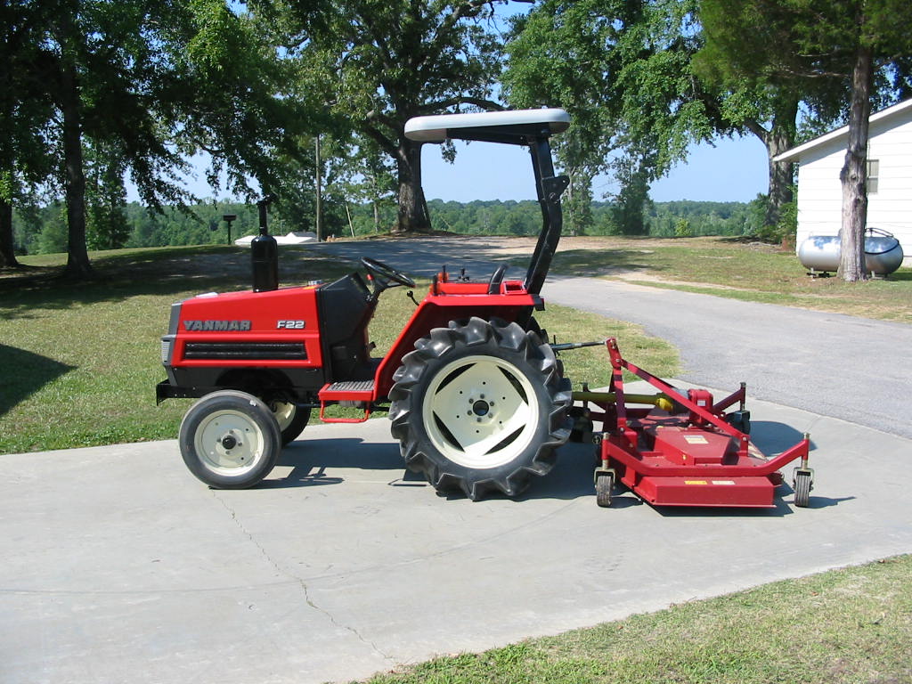

I have a Woods 60" under my F16d and it runs it just fine.
The continental looks interesting. My woods runs off of the rear PTO, but it mounts a big pully directly onto the PTO shaft. Not nearly as easy to remove as the continental.
The chains on my Woods are available at Tractor Supply, they are a generic chain (note, not a typical logging chain).

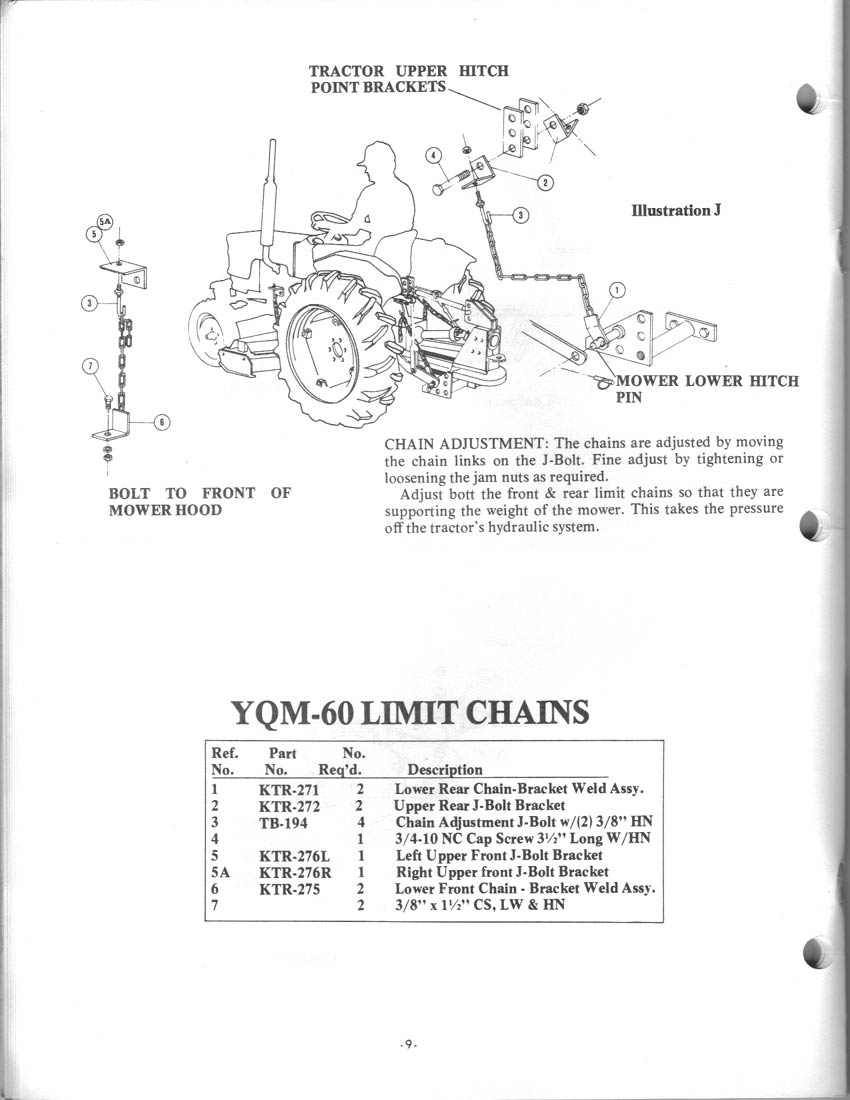

Chain set-up should be a fairly straight forward Fab, I have not checked to see if anyone has any available yet.
Bruce

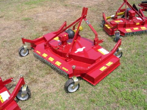

The Sitrex Mower works very well. I've used the Belly & RFM.
Danny
