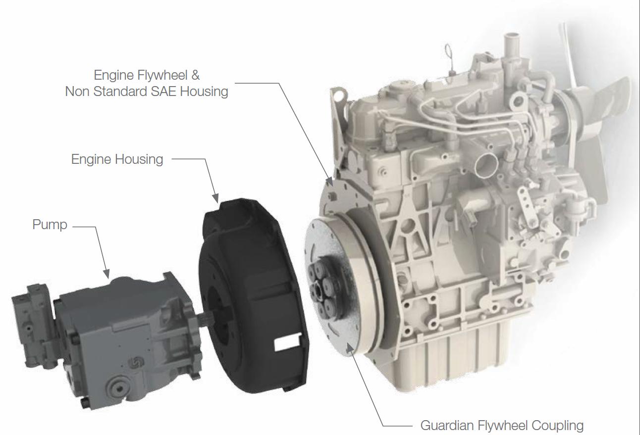

I got a swinger 220 loader that has a 4.154 perkins / mazda diesel that the head was tor off and sat for a while. the bottom end dont look to bad as it turns over freely. I would rather find another engine to swap in as this one is questionable. Anyway, I know the bell housing is a standard size, but what about the flywheel bolts? it has an adapter that has splines that connects to a hydrostatic pump. It bolts to the flywheel. if i can locate another engine my biggest problem is mating it to the pump. Would a kubota or yanmar work? Any suggestions?
   / Bell housing / flywheel question #2
I put a kubota in a 100. There' KubotaGuardianBellHousing.jpgs a flex plate for the flywheel that couple up to the pump
