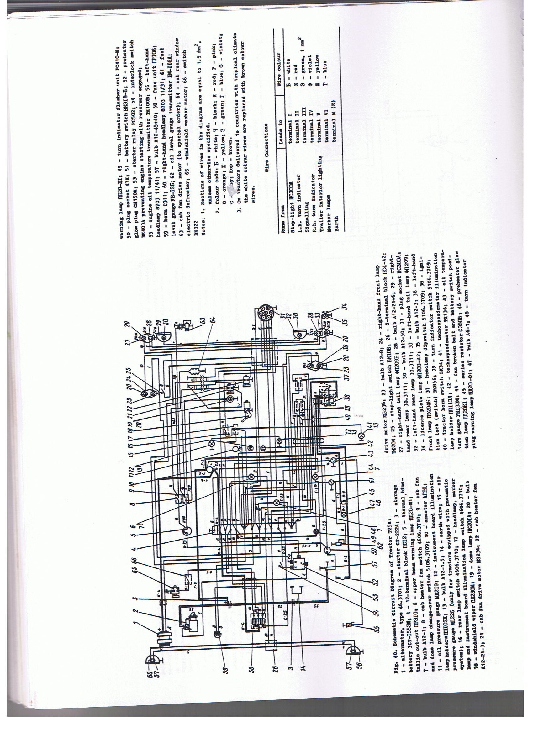

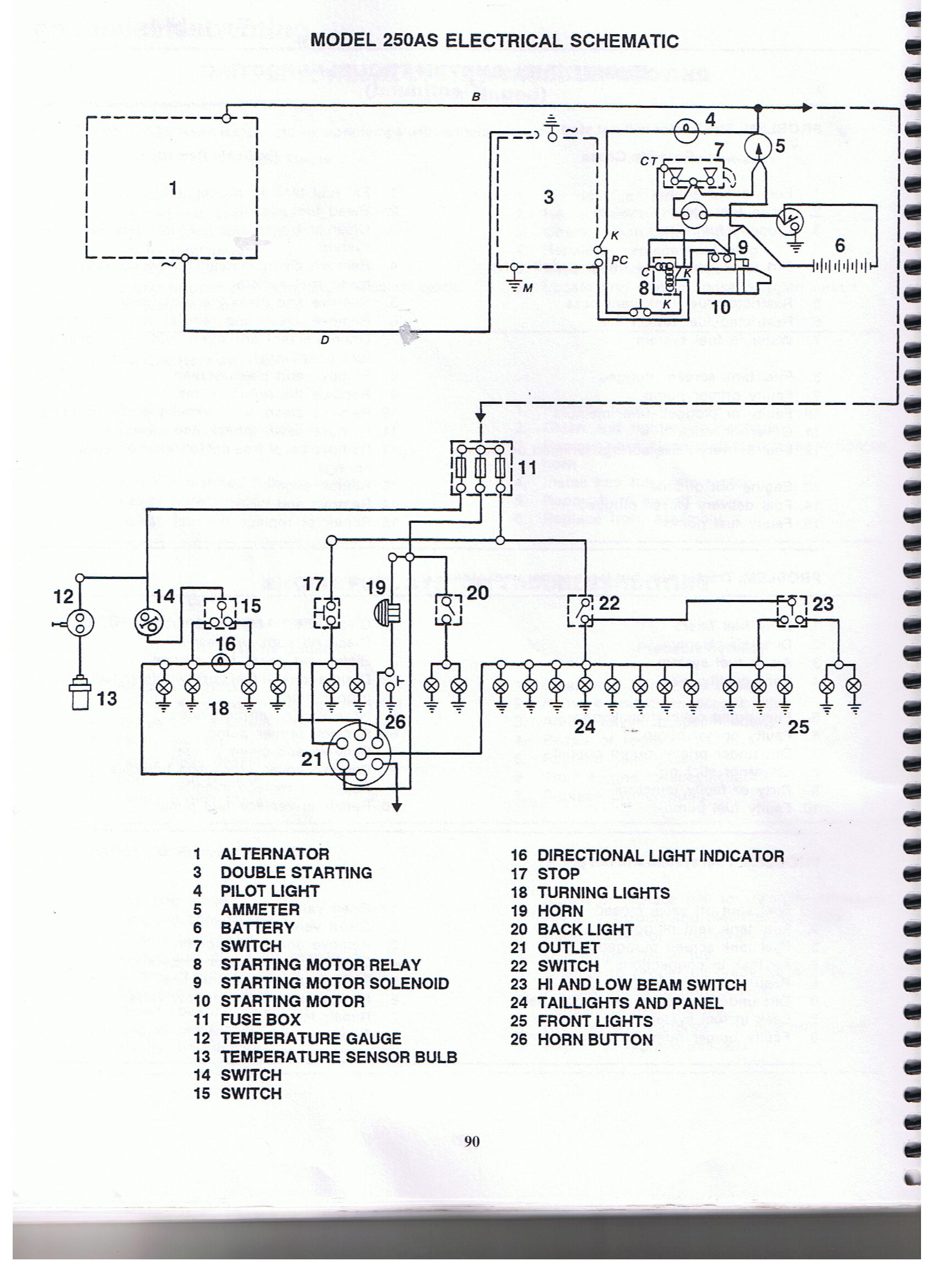

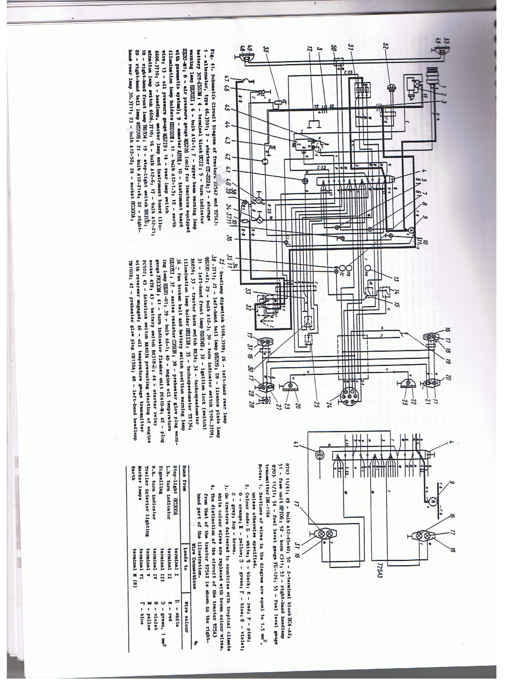

Does anyone have a copy of the wiring diagram for this tractor? I bought a manual that has every diagram but the one I need. I need to know which points on the 5 prong ignition switch to test for continuity to see if it is the cause of my problems.

Well there are a few, but the main one is i want to be able to start it with the key and not jumper the solenoid. It may be loose or corroded connections but i took the dash off and reworked all the connections to make sure they made good contact. I took the floor out and notice there is a switch on the gear shift box. I assume this is so you can稚 start it in gear? What should this guy measure normally open or closed when in neutral? Are they any more fail safes that would prevent the key from starting the tractor?
   / Belarus 250AS Wiring Diagram #4
I had the same issue. I just added a 60 amp starter button. I wired it to the 12 volt positive coming off the key switch to energize the button coil and ran the wire to the starter. Works great. Give me your email address and I will email the schematics to you. The diagram shows routing, but not individual switch specs.

Ok, I think I figured out how to attach the images.
