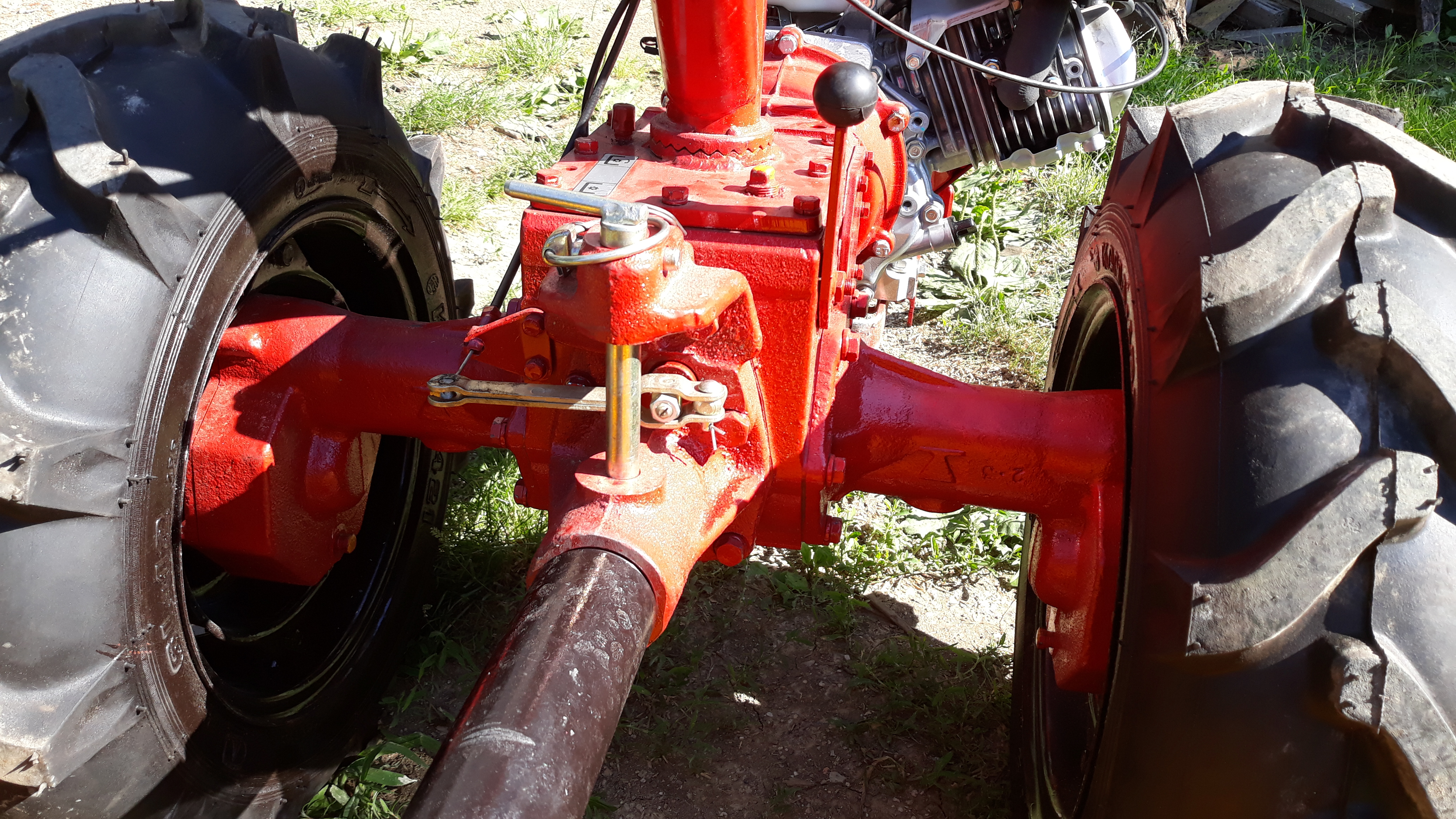

I managed to procure a new machine that is used in the far plains of the mother Russia and around in great numbers. Except for the engine it is the same as it was 40 years ago (or so I've been told), heavy, cast iron gearbox, loud, hard to shift gears, dangerous but indestructible and quite fun to use, like a tank one might say.

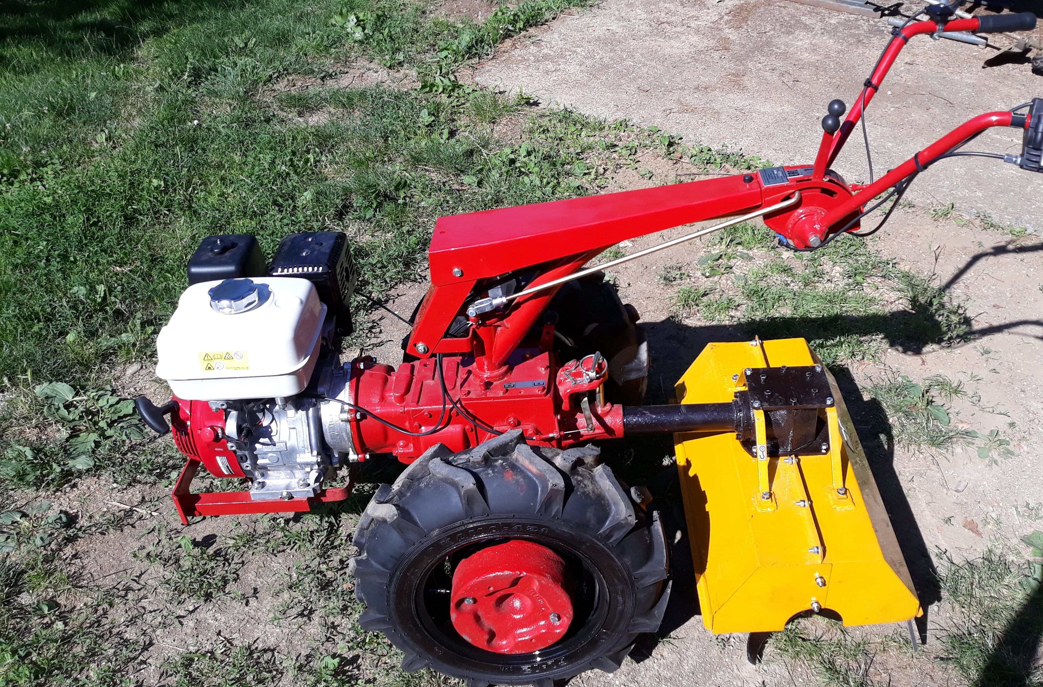

The tank in question is no other than Belarus 09h.
The 2 wheel tractor is coupled to a Honda gx270 engine, so no problems there either.
Interestingly the PTO is built around quick coupling in mind, the feature that is extra/optional on our west machines the same goes for the wheel weights.
On the other hand it has some really bizarre features to it. For example, it has no dipstick to check the oil level in the gearbox, it has a plug and if the oil leaks when you unscrew the plug the gearbox has enough oil in it.

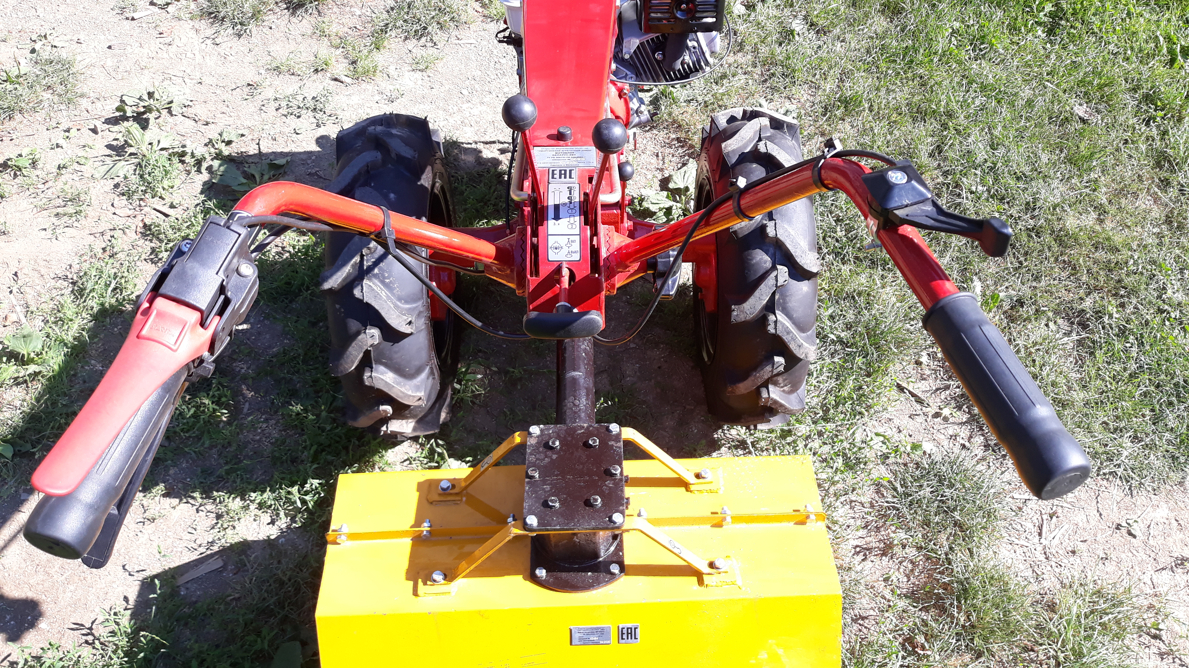

Indeed there are many implements for that machine, I managed to get only the rotary tiller and a plow for it. Even for just that the shipping and import fees were quite high.

Perhaps it is that I am not used to it being like that. It is actually not that stupid, you can't over fill the gearbox this way, which is especially important with wet clutch.
