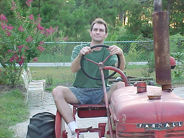

Thanks Chris. Coming off of a 1945 Farmall "B" (with no after market hydraulics or 3pt) anything is an upgrade! I did not mention that price is a concern, although I assume it is for most everyone. I tried for about 5 mins to price a bx, but could not find any $, I assume it'll be a little less than twice as much as a 1510d. As for the: ps - can do w/o, electronic ignition (?), gps - handheld, cd player - walkman, cup holder - I mount my own - big enough to hold a koozie!

You're right!!!...You do need a new(er) tractor.
   / Before I find/buy a 1510d... #7
Cool Farmall! /w3tcompact/icons/smile.gif I like to visit the local Kubota dealer from time to time because he gets in a good selection of used implements. When I ask him how it's going he usually says "nothing but tire kickers". Is he talking about me??? /w3tcompact/icons/wink.gif I haven't had the stuff to ask for a test drive of the new BXs yet but everybody here says they are great. I just think is is a good idea to know what the choices are even if you can't afford them.
