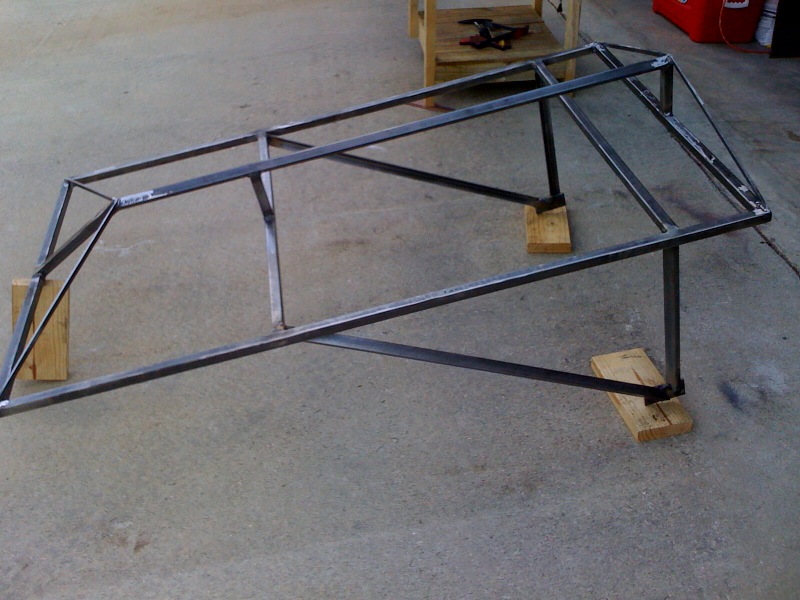

Remember right after I got my R4047, think it was day 1 or 2 of ownership and I spent the entire day on it. I got burnt up pretty bad... After that I knew I needed to do something about a canopy... Yup, you guessed it, I've been building my canopy. Beginner welder plus cheap source for steel plus inventive mind plus perfectionist makes for a verrry long project. So that's where I've been when not at work or asleep, in my garage welding.
I didn't want to spend the money to buy one. I looked at ones I could find online and thought they all looked simple and not very protective in the fops sense. So I designed and built my own from scratch. Hopefully my measurements were good. It's almost finished, just a few more pieces of sheet steel to weld on then grind, clean and prep for paint. I picked up a paint that looked like LS blue but I won't know till I get it up there if it's a match. I'm going to post all the pictures in the build it yourself forum after I get to a point where I don't need to spend all my time in the garage. So probably after it's finished. I'm at work right now but I'll post a pic to piqué your interest after I get home. So much to say but I can only stand so much typing on my iphone

Here is that teaser picture that I promised. I'll post everything in build-it-yourself as soon as I get a chance and post a link to it here.

Your design looks impressive thus far.

Thanks. I tried to design it for some impact resistance... running into branches or branches falling down on it. With the ridge and slope it ought to offer better protection and deflection as opposed to all the flat top canopies out there. It sure makes it more complicated to build though...

I promise to post the pictures and the project soon. I'm getting so close to finished... For some stupid reason I thought I'd try to make it look professional to the point of using spot/glazing putty to even out the welds and grinds before the final paint coats.
And here is a tip for those of you like me who try to make due with what's at hand... Do not try to glaze or fill welds with epoxy. It doesn't work and it doesn't sand. It cost me an extra few hours of work taking off the epoxy and redoing the primer.
Spot and glazing putty can be found at auto parts stores (and maybe walmart I've heard) but oddly it is not at hardware stores. Go figure
So I figure another half day of prep if if laid the putty well enough and then maybe a day or two to get the final paint and little parts done. After that I'm going to post the project
