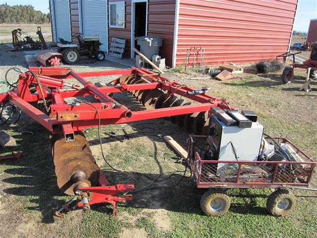

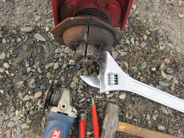

The retention nut on a disc axle sometimes is a bear to remove. Recently I cut down a 13-ft wheel disc to 8-ft wide so I could handle it with my Mahindra 5525. I had to cut the axle nut with my 4-1/2" angle grinder to get that sucker off.
Once you get that nut off, the rest of the job is pretty easy.
Good luck.
