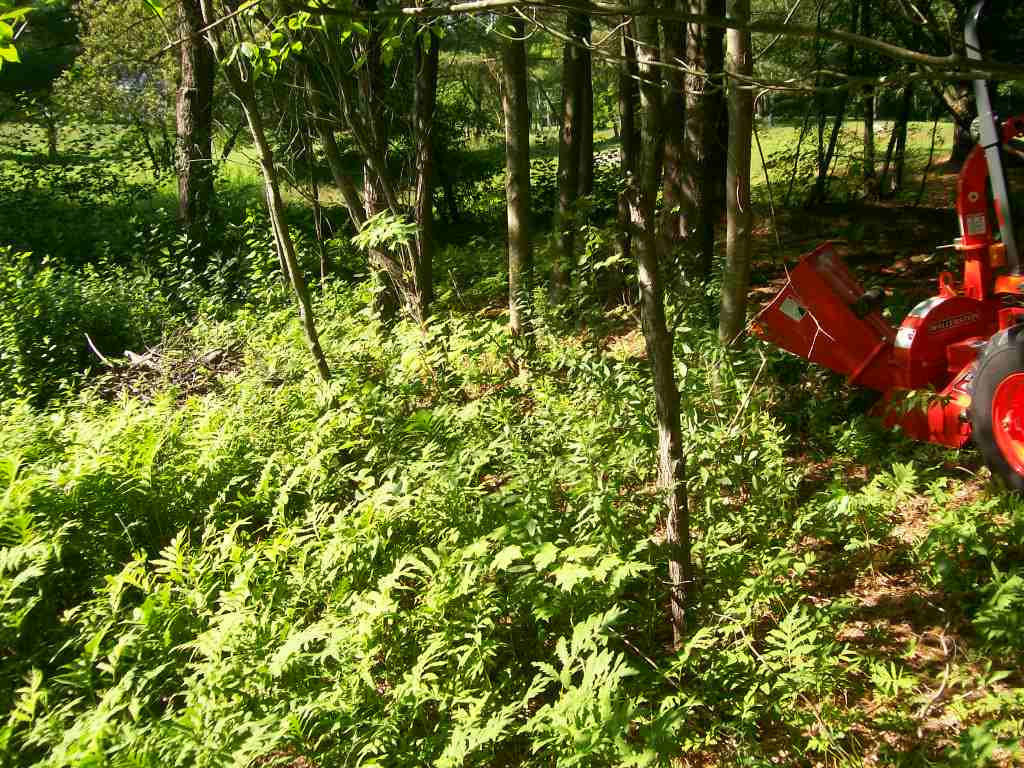

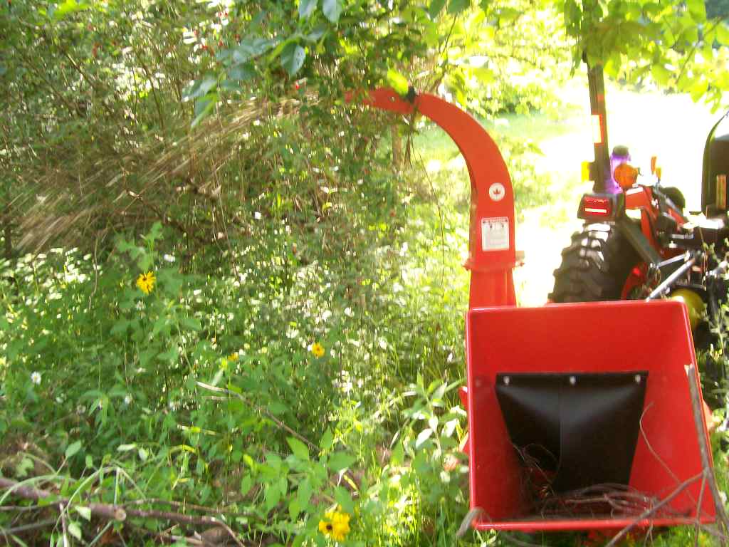

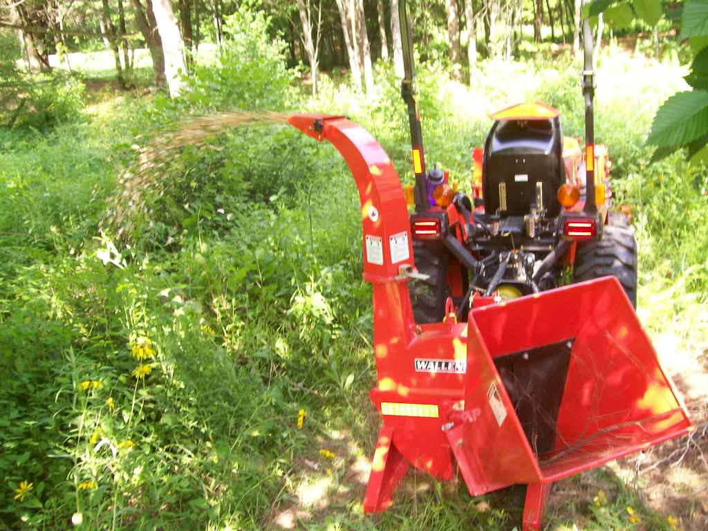

I have the Wallenstein BX42, and power it with my B2620. At first I had some problems with it plugging when fed very limber small branches, or small limbs that were mostly leaves. I first solved the problem by running it at the 960 pto setting, and then another member here suggested that I should check the factory knife clearance setting. When I did I found the clearance to be much more than the manual suggested so I readjusted it. Now I see no real need to buy the shredder option. ( I have fed armloads of weeds through mine with no problems) Do you have to help the feed a bit with wildly branching limbs like some apple trees, yes, but the wider opening makes it possible, and it still beats the alternatives both price, and storage wise. I've gotten a lot of use from mine, and like it a lot. It will feed most moderately branched limbs with no assistance. I'm cleaning up some small things in the pictures, but they were long enough to enable me to stick them in the chipper, get out my camera, and take the pictures while they were feeding themselves as you can see by the chips coming out of the chute.
