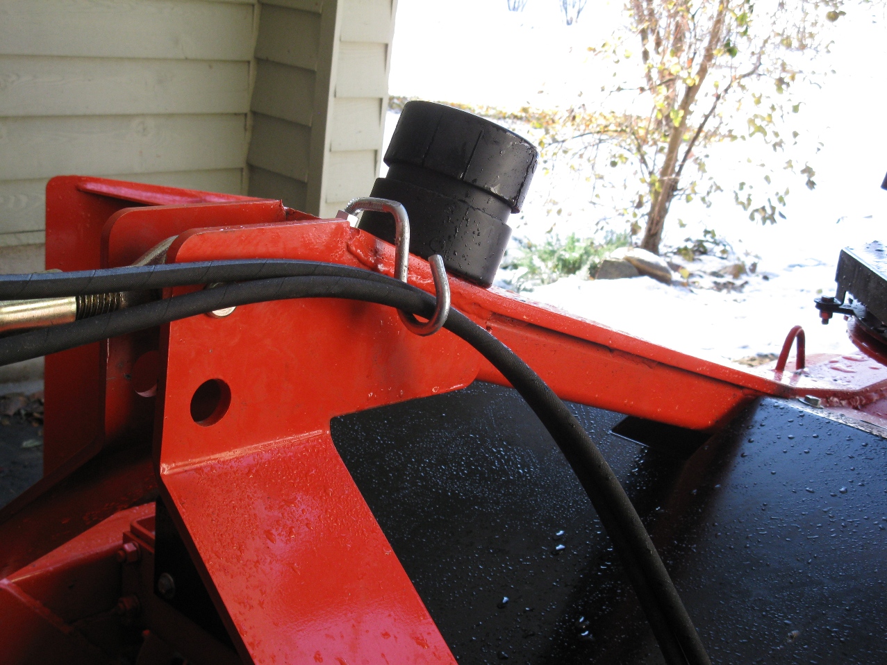

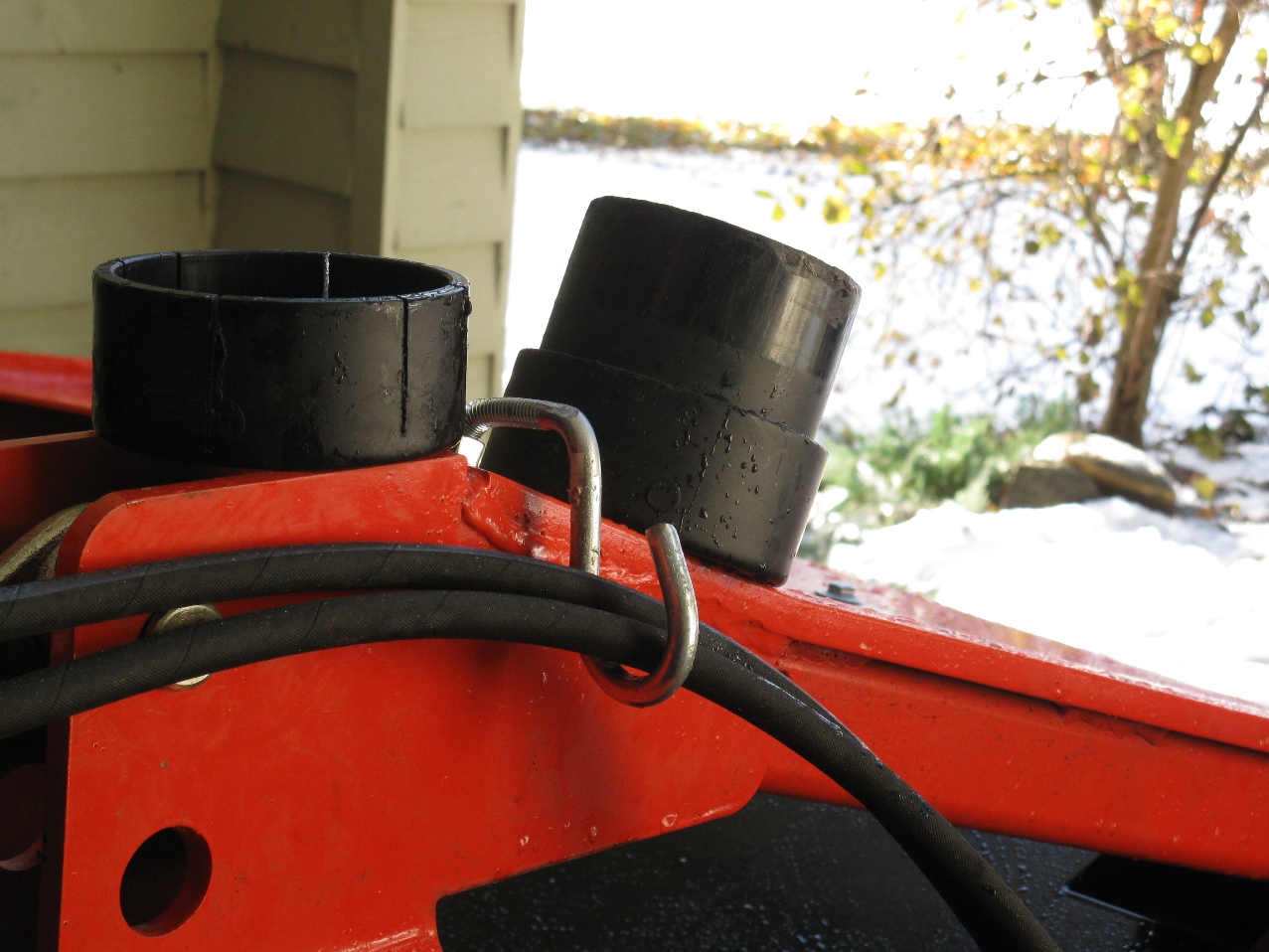

I was wondering if you were able to locate the grade and size from the manufacturer or the drawings.
I thought the PTO shear bolt would have been a metric gr. 8.8, 6mm x 40mm and the one for the shaft driving the auger chain is likely an SAE grade 2, 1/4". I had a heck of a time locating grade 2 1/4" bolts here but finally found one ag equipment dealer that had some. But previous to that I bought some 1/4" carriage bolts which are grade 2.
I used plastic pipe and caps to make a shear pin holder that stays on the blower:

Nice, I won't get so fancy and just toss some spares under e seat. The drawings and parts list in the manual confirmed the grade and size, and I found the 6x40mm gr 8.8 no problem but the 1/4"x1" weren't as obvious. I chose a "lower strength" as listed by McMaster Carr which they claimed to be similar to Gr 2. Hope it all works out.
