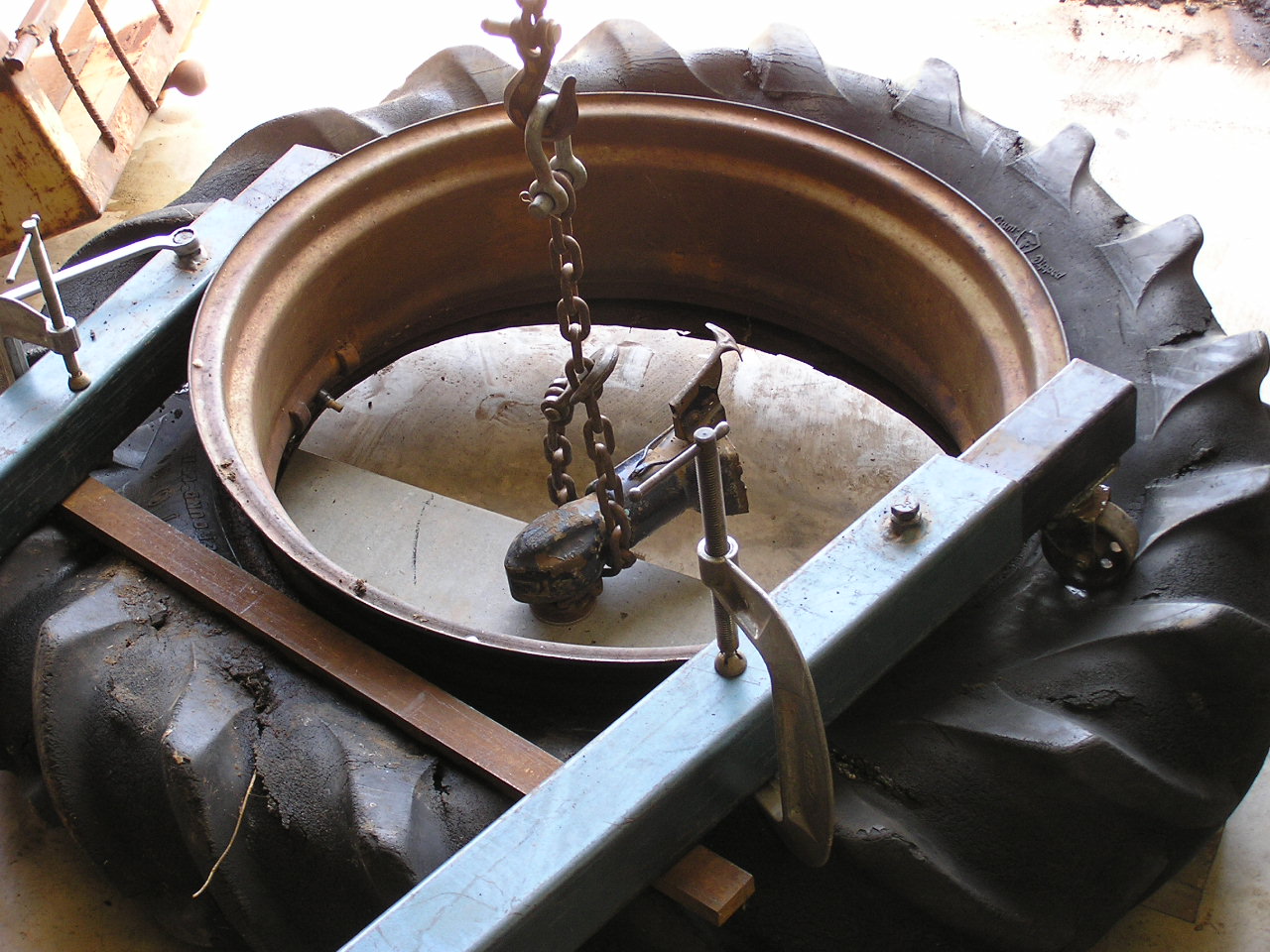

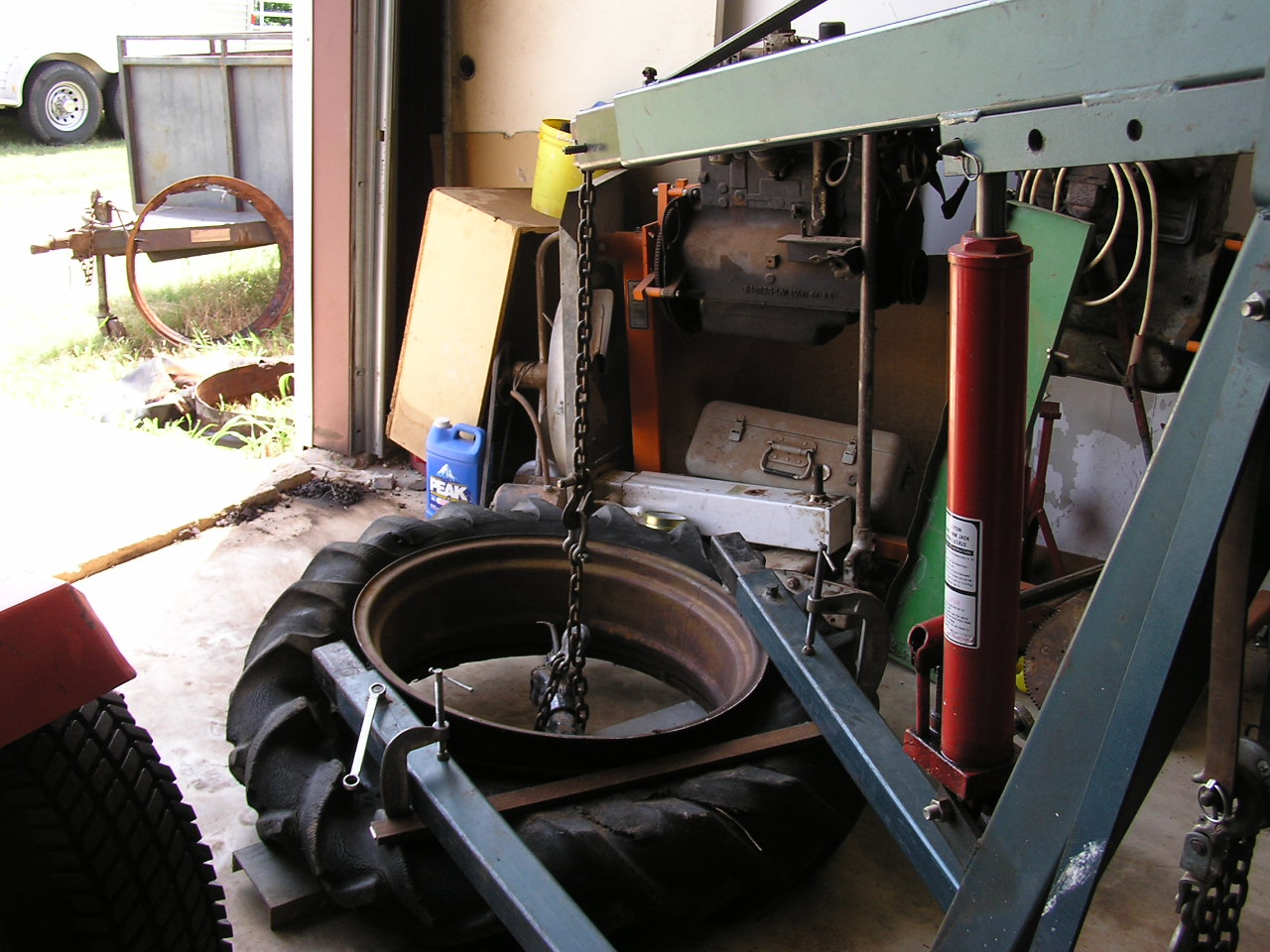

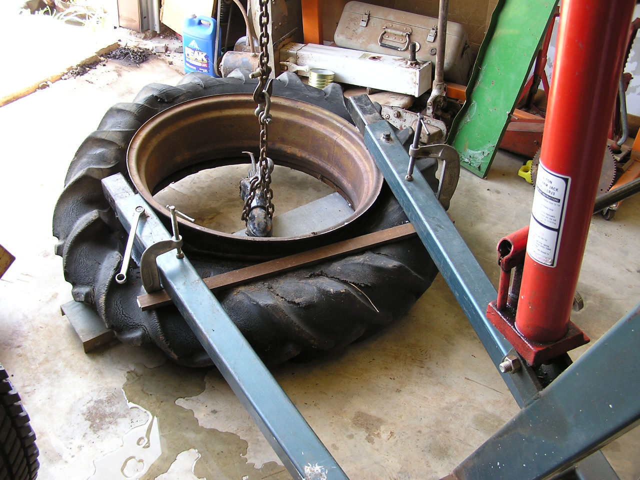

I used my shop crane, didn't think about pictures before I started, or I would have moved it out in the sunlight.
The castors and a steel bar pushed down on the tire.
View attachment 380324 View attachment 380325 View attachment 380326
*big thumbs up* and already have the shop crane / cherry picker, beside tractor. to deal with mounting the other wheel
just like the floor jack video, but without all the extra lumber.
will try cherry picker later on tonight!
